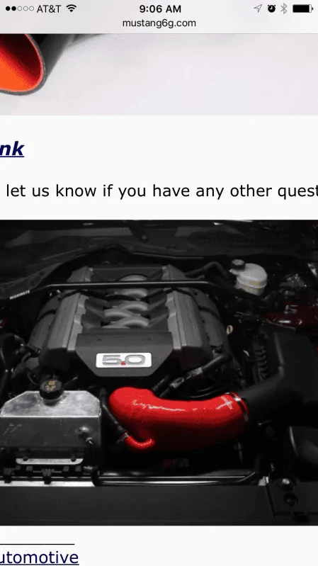

Man too true. No engine cover, stock coolant reservoir, and that fugly PMAS...
I'll be running that exact setup as soon as I get my GT350 intake manifold. Looks under my hood be damned I want my car to be fast even if it won't win a best in show for engine bay looks lol.
Don't be so defensive. :lol: There are a lot of pictures of the PMAS floating around, and a lot of people have never even seen the Mishimoto intake, so of course the PMAS is going to receive more negative commentary on its appearance. It's a good-performing intake that just happens to lack aesthetic appeal.I love how people are talking about how ugly the Pmas intake is and yet I haven't seen anyone call Mishimoto's silicone intake tube ugly. It looks like a alien stomach and yet it seems like a ton of people want it.
