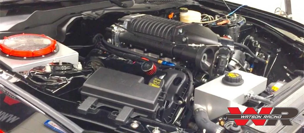

Since the Mustang plans to be mainly a drag vehicle, Kim Mapes of Watson Racing swapped out the factory PCM and electronics for a F.A.S.T system. So don't be worried bout the lack of the MAF housing and big filter, the F.A.S.T. is a speed density based system which only needs a MAP sensor in the manifold.

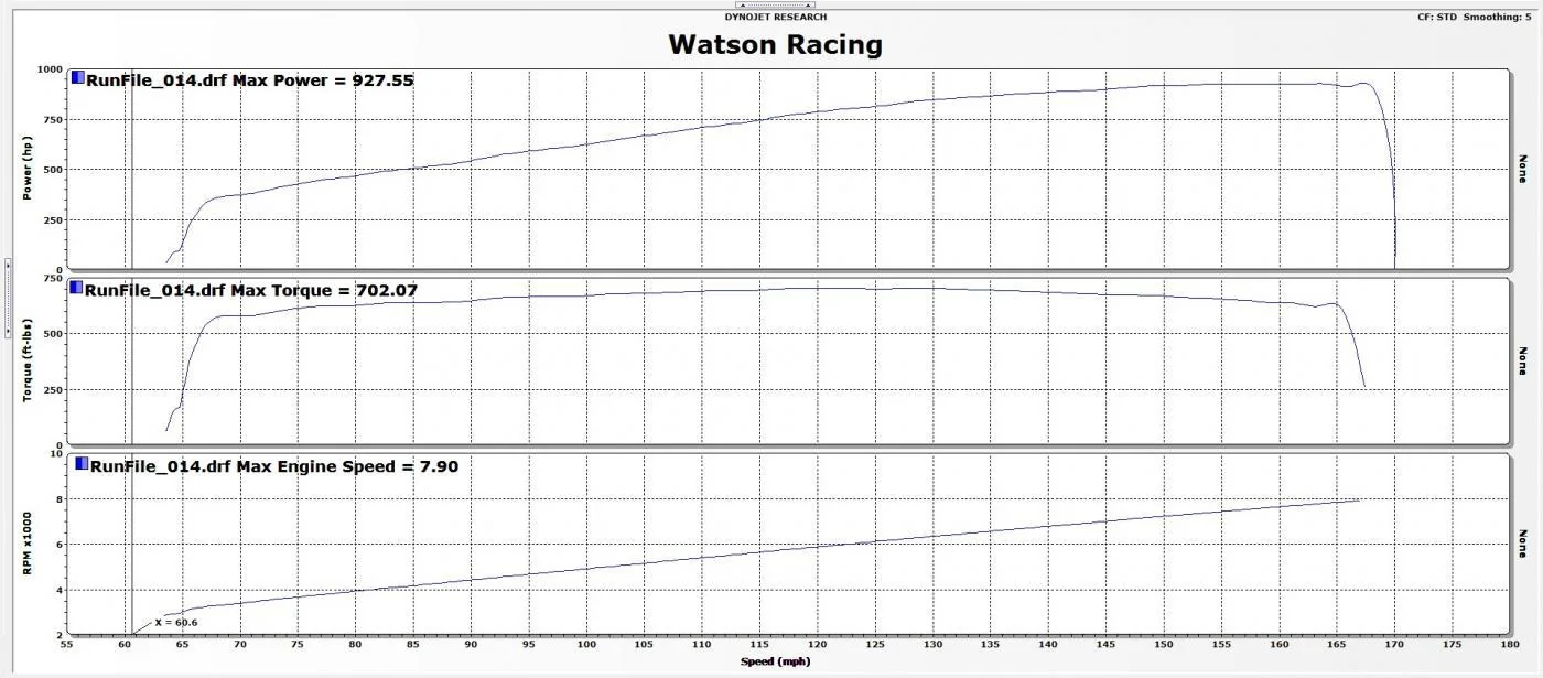

With the new Whipple 2.9L front feed supercharger, massive 132mm throttle body and ridiculously big intercooler system, the Mustang ripped off 928rwhp and 702 rwtrq using drag radials. Kim felt this was still a conservative tune, while also using a 6-rib belt system. Next up was Whipple's 10-rib upgrade kit with ATI balancer and some updated tuning and some test passes to get this monster dialed in.
