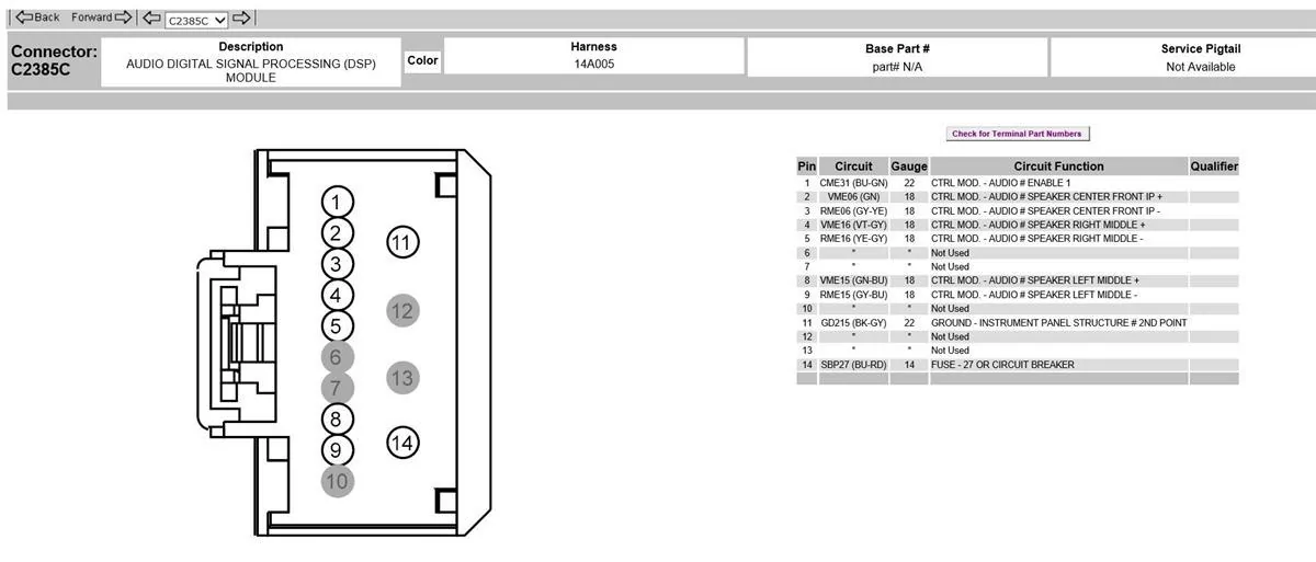

Quote:
Originally Posted by DAZZA View Post
Hi Mumbles this looks like the perfect diagram for aftermarket equipment.
Would you happen to know what connector and pins are for the power feed to the factory amplifier in the diagram? I am thinking it can be used with a relay to create a 12V remote sensing wire or additionally use this 12V for the processor that can be mounted in place of the factory amplifier which can be taken out of the car completely.
I take it that one of these connectors carries the Power to the factory amplifier?
The audio enable signal is on pin #1 of the brown C2385B plug. That signal is only +6v, but as long as you use a relay that will accept a voltage of less than +10 - 12 v, you should be fine. I personally use a PAC TR-7 module.

Quote:
Hi Mumbles, thanks I noted that in the forum. I was looking for the actually 12V supply that powers the Factory Amplifier, this will be good to add to your diagram with the pin outs. My reasoning is that one can build a box with a breadboard and mount all the connectors, RCA but also mount a relay in this box, so the 6V triggers the relay which feeds the 12V that was originally used to power the factory amplifier (fed off the connectors) to create a 12V remote sensing wire.
I was thinking of also connecting up my crossovers in this box to the existing speaker wiring looms.
Once this box is built you simply unplug the entire factory amplifier and plug this box in and it connects the entire system up including the speakers.
Simply mount the box in place of the factory Amplifier, no cutting any wires at all. One can return the system to stock if need be at any time.
In previous thread it was noted that the Blue with red stripe is the 12V power to the factory amplifier.

Name:  mustang amp plug3 (Custom).jpg
Pin #1 is 6 volt turn-on
Pin #11 is Ground
Pin #14 is 12volt fused.
Wire the PAC TR-4 input to the pin #1,and you now have a 12 volt out.
Doing it this way the system retains all of the factory switching.

Quote:
Originally Posted by Racemaster View Post
Attachment 143847
Pin #11 is Ground
Thanks this has confirmed everything for me!
