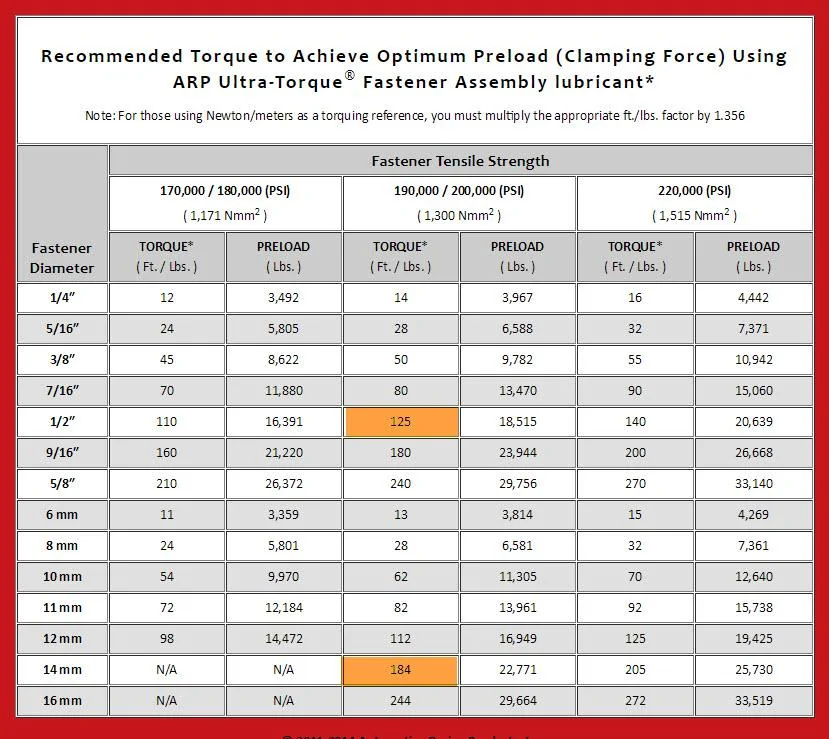

Yes good point. A lot of assumptions ATM.Depends if you are installing the 1/2" or 14mm ARP studs. I would not torque the 1/2" studs to 148 - big difference that needs to be clarified.
Per the same chart 125 is the max on a 1/2" so if you cut that by 10% 105 is a safe number
