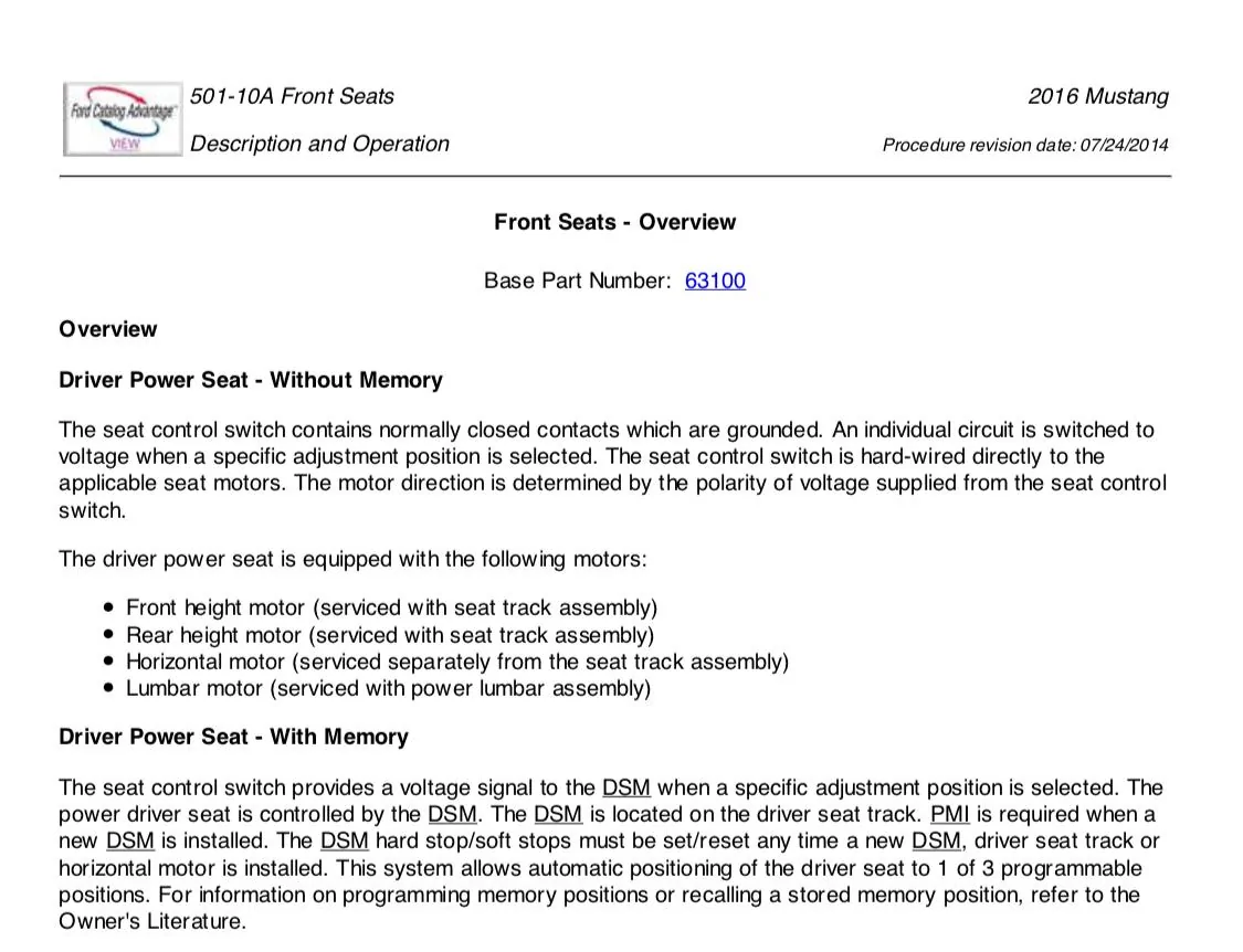

PMI is Ford speak for programmable module installation, typically done with a Ford IDS/RDS scan tool, higher end after market scan tool and I believe Forscan has the ability to do it. Essentially it means the tool takes the essential info (as built data) from the old module before you disconnect it, the new component is then installed and you flash that data into it.Buzz-dee, you are the man. Thank you for helping thus far. I'd really like to find out what PMI is referencing in the document you posted. It sounds like some kind of calibration.
Thank you for posting this.Here is the first part about the seats. Unfortunately I cannot get the diagrams for the seats as a unit. I'll have to look it up by subsystems.
The first pdf covers the seat movement wiring with and w/o memory. What else do you need? Airbags? heated/cooled seats wiring? what part of the BCM wiring were you referring to?
View attachment powered and memory seats.pdf
