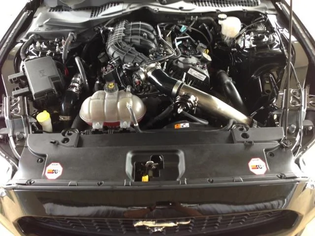

First off, I have my own build thread under "Twin Turbo V6 Project" if you would like to read a more detailed process of R&D and installation, but it has not been updated in quite some time. Anyways, I decided to boost my car while on a tight budget. This is when I contacted Tom at Super Six Motorsports and got the idea to use the EcoBoost twin turbos off the 3.5 F150.
My car made 330whp/350wtq on 93 pump gas and 410whp/470wtq on E85. The car is a blast to drive and that torque hits hard at 4000 RPM!
My car has now officially been boosted for a little more than a year. For an entire year, it remained my only car (I now have a 2001 Jeep Grand Cherokee as a daily) so my Mustang was my only car and I drove it every day. I have probably put somewhere around 15,000 boosted miles on my build. This setup is reliable. The only "issue" I have had was when I drove down to TX2K17 and burned my stock fuel pump using the VMP booster while racing.
Here is a list of all of the parts installed on my car as of 03/27/2018:
2012 F-150 EcoBoost Turbo's
2012 F-150 EcoBoost exhaust manifolds
DeatschWerks 65lb/hr fuel injectors
VMP 40Amp Fuel Pump booster
Hayden Oil Cooler
NGK 6510 Iridium Spark Plugs
Turbosmart eBoost Street electronic boost controller
Turbosmart Race Port Blow Off Valve
Turbosmart 4-port boost solenoid
2-Bar MAP Sensor
CX Racing Twin turbo Intercooler
SSM twin turbo adapter kit
Catless down pipes
Custom/stock EcoBoost air induction system
MPT Pump gas/E85 FI Tune
19x10" rear/ 19x9" GT PP wheels
Goodyear Eagle F1 285 rear/255 front tires
Custom TTr oil catch can
Custom 3" catback exhaust with x-pipe
Mods I plan on having in the future include 305/35 Nitto NT05R's and I have been tossing around the idea of swapping to a procharged setup because I prefer the horsepower setup opposed to my torque setup. So I will probably be in the market to buy/sell car parts in the future. Although, I am currently studying abroad with my school in Italy until August 1, so it will have to wait until then. I will work on getting some pictures uploaded shortly.
