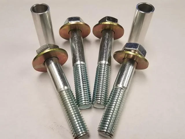

I have a stock bushing specific kit.
You have to call to order it.
(2) RM1634 sleeves
(2) HW487 90mm Bolts
(2) HW046 80mm Bolts
(4) HW014 Washers
This kit places more shank into the front bushings than the stock and fills the void in the rear bushings. The front and rear bolts are a grade 10.9 zinc plated design with a shank that is approximately 1.23mm larger in OD than the OE fasteners.
Cost is a touch under $40 shipped within the 48.:thumbsup:

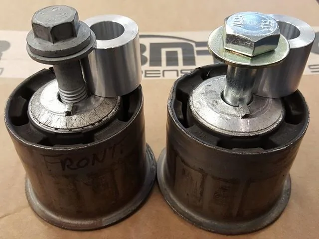

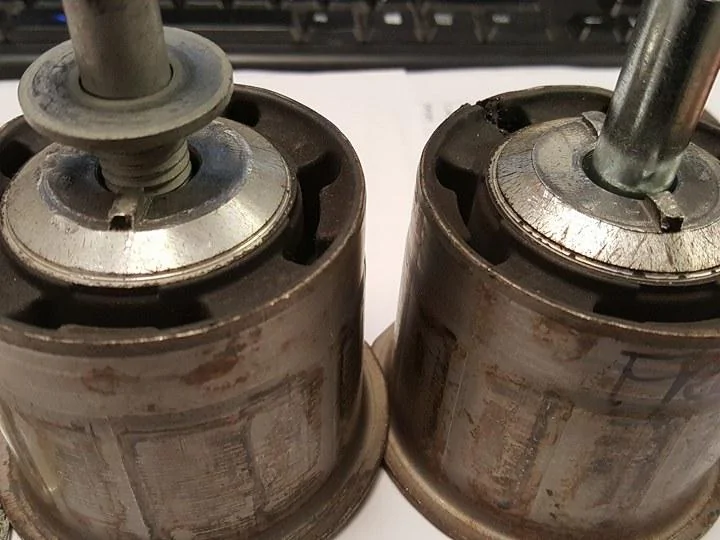

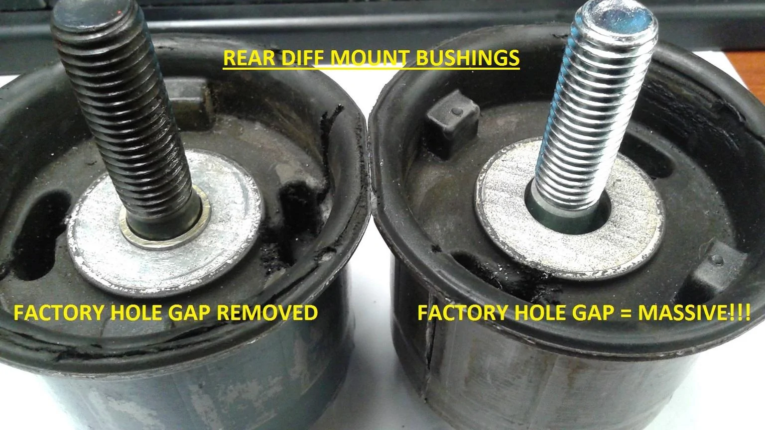

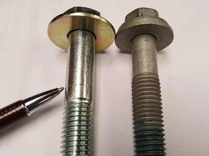

A few people called to order an upgrade kit for the stock bushings, so figured I would show them as the "kit" listed in post #138 above.
These pieces add strength in a few ways.
1: They are the same 10.9 Grade as the OE fasteners, but they feature shanks that are over 1mm larger in diameter.
2: The front bolt shanks actually protrude into the inner bushing sleeve, where the stock bolts stop well short. This does a few things - it places the shear path on the shank, and it also helps to retain the pinion mounting and location IF the bolt snaps on the threads which are tucked deep within the bushing. It does not allow the threaded portion of the fastener to continually bend and deflect. I have had about 25 people install these front bolts with zero issues to date.
3: The rear bolt is essentially a duplicate of the factory piece, except the mass of the bolt and diameter of the shank is larger. However, it is impossible to place the shear path on the shank without drilling through the differential cover. This kit includes the bolts, but ALSO the CNC machined insert sleeves to center and lock the mating of the differential and the subframe. By doing this, it helps prevent the bolt from deflecting excessively as well as helps keep the bolt from seeing damaging shock loads when it is "floating" within the stock bushing.
