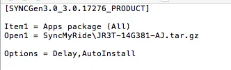

steve is there anyway you can confirm if this leaked version has the complete voice command related files as the ones shipping to dealers?17276 is what you'll see popping up on dealer lots shortly, if not there already. A few vehicle lines are shipping now.
I feel better about it thanksAppears so. It has (last I checked) the -CD voice package. If you're running the 17194 nav build that was floating around, you're using an older -CC package where some things won't work as expected.

I had a similar experience, except I used a new USB drive that was empty, and I turned Bluetooth and Wifi off.Same here.
Everything seems 100%.
- I used a 4GB drive, did not reformat it, and removed some files to leave me about 2.5GB.
- Put the launcher file and tar folder at the root level. Then plugged it into the dash USB port during a long drive. Within 15-20 minutes it completed.
- Restarted the car during a stop sign (opening the door to get it to shut off right away). Then the display kept thinking it was nighttime, so I turned on, then off, my headlights to sort that out. Weird.
- Nav maps kept saying loading. So I cycled the car again at another stop and then everything worked normally again.
- Then I went through the Android auto steps (requiring yet another stop).
