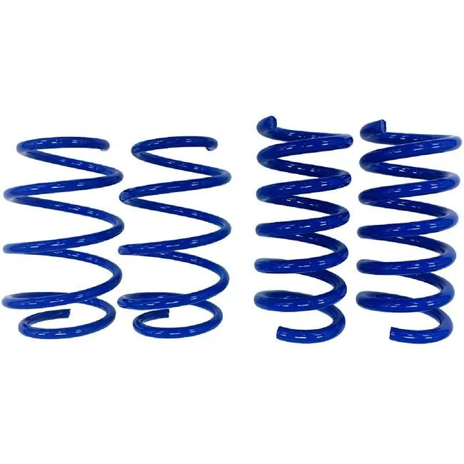

I'd recommend at least the PP shocks and struts for these rates. It may feel a bit springy/bouncy and underdamped on non-PP stuff.I know it's not ideal, but as BmacIL alluded to, is it OK to use the stock (non-PP) shocks with these?
They will work great for a Eco-Boost. To give an even drop with minimal rake use the Steeda 1/8 rear spring spacer.Will these work fine with the EcoBoost? Or will the front of the car sit higher? Any pictures?

With the increased rate of our minimum drop spring and 1/8 inch spring spacer it would work just fine.Hi Tim
Since the vert is 200 lbs? pounds heavier in the back than the normal S550, do you have a different set of springs for them? I have been told the PP as a different spring rate for the verts.

We will have a specific designed spring for the Magnaride. They should be available in about 6 weeks.Can these work with Magnaride?
