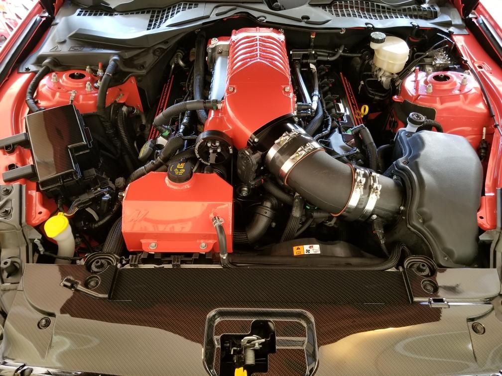

The radiator extensions arrived but missing the two large pins. American muscle is shipping them out today.
Looking good buddy. But you need a master cylinder cover to cover that translucent one. I bought a CPC cover from CJPP. It works nicely with the rad overflow cover.

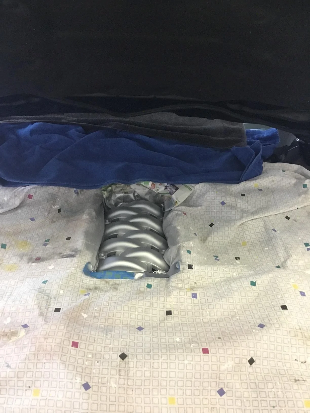

How did you black out the washer fluid hose? Very subtle but huge when you notice it.
Sorry Ruby....just noticed this now! Anyway...I have old sheets I use for drop sheets in painting. I cut a hole in one, slipped it over the neck of the fluid bottle and spread out the sheet over the rest of engine and fenders! I uses a spray can of Plastic Dip... a few light coats as far sound as I could get! I did the same thing when I painted the intake runners Krylon Dull Aluminum. Just thought I’d add a pic.

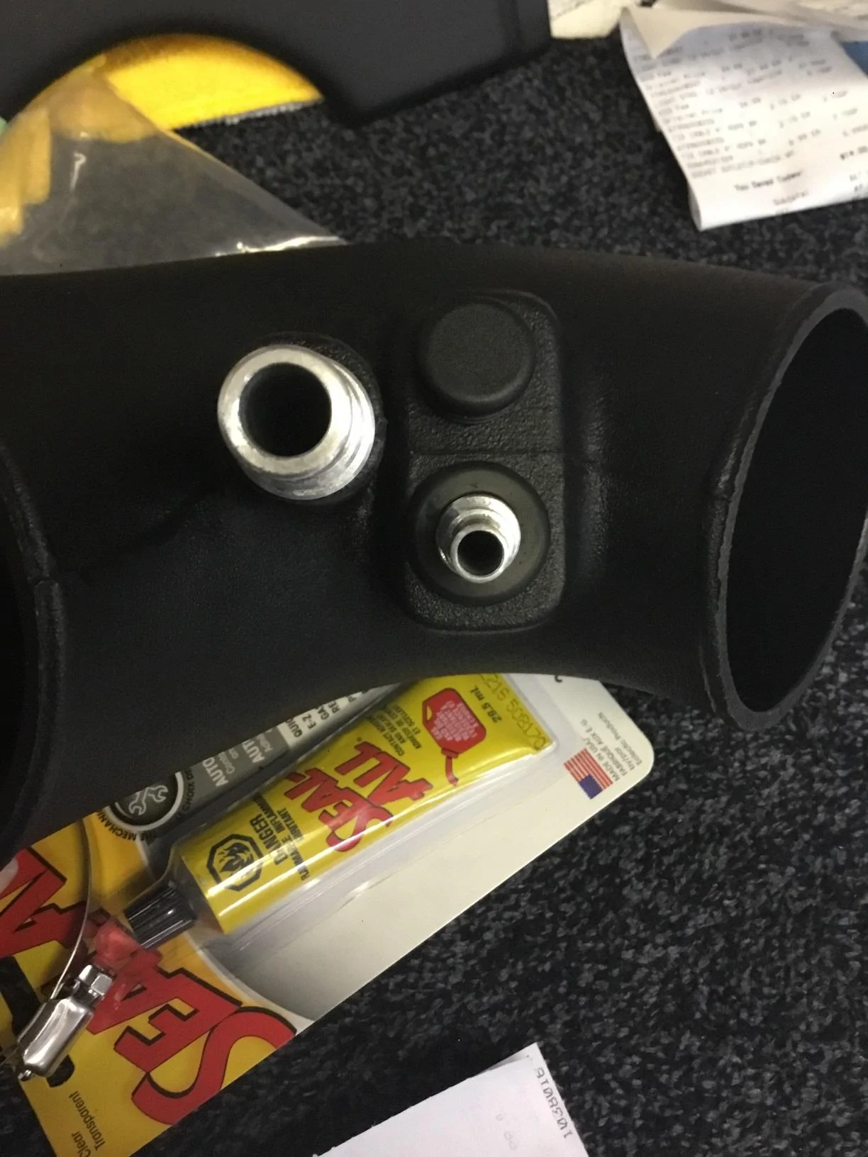

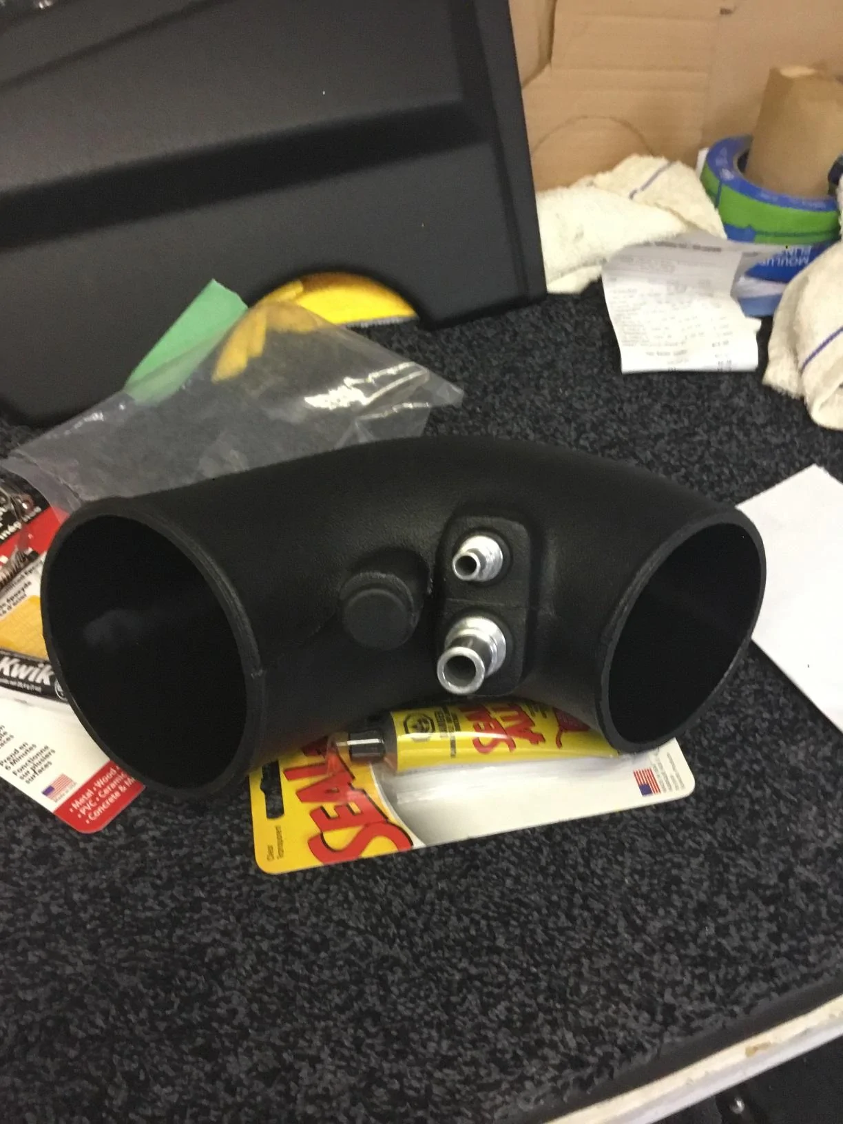

Strokerswild; To make the 2014 engine cover fir I relocated the MRC hose from the top of the input tube to the bottom....then relocated the bottom coil cover hose to the sound tube delete location....then the cover will sit right down and lock into the pin locating holes on the intake as they should! Top pic is normal..bottom pic is my mod. In 2017 Ford deleted the MRC hose altogether!
