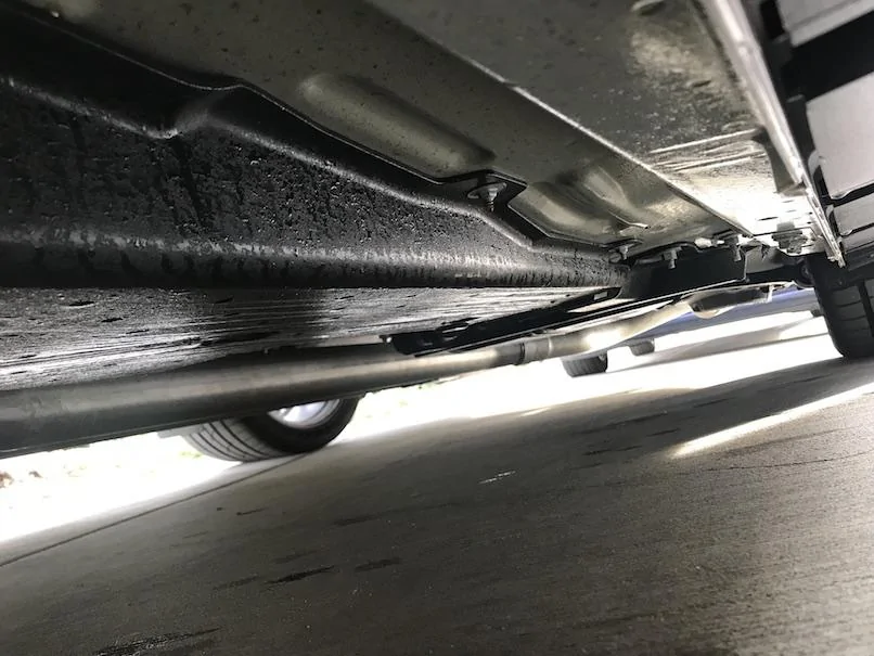

So after my car spent a total of 51 days at the dealership for an intermittent start issue, I now have the whole underbody of the car coated in oil. When i received my finally "fixed" car this past friday, the technician had left a connector leading to the fuse box unplugged, missing screws on battery compartment and a banged up front bumper. Now this...

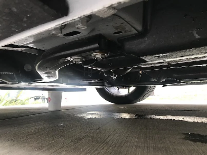

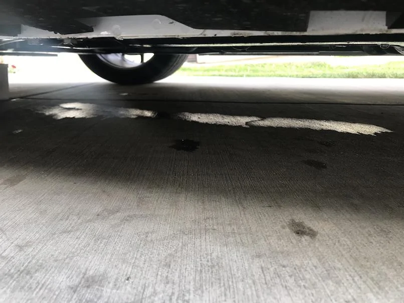

I walked out this morning and noticed oil all over my driveway.
It's mostly towards the driver side from front to rear, but heck even my rear bumper has oil on it.
I purchased the car brand new mid october after trading in my ecoboost. Have had it for a total of 3 weeks max in my driveway since then. :headbonk:

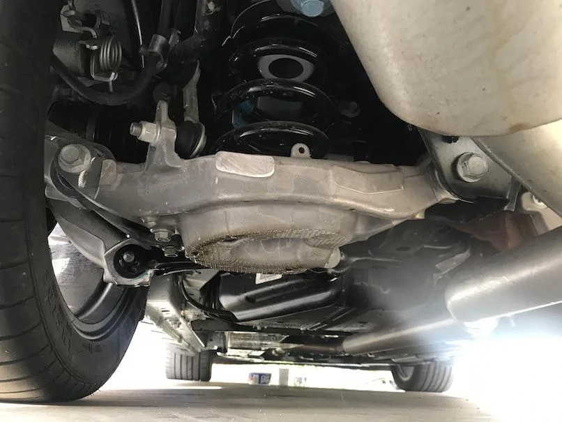

It takes one hell of a leak to get oil on the rear lower control arms.
Oil is all over the rear bumper... yes on the outside (license plate, deck lid , even up by the factory spoiler)
