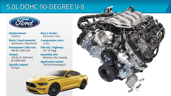

I’m assuming it’s lhd. But if you look at the shape of the cooler it’s different from our my15-17 rhd cars. My understanding is that our cars use the same cooler as lhd cars but located in a different position on the end of a cast manifold. I might be wrong on that, not having a lhd car to compare with. Our coolers are more rectangular in shape and both water pipes exit on the same side.Nick do you know if that's a lhd or rhd lump?
That is LHD drive engine pictured. Definitely a different design oil cooler to the problamatic RHD coolers.Nick do you know if that's a lhd or rhd lump?
Looking at the new design above I’m wondering if this could sit between manifold and oil filter on the rhd mil. Then use a street fighter bypass manifold up where the rhd cooler fits to complete the oil circuit.That is LHD drive engine pictured. Definitely a different design oil cooler to the problamatic RHD coolers.
Unfortunately there is no room on the RHD Mustang to do this , therefore the reason Ford has re-located to the rear of the lh engine area via the manifold.Looking at the new design above I’m wondering if this could sit between manifold and oil filter on the rhd mil. Then use a street fighter bypass manifold up where the rhd cooler fits to complete the oil circuit.
