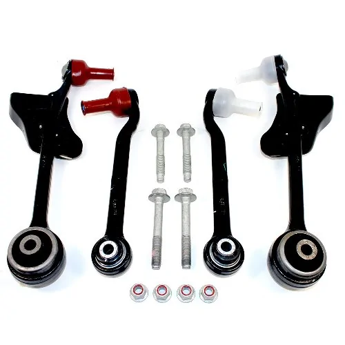

Yes. They're similar to the PP rear toe link where the bearing is much better vs. rubber bushing.Just saw these on FRPP website. The price seems to be good but my question is will I notice anything different in terms of more stability and firmer steering feel?

Well the front tension link arm (long one) I have not seen much difference in, with the primary difference being mounting points for air deflectors.
The Lateral Link...the PP version definitely looks beefed up, and also features an OEM style monoball instead of a rubber bushing.
Can someone post a link or images of the actual FRPP Kit mentioned?
https://performanceparts.ford.com/part/M-3075-FCan someone post a link or images of the actual FRPP Kit mentioned?
Looks like they give you both so you can have the air deflectors too. The only performance (handling) difference is the lateral link at the mounting point.
From what we have found here, that does seem to be the case.So you are saying the control arm with air deflector is the same as the base gt without the air deflector?
Yes. Verified by my inside source in Mustang V-Dyn. The lateral link however, is worth getting (or whatever Kelly cooks up here).The part # on PP and non PP bushings on the front tension link is

I am pretty confident the only difference are the deflectors [MENTION=15675]Niz55[/MENTION]
