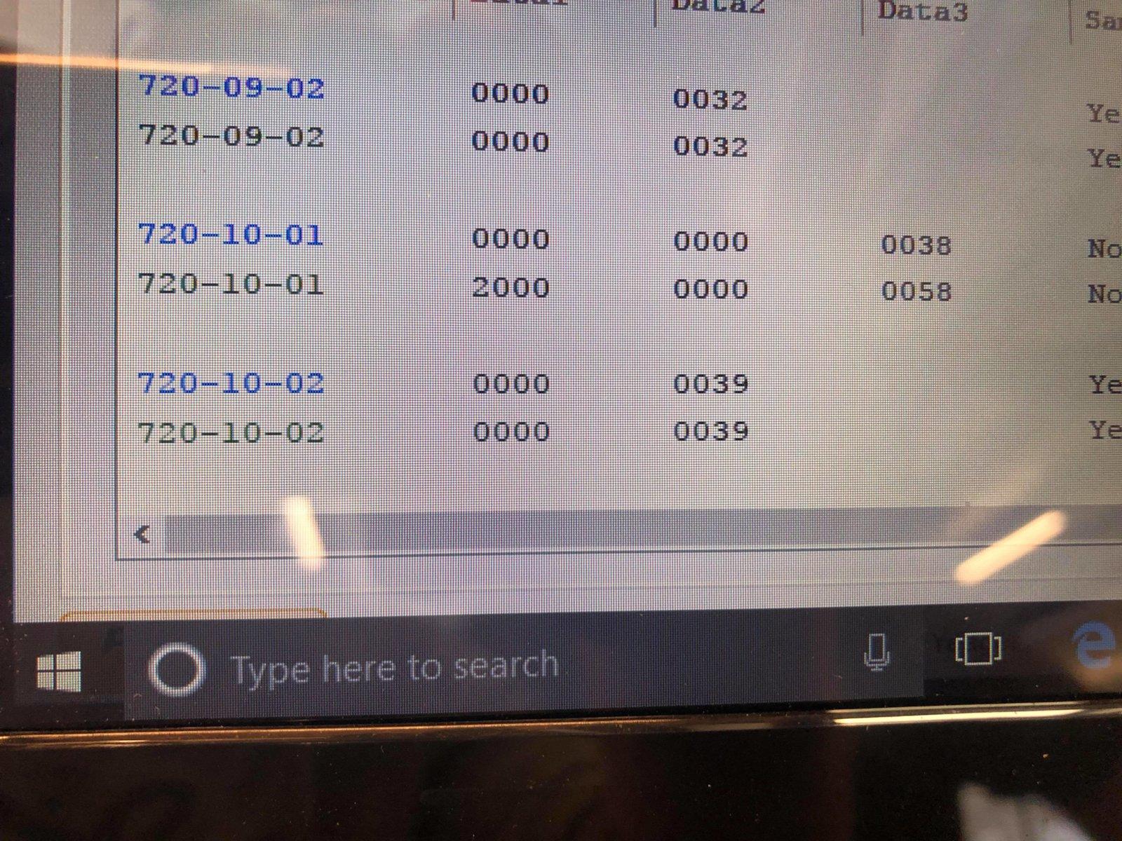

I'm trying the forscan coding to make sure it enables the option on my LCD cluster before I buy mufflers. It seems to be good but I'm not sure.
Previous post gives this: (same as spreadsheet on this site)
720-04-01 X*XX XXXX XXXX 4 = Enabled 6 = Disabled
720-10-01 *XXX XXXX E = Enabled C = Disabled
For me, the first line was same but the second wasn't. I had a 1 instead of C but used the E anyway.
720-10-01 *XXX XXXX E = Enabled 1 = Disabled
The option for Active Exhaust is now displayed on my screen but I can't change modes. I also get a warning when turning on the car that says "Active Exhaust Mode Selection Not Available".
Since I don't have the mufflers installed, the lack of actuators may be causing this...or the coding may be wrong???
