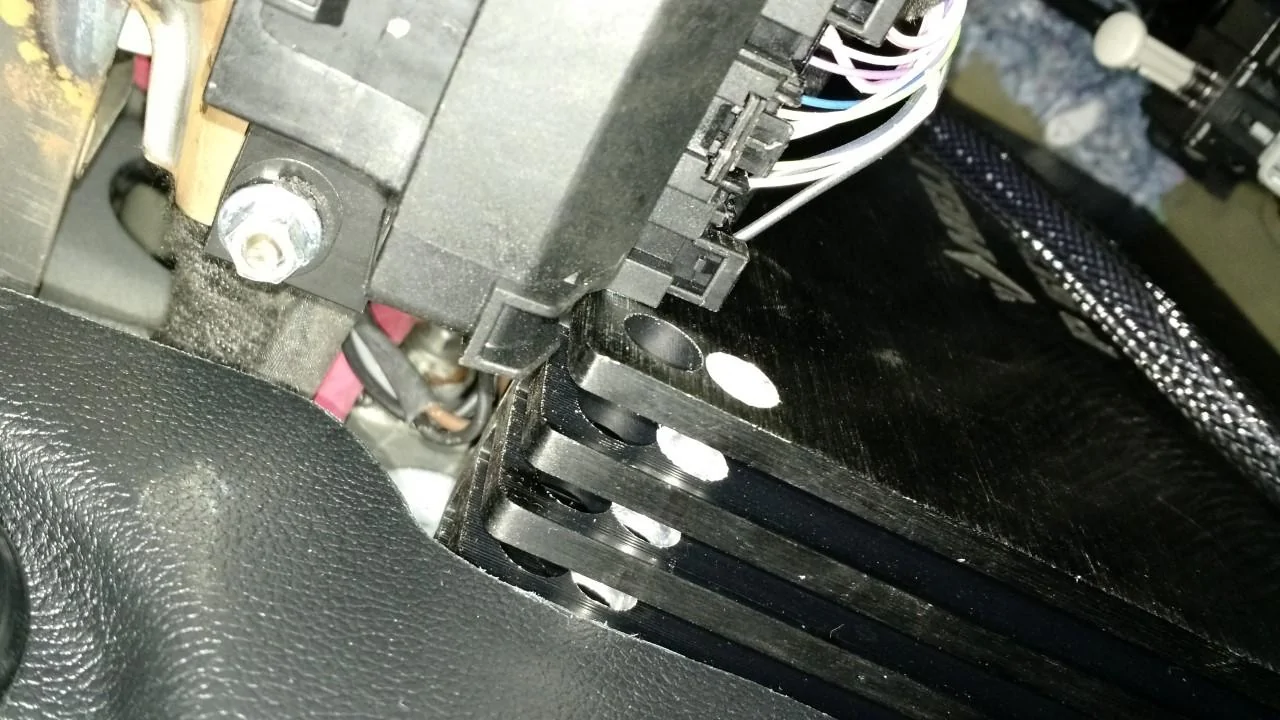

I did not take alot of pictures,but if you have followed my other thread it is in the factory location.It is so tight in there I would not suggest it unless you have fabrication experience.The JL was a tight fit and this thing is about 3/8" of an inch wider.

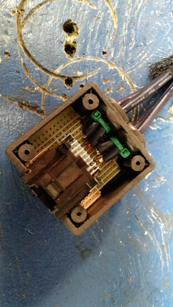

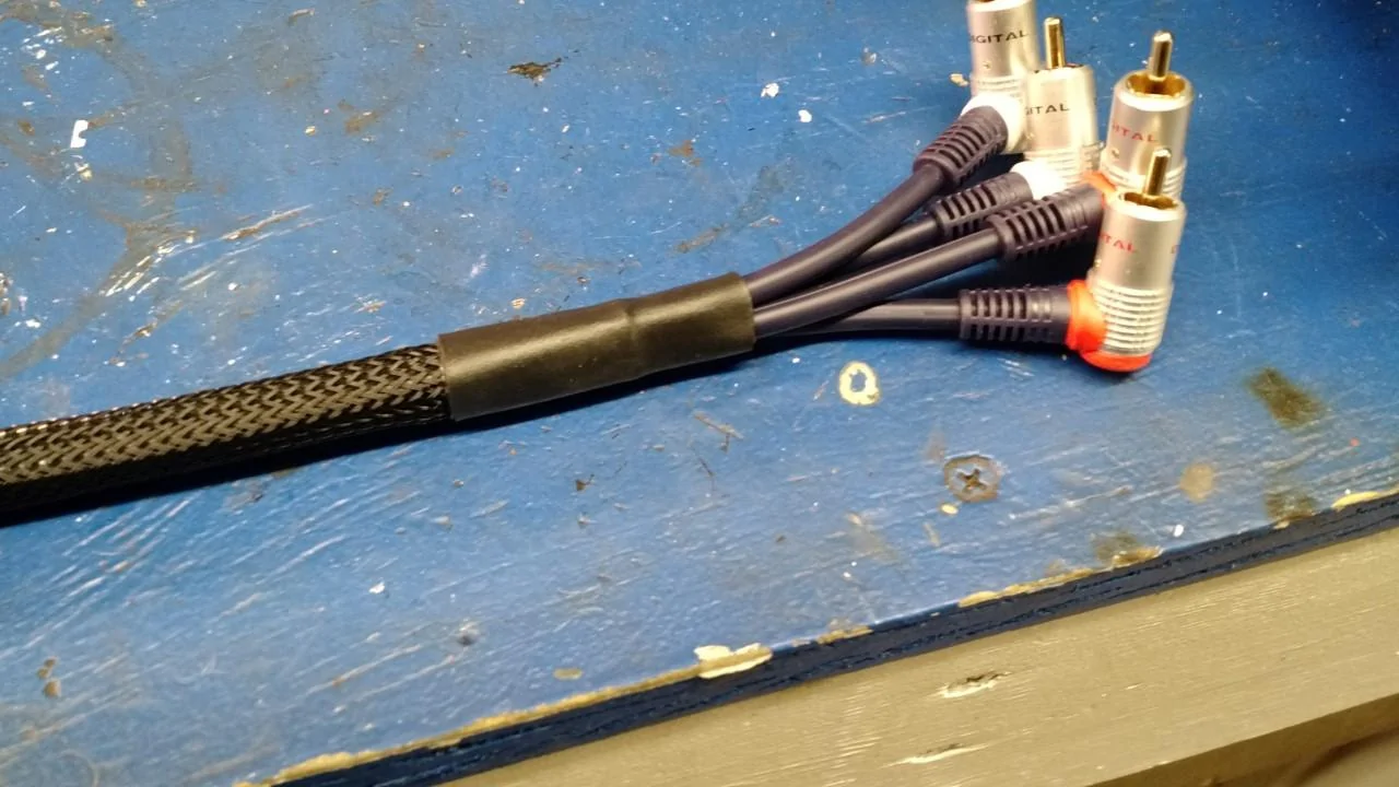

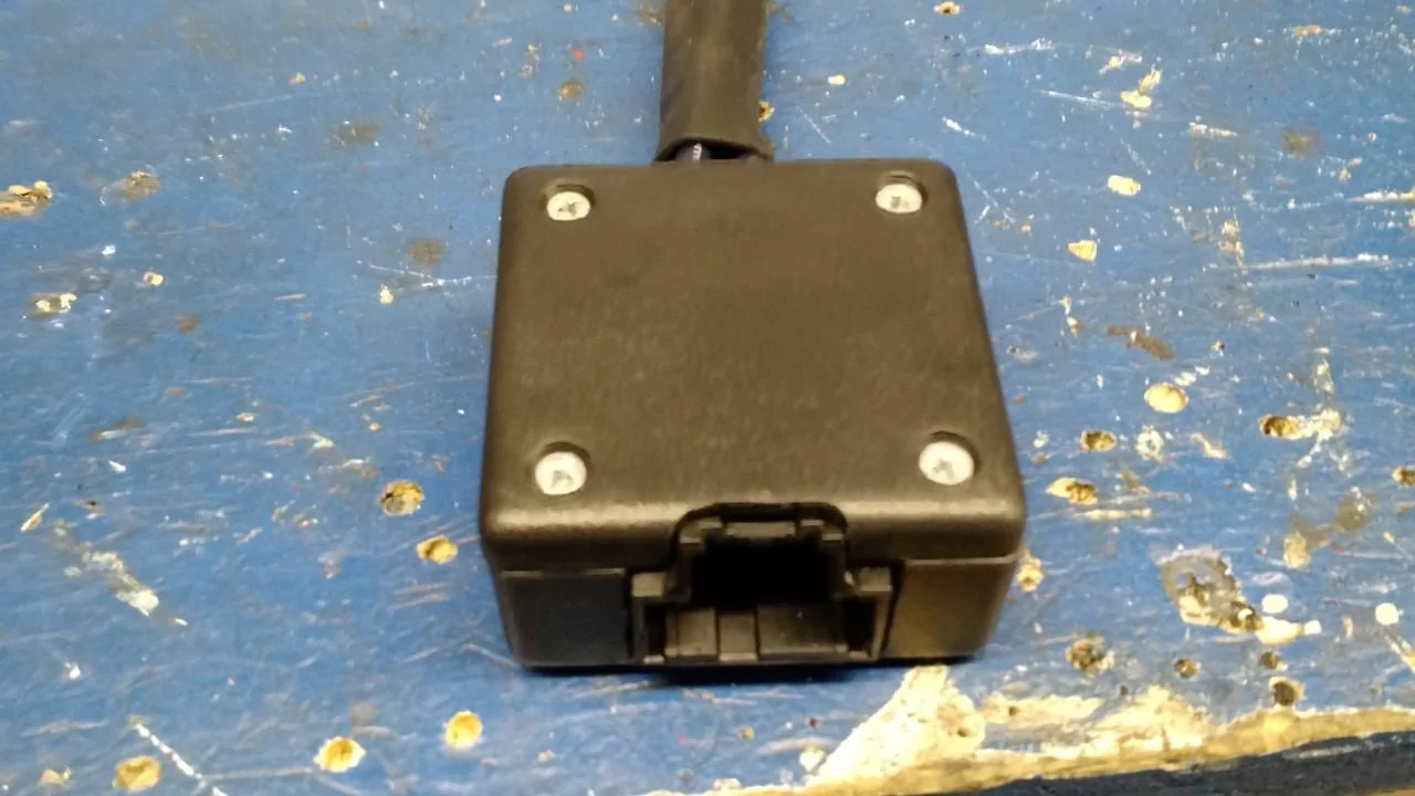

Also the rca jacks are now right against the firewall requiring 90* rca cables.I did re-use my breakout box but made a separate one just for the rca cables.

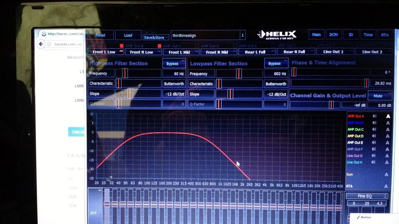

Here is a screenshot of the software.
I only gave it a quick setup on sunday,and I can tell already that this thing is going to sing!This weekend I will set the mic up and really give it a tune.
