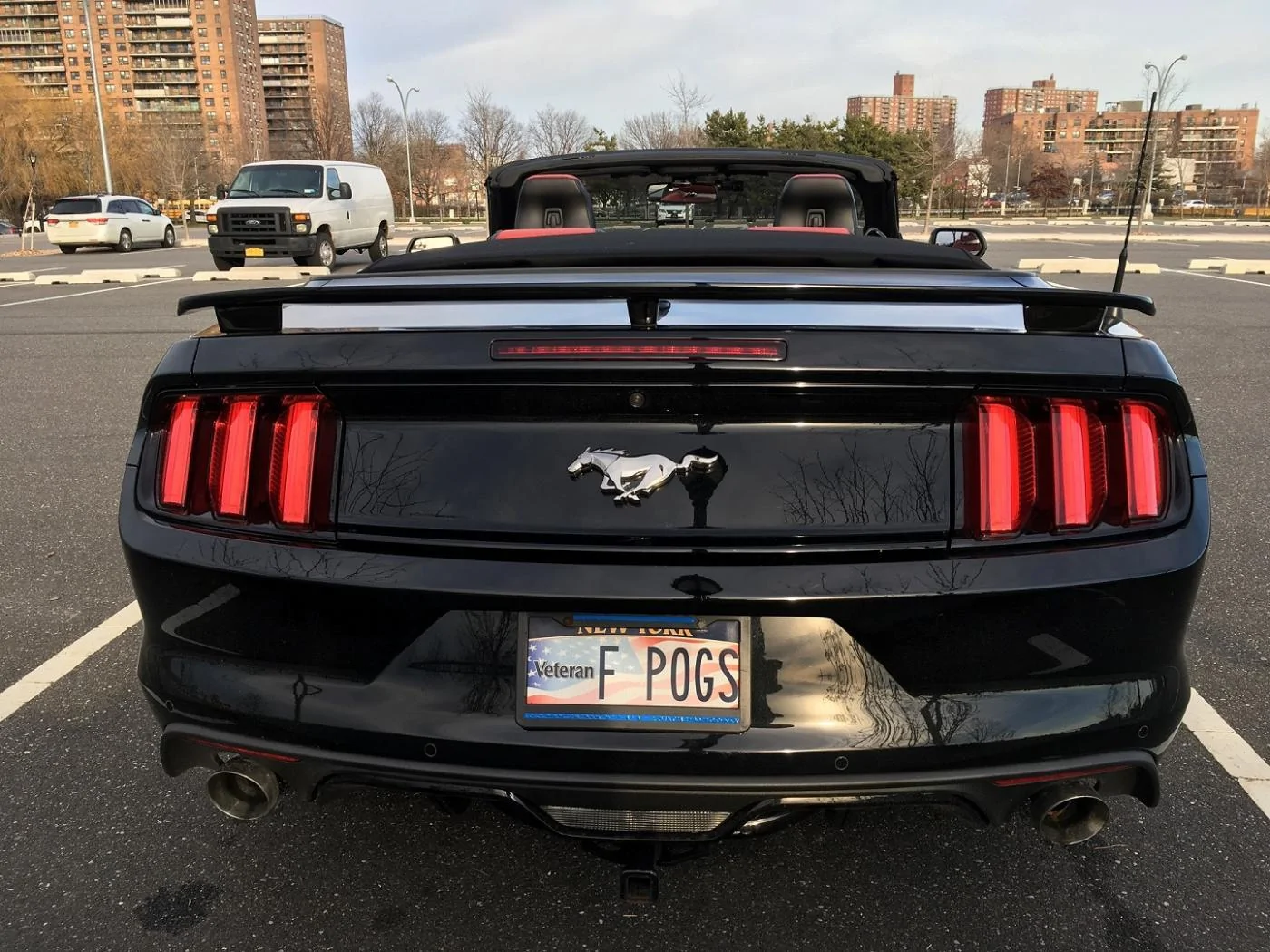

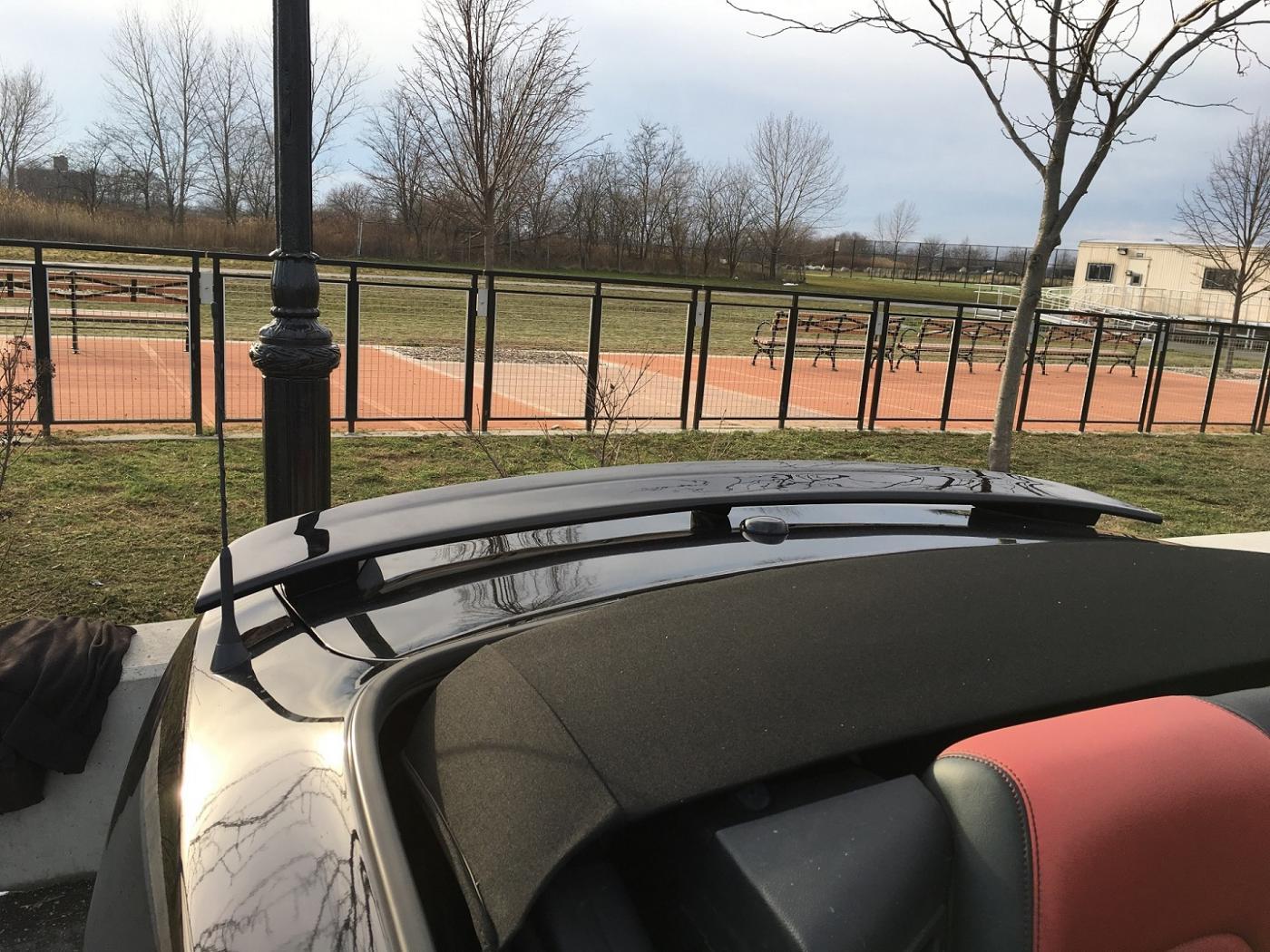

As some of you may know, I have been waiting for this spoiler for over a year now, and I have been in contact with WingTech ever since to get this going, but because the coupe's trunk is different than the convertible's, it took longer than expected.
The install was very simple, measure 100 times, drill once. Finding the center was relatively easy by using my satellite antennae and my 3rd brake light. It's getting both ends perfectly even that took a bit more time. I was just measuring a million times until I was satisfied that it is even enough, although you could just eyeball it and no one would be able tell the difference.
I'm not sure if a template will be released with the final product, but you really don't need one. Now that I have installed this solo, I would probably prefer to do it again without a template. I used a Step Drill Bit until I could fit the screw through, and used the same bit to open up holes big enough for my socket to fit through from inside the trunk. Applied silicone around the holes outside before placing wing on.
