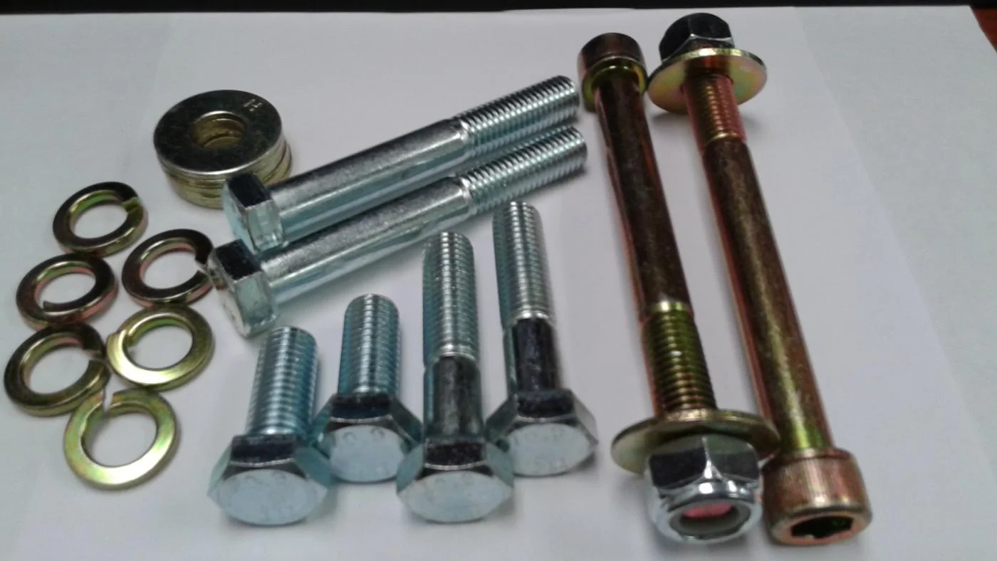

-First off, is our hardware. We pride ourselves in using the best hardware we can get our hands on. With all of our products, we offer at a minimum, a zinc coated Grade 10.9 that is equivalent in size, OR larger than OE spec.

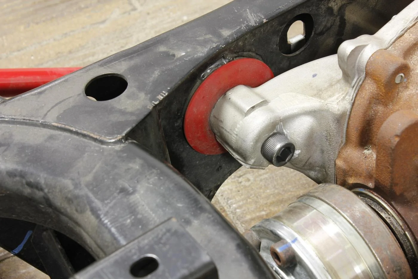

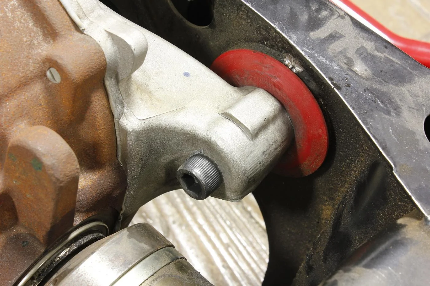

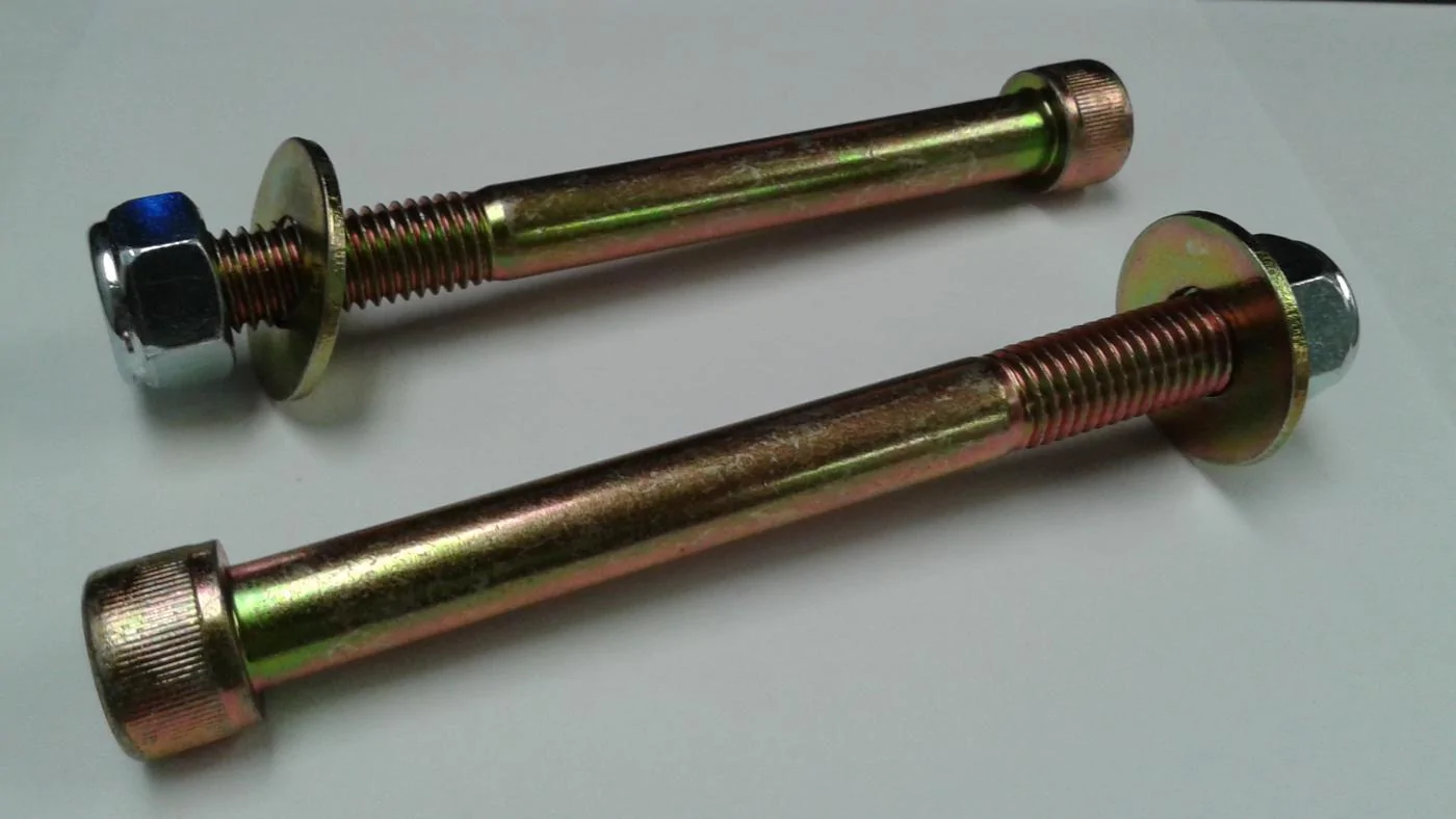

The hardware with this kit, will feature (6) bolts and supporting pieces to install the BK051 Diff Lockout Kit...with no issues. *ADDITIONALLY, hardware is included, for those who race their cars, or are making high power levels and want a piece of mind. So we include (2) GRADE 12.9 Allen Head Bolts, that install from the center of the cradle, back towards the rear of the car. This ensure MUCH MORE shear capacity, by removing the shear force on the threads and placing it on the shank. By putting those loads on the M14 Grade 12.9 shank...instead of the threads, the strength increase is staggering. Pictures of these bolts installed on our test mule will be at the bottom of the photos.

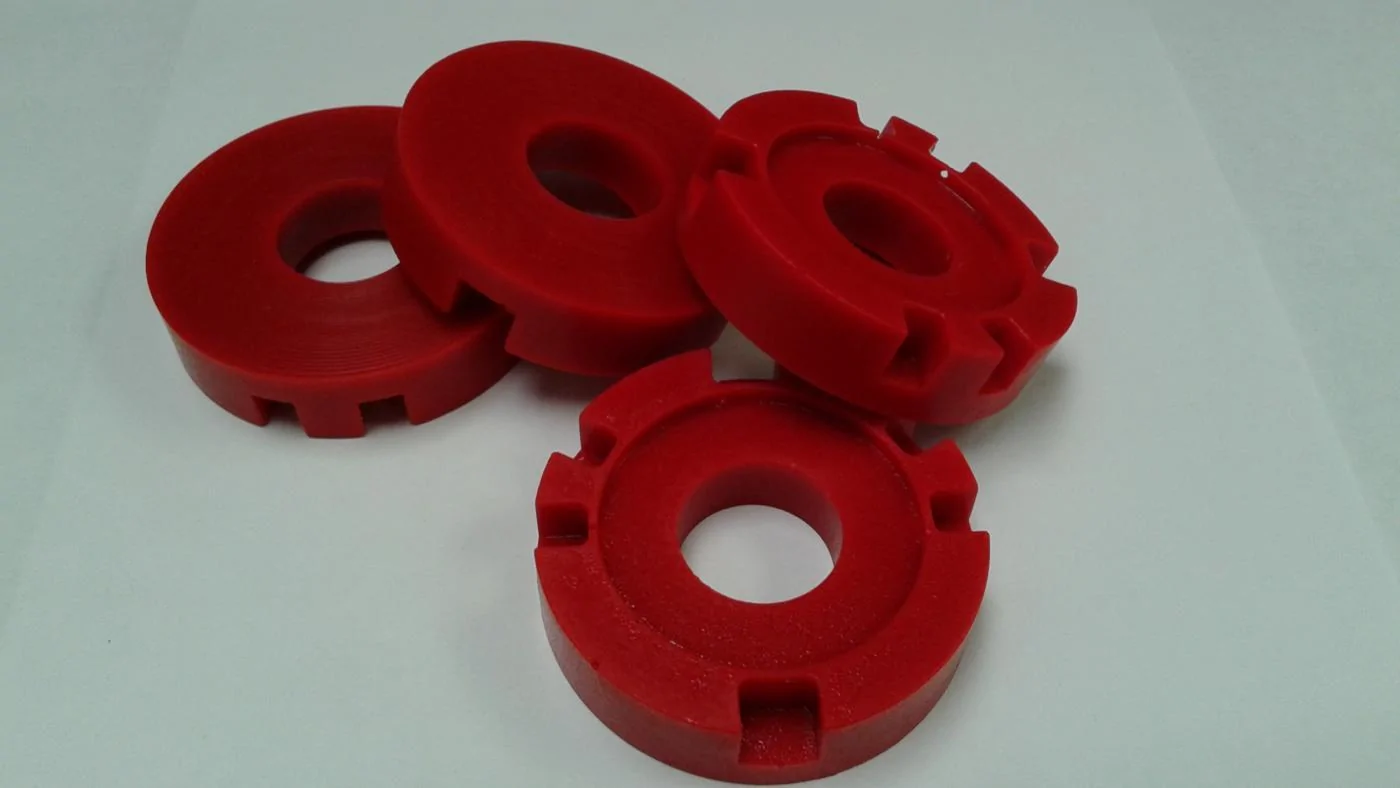

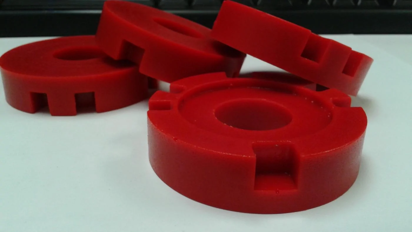

-Poly Diff Lockout Pucks, we designed and tested these bushings 100% in house, and have them made by a large Bushing Manufacture that is located within the US.
These Pucks are made of high quality 95 Durometer Polyurethane, for maximized performance and a longer lasting life. We designed these pucks to fit snug and tight within the front and rear bushing voids, and made them all (4) the same to help keep costs down...and make installation easier for the end user, as you cannot mess it up.

-Provided Bolt Upgrade, it works! Test, test and more testing! That is out style. We have seen so many differential bolt failures up to this point, that we simply could not release this kit to the masses with atleast giving them the best option for strength. To prove how common this is, I recently had a customer who was on the dyno with his turbo S550 here locally, contact me for help after he actually had a differential bolt BREAK on the dyno! Not even on the street. This bolt failure cost him a lot of money, and he ended up going with a BMR Diff Solution that I assured him would not fail. At the time he was not a BMR customer, but he has since acquired a few BMR items since this incident. Fairly common for people to come to me at some point when they make their cars faster and more powerful. :cheers:
The bolts we provide, I have had on test cars across the country for almost a year now...and we have tested them on our cars in house, thoroughly. I have yet to see one bend or break, and I have full confidence in them.
