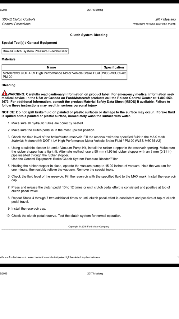

No but you will want to try to bleed the system following the install. Use the correct pump to get it done.if you want to install the Steeda Clutch line do you have to "bleed" the OEM line before removing?
Vacuum Pump. Applying pressure will compress the bubbles and aerate the fluid.Anyway I can use a pressure bleeder for the clutch? Meaning, can I attach a pressure bleeder (if I pump it, it creates pressure rather than vacuum?) and pump the clutch or do I need a actual vacuum pump to suck on the reservoir and then pump the clutch?
Cool, looks like I will be looking for a vacuum pump now. Thanks!Vacuum Pump. Applying pressure will compress the bubbles and aerate the fluid.
