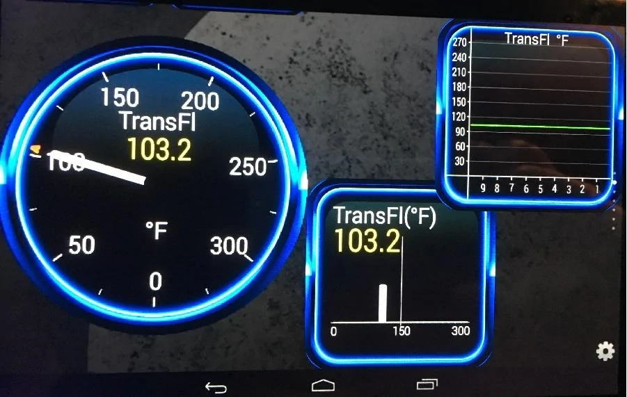

I got this to work using my OBDLink LX and Torque app on my old Android touchpad 5 minutes ago! Works great! Setup was a little different for Torque:
  • Settings
  • Manage extra PIDS
  • Transmission Fluid Temp (I modified Method 2)
  • OBD2 Mode = 221e1c
  • Scale factor = x1
  • Equation = same as yours, thanks for letting me cheat off your homework. :thumbsup:
I added some graphs to my Dial...
