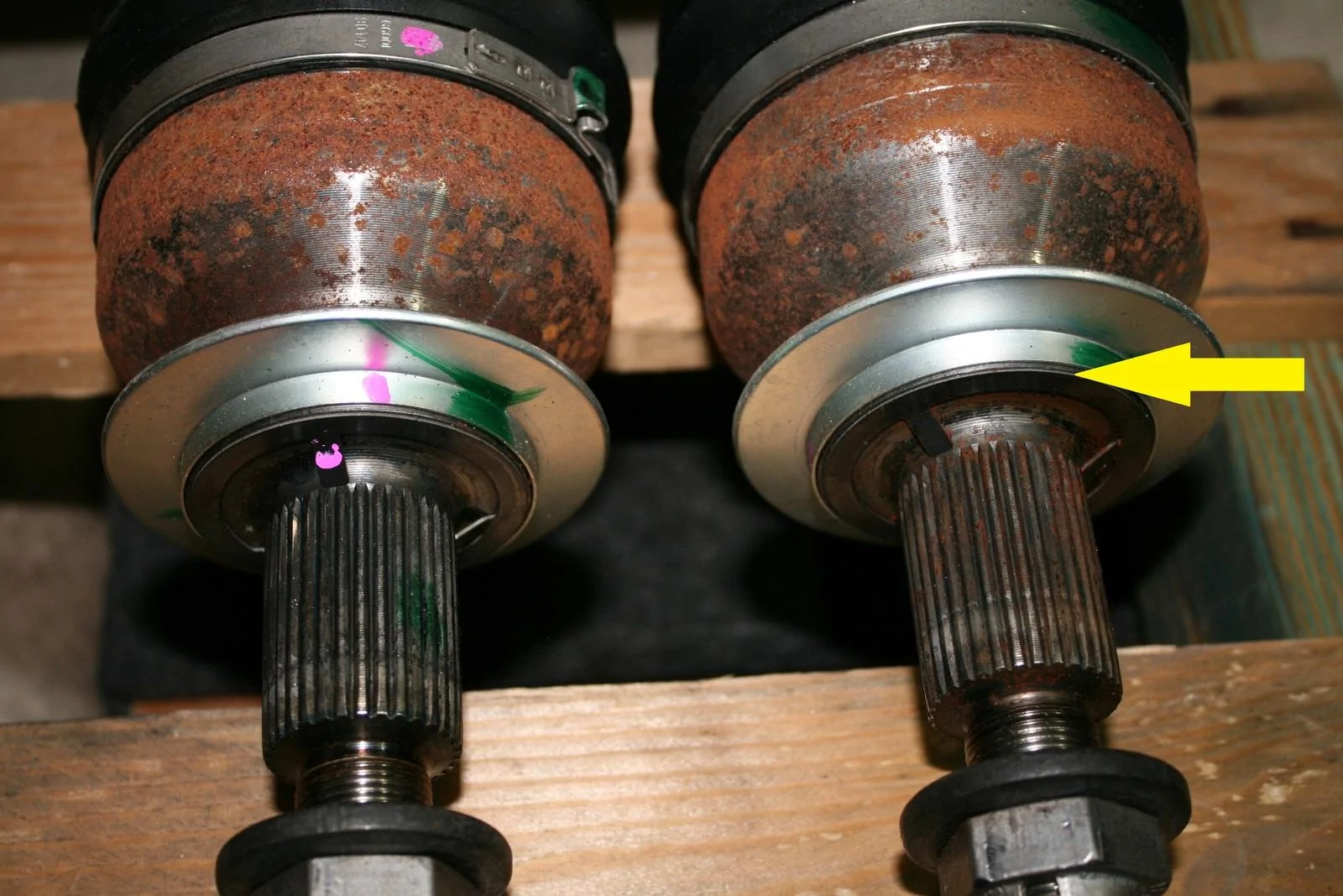

I took my 2015 Mustang into the dealer on Wednesday because I was getting the AdvanceTrac Service, ABS, and Traction control lights illuminated on the dash. Today the dealer called me and told me that they found a problem in the left rear or the car. They actually asked me to come in so they could show me the issue.
He showed me on the passenger side that the black ring i highlighted with yellow arrow in the below picture was intact but on the driver side it was missing. He then showed my the Knuckle where that black ring had busted into pieces and was covering the ABS sensor.
Anyway, My car was lowered with BMR springs and the service guy started to tell me that ford may decline the warranty work??? Has anyone every seen this issue before and could it have honestly been caused by a lowered vehicle?

Where is the ring that is damaged these both look fine???
The service manager would not let me take a photo in the drive bay. The attached photo is one I found online. On my actual car the driver side ring is completely gone. All that is left is the pieces that were visible in the Knuckle itself.

If it was never apart, ie you never removed the axle nut the axle is clamped into the hub, that ring is pressed up tight to the hub bearing. If you had that apart I understand shit happens but if not there is no way for that ring to fall out unless is fell out at the factory during assembly. The ring is always clamped but the preload of the axle nut.

I personally never took that assembly apart, I would have no reason to..From what the service manager showed me when he walked me back to my car in the drive bay was the knuckle housing on the floor and the shaft still attached to the car..The shaft was missing the ring and then there was what looked like busted pieces of the ring all sitting on top of the bushing inside that knuckle that was on the floor.
