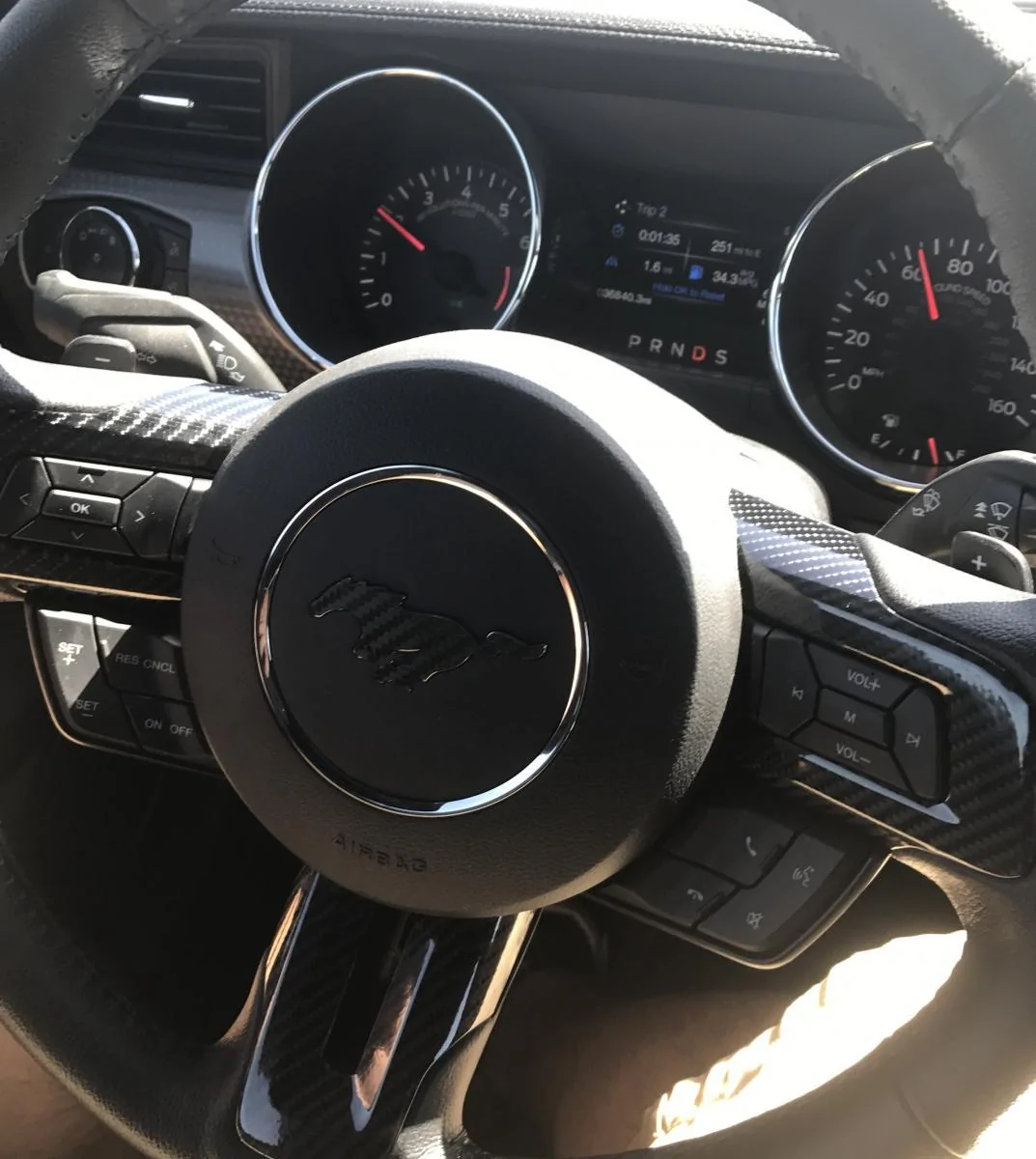

It had been annoying me for a little bit, but finally the bright finish on the steering wheel bezels drove me nuts on a 7-hour drive last weekend. No more! I thought. I will solve this with vinyl!
I solved the problem with vinyl, and so can you.
One thing to note: I've never vinyl-wrapped anything before other than a cell-phone back (just because). It was relatively intuitive to do this, though, and was not difficult.

Et voilĂ !
Reinstall your buttons. Looking good!

Here's the piece before I hit it with the heat gun and smoothed it out. It's not perfect, but it's a damn sight better than before.
The airbag just slides right back in to its mounting brackets. Don't forget to reconnect your battery, and you're done!
All said it took me about an hour (maybe 90 minutes?) to wrap the bezels (not including removal and reassembly. Keep in mind that this was the first time I'd ever done anything like this.
Ultimately I'm quite pleased with the effect. It makes the interior look nicer (I don't like fake chrome) and more livable (no more sun in the eyes off the wheel).
