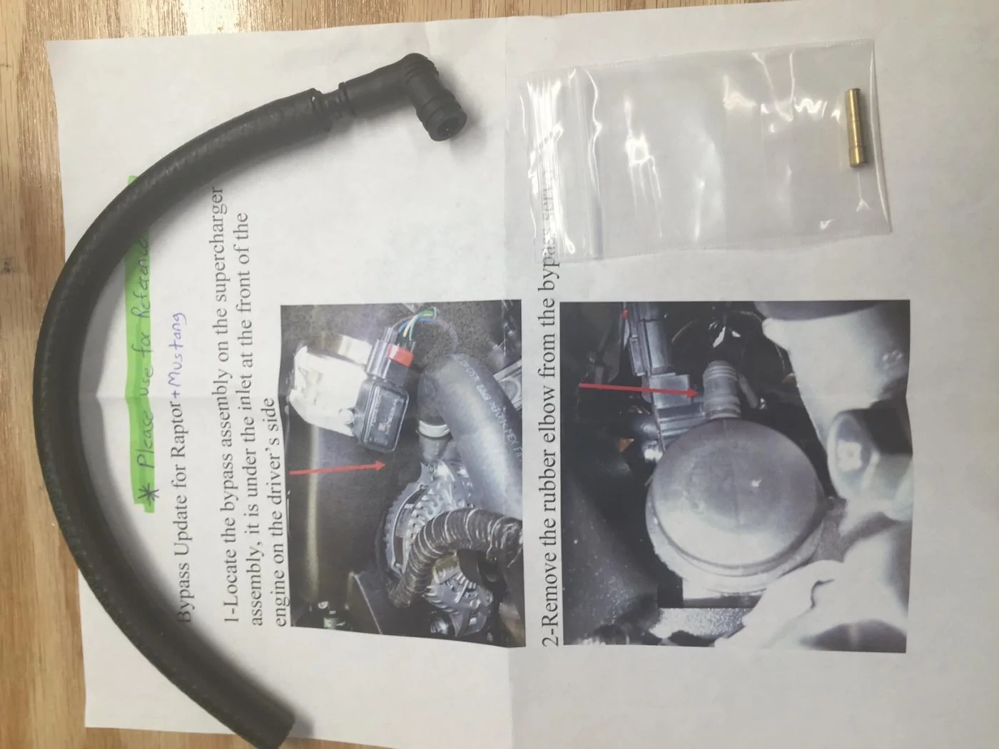

Well, as a few others have mentioned, Whipple is aware there is a "hiccup" or "hesitation" issue that is thought to be caused by the Bypass valve shutting too quickly when moving into boost from a vacuum.
I pleaded with the guys at Whipple and they decided to add me to the list of lucky beta testers.
They overnighted me a small box.
Inside was a instruction sheet with nice big pictures showing what was involved with the install.
It only took about an hour and would have gone much faster but I was working on straightening out some of my SC Coolant lines.
Anyway, I took the throttle body off easily with only 4 allen bolts.
Once off, I had reasonable access to the bypass valve.

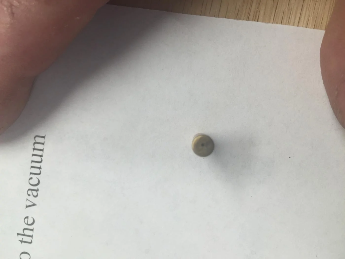

I put the small brass fitting shown inside the bypass valve thus limiting flow from a AA down to about the size of a push pin hole.
I put it in the plastic inlet on the bypass valve firmly but gently. I then put the bypass hose over it and reinstalled the other end where the original was.
I went for a drive.
I knew immediately the issue was fixed! (almost completely)
90% of the hesitation is gone and I am VERY happy. If I had to live with it like this I would be glad to.
The better news is that I dont!
The rest of the issue is likely to be fixed by a new calibration that is currently under validation testing at Ford. As of now they hope to get the thumbs up from Ford and then make it available in about a month or two.
Anyway. I was lucky enough to be a Beta tester and they said it was ok to share the good news just be patient with them while they finalize the solution and know that it is well on its way!
Cheers!

So basically when the bypass valve shuts too quickly, the supercharger didn't have enough air to ramp up to the atmospheric pressure for the engine to breath properly because it takes time for the air to travel through the supercharger.
Adding this restrictor, the valve closes slower allowing the supercharger to suck enough air before going into boost mode so it's a smoother transition.

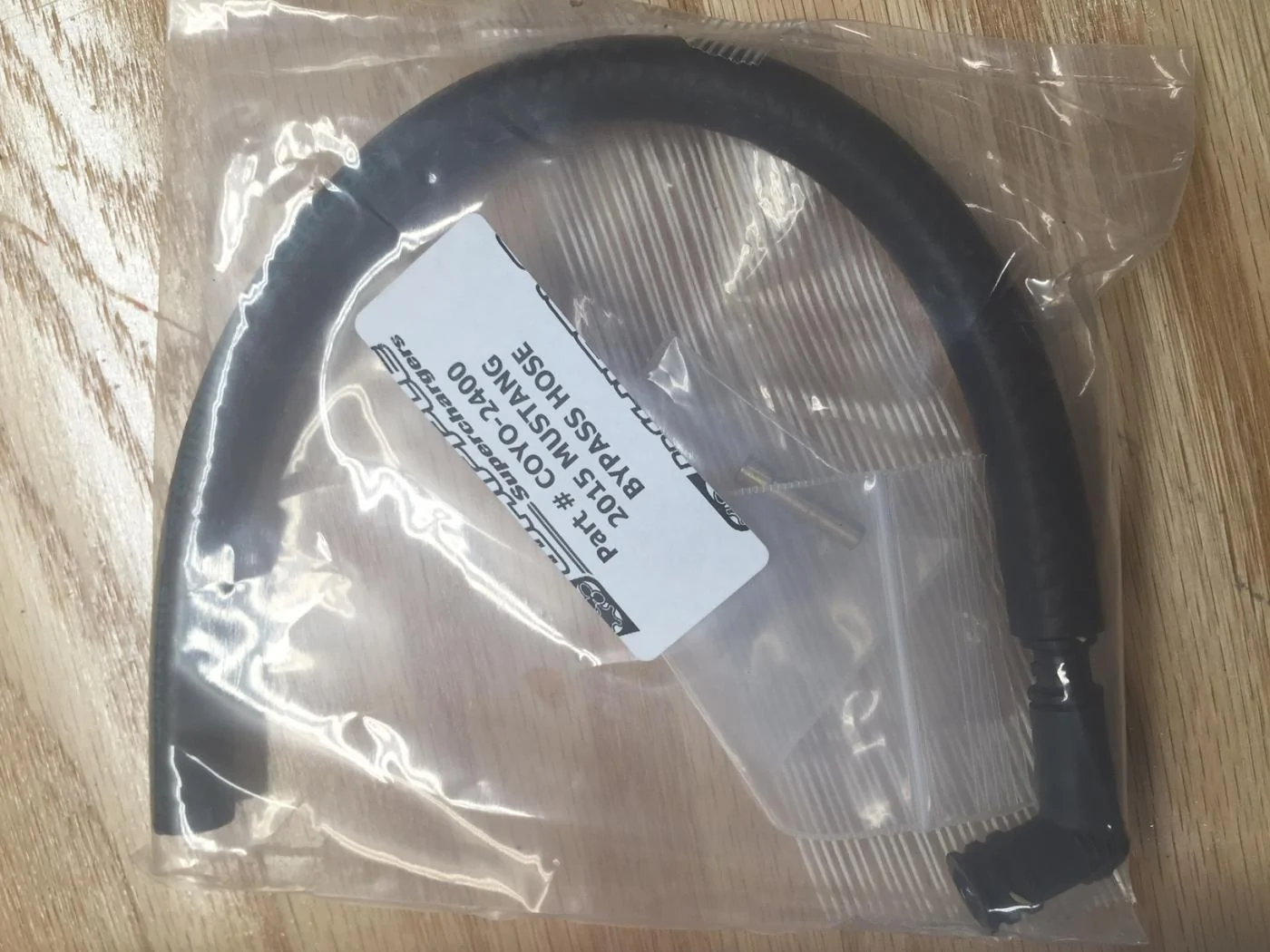

I've also been bata testing for this issue for about a week now. The brass bypass restrictor is (test 1) and the other is the hose that connects to the vac side of the SC (test 2). When testing the brass restrictor I had an issue with the bypass restrictor not being seated all the way In the bypass nipple and it came out and was floating in the hose. The brass piece needs to be pushed all the way into the last step to seat it properly. Anyway I tried today the test 2 hose that connects the bypass to the vac side of the SC and took out the brass restrictor as they are not meant to be run together. After a ride it was apparent to me the car didn't like it setup this way more transition problems and stumble and hesitation. I went home an reinserted the brass restrictor test 1 but this time seated it properly. I after a ride it seems that the hesitation stumble was reduced except for 6th gear 2k rpm when it hits 0 vac at 1/4 throttle. This is a very high load condition and the hesitation happens everytime. I think the brass restrictor helps reduce the condition in gears 1-5, but not 6th according to my test.
Here is how far the brass restrictor should be seated in the nipple.

Not all have, in fact almost all do not have an issue. As the calibration has a bypass strategy built in and it's been calibrated. The bypass and throttle need to work together, if they don't then you will feel a bobble. The restrictor is a small fix for those that have felt a bobble. We are looking mechanically and electronically why this has popped up.
Note this is ONLY for manual transmissions. Auto's will never experience this.
