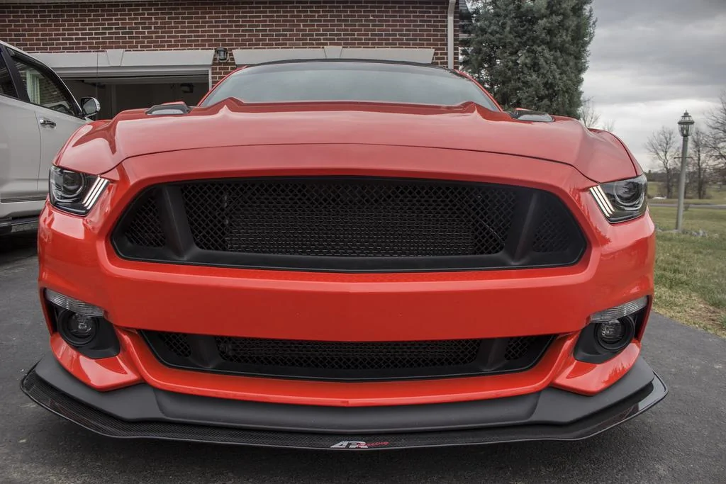

Since I bought the car I've been searching for a grille, but haven't really liked any aftermarket products. The only one that I really was in to was the RaceMesh design, but for almost $700 for just a stock grille w/ steel mesh I sought out to make my own.
Myself and [MENTION=18835]knightvision[/MENTION] dedicated a good couple evenings to make this happen. It's not overly difficult, however patience is key. [MENTION=11533]Project Whitemare[/MENTION] was able to give us some pointers and insight on his grille project to help us get started.

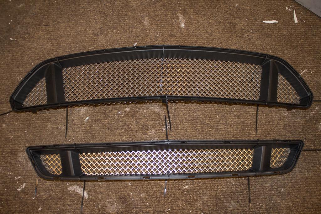

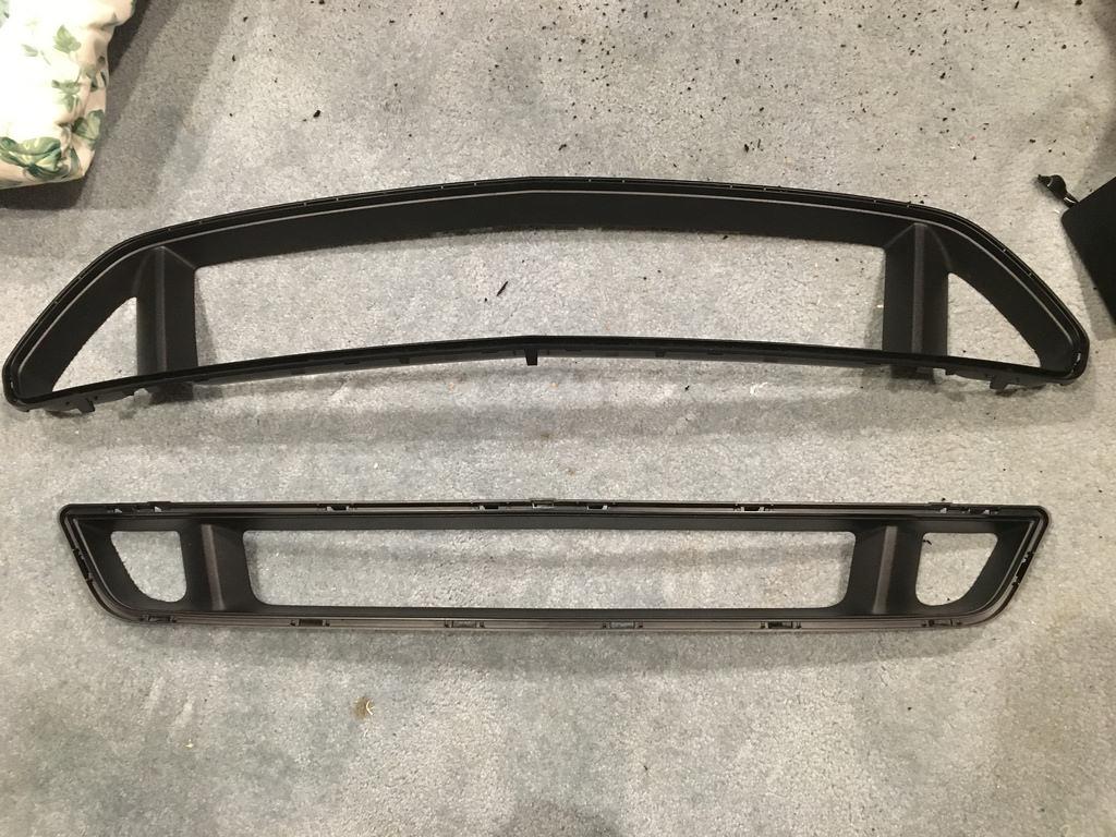

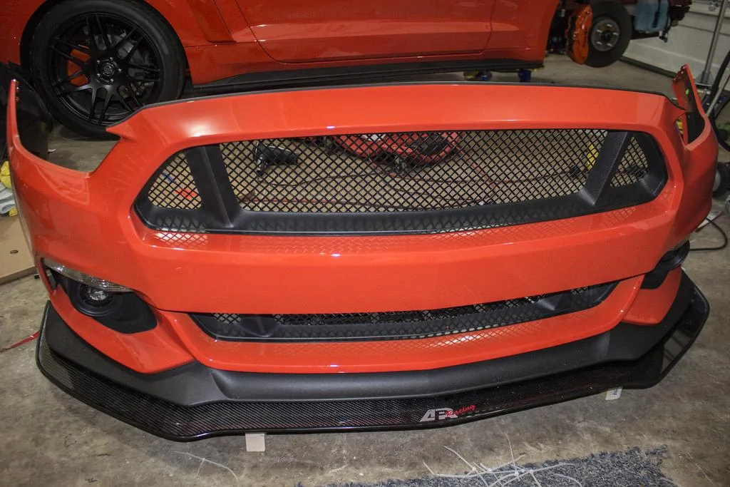

Cutting the OEM Grille with the Dremel and Plastic Cutting Blade. The upper grille was fairly easy to cut without any type of taping for guidance. It has a textured line of the back of it that you can follow for your cut. The lower, has a little bit of guess work involved, but once you find the line, just simply tape along the line to give you some visual guidance while cutting.
After we were done cutting, we sanded down the edges to give it a more smooth and level surface for the mesh.

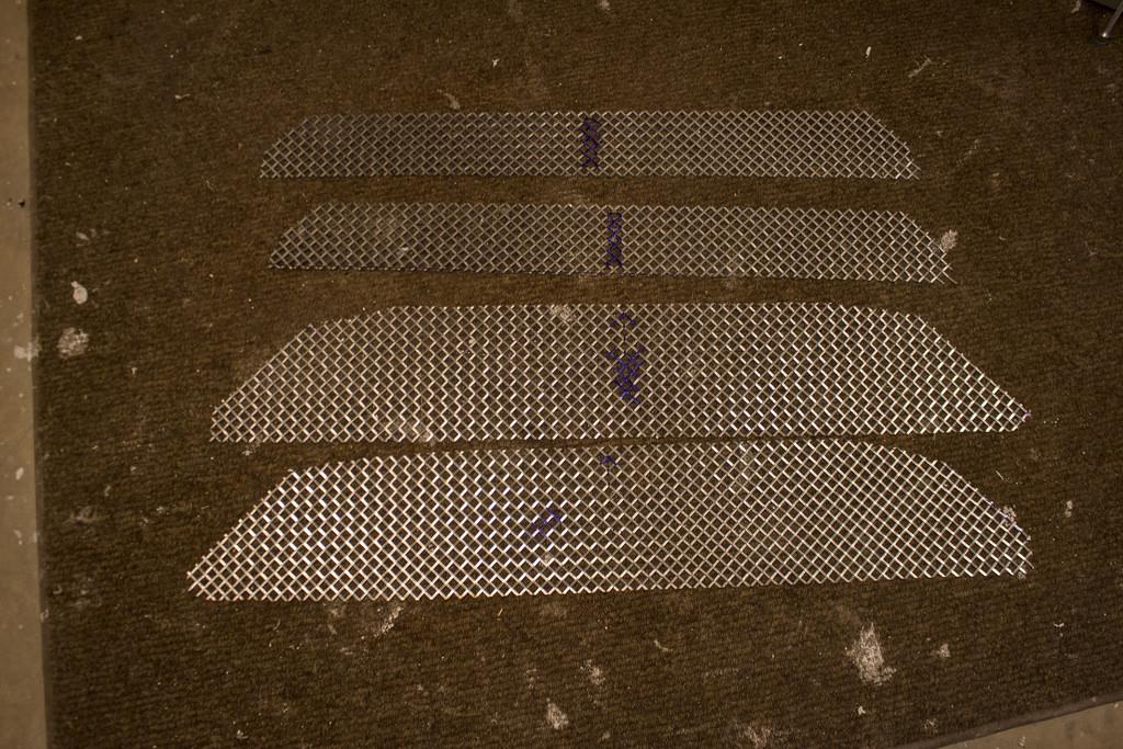

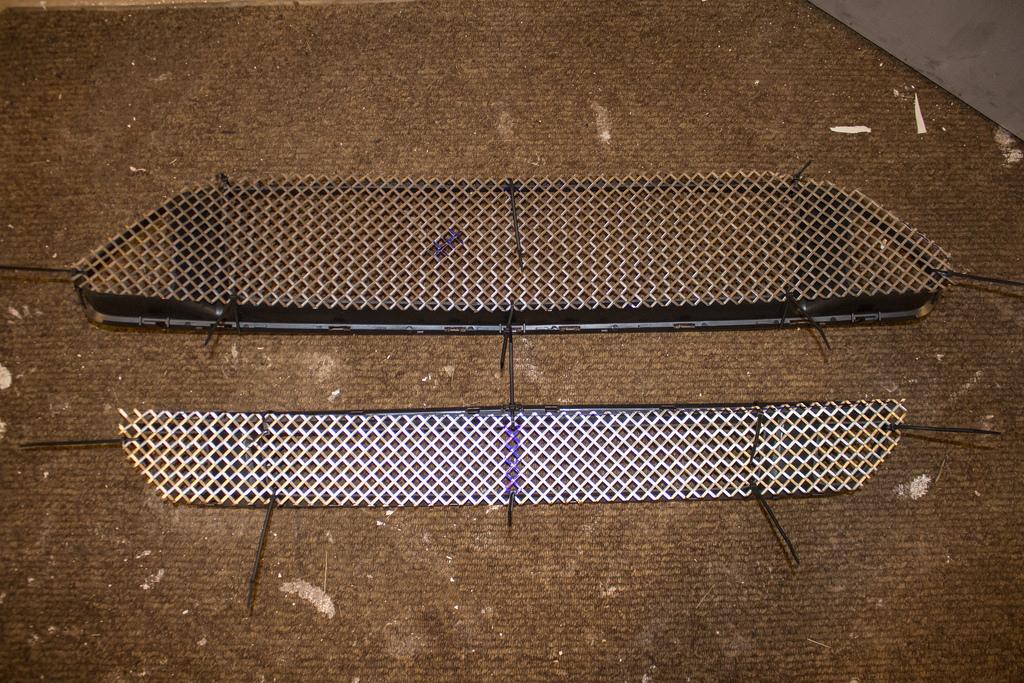

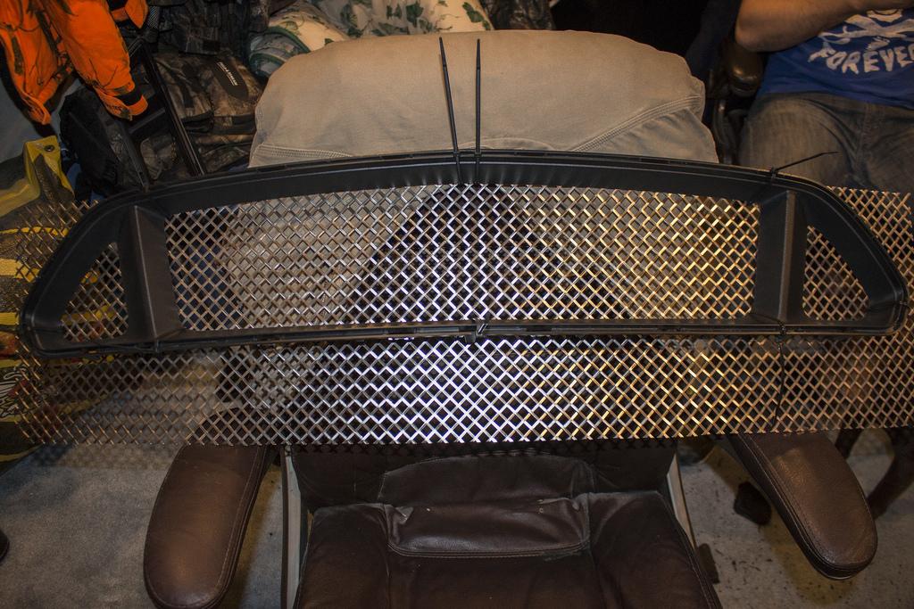

With the steel mesh, we zip tied the grille to it and traced the grille to give us visual guidance on cutting. Both Grilles will not fit on the mesh together like this, so we cut the upper out, then tied the lower, traced and cut. There will be plenty of mesh in the sheet I linked above.
Two sets pictured here for myself and [MENTION=18835]knightvision[/MENTION] .

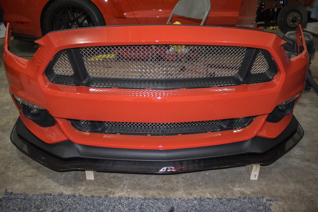

Once cut out, we did a quick test fit to make sure everything fit correctly.

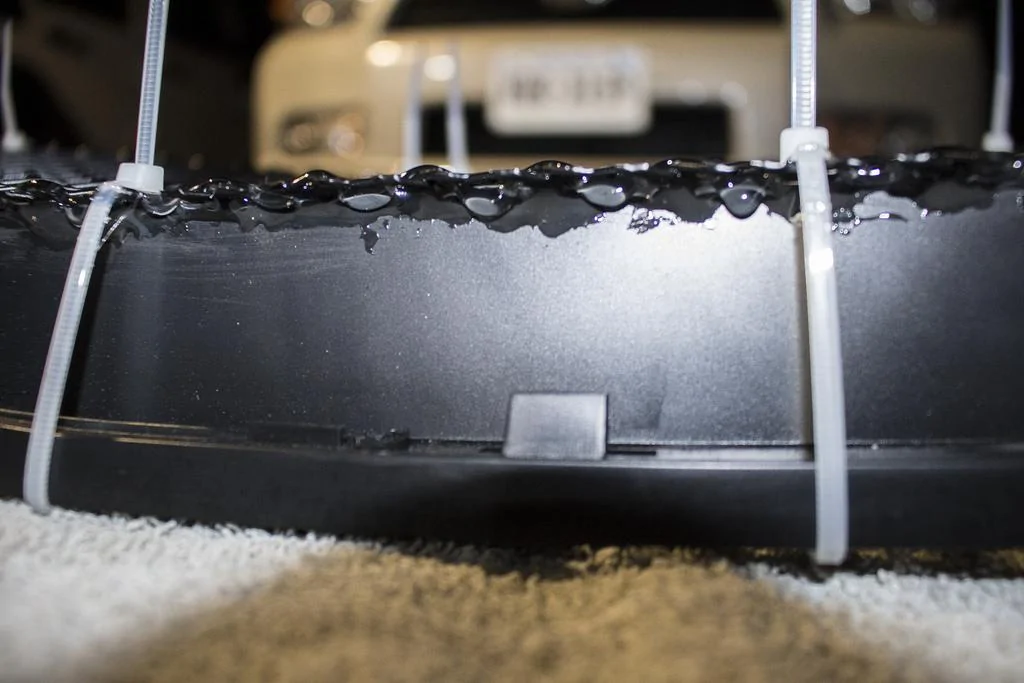

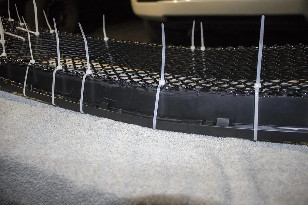

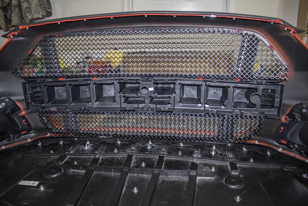

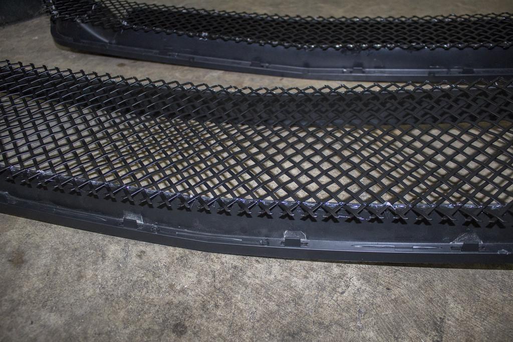

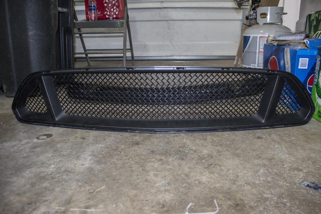

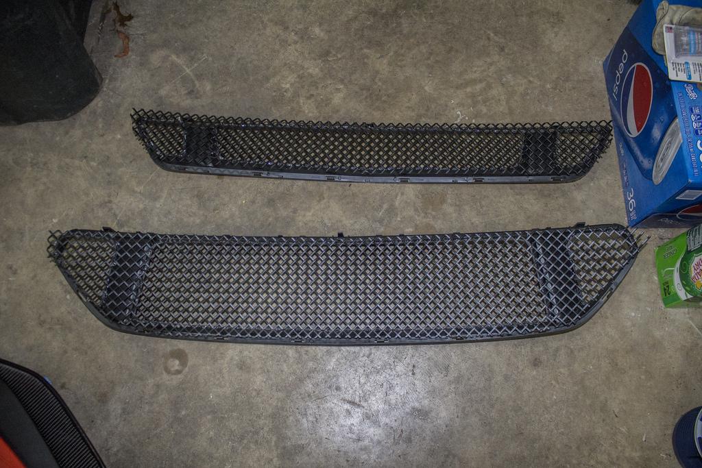

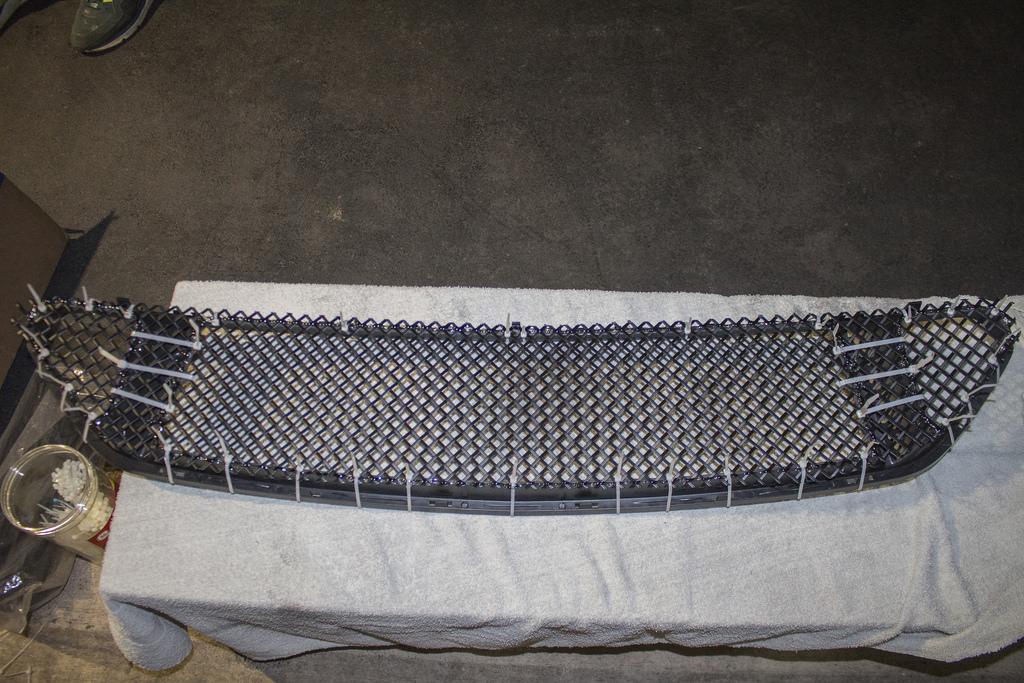

At this point we took the mesh to be powder coated. The next week when we got them back, it was time to adhere them. We used zip ties to hold the mesh in place tightly to the grille while we used the Goop to adhere it. We let the goop sit over night before we cut the zip ties off and installed it.

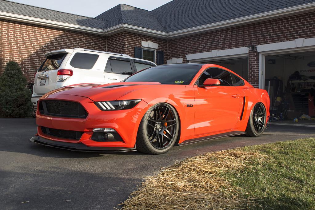

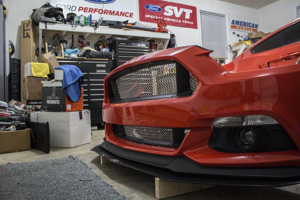

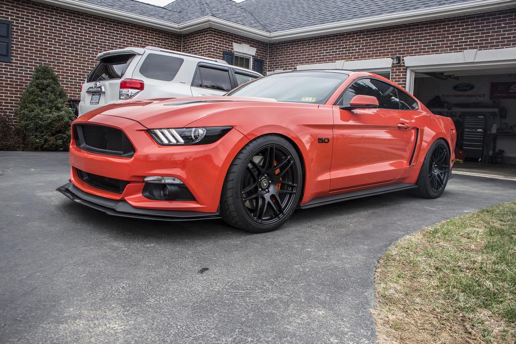

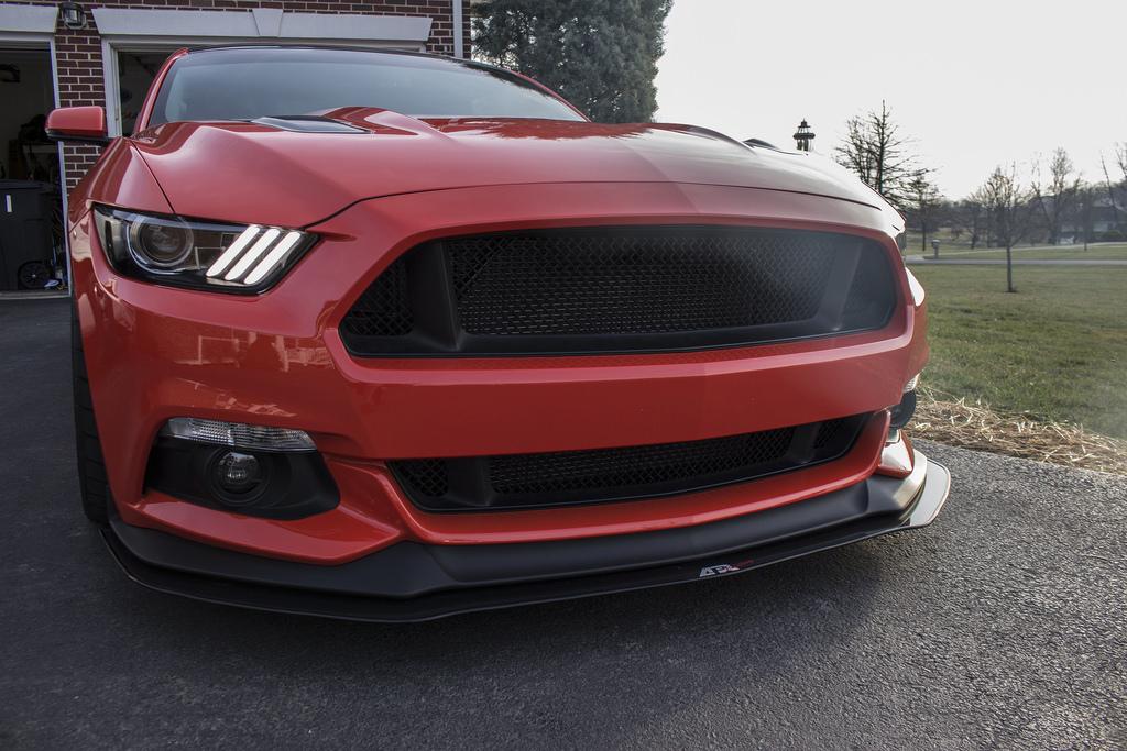

Quick Pictures rolled out of the garage.
All in all I'm very happy with the end results. Thanks to [MENTION=18835]knightvision[/MENTION] for the help to get this done, and [MENTION=11533]Project Whitemare[/MENTION] for insights and help. :cheers:
