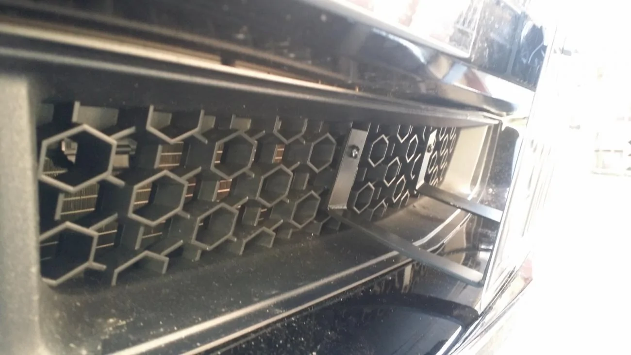

Just thought I'd share what I did for a no drill front license plate brackets. One trip to home Depot piece of aluminum and two bolts to hang pictures in drywall. Works great. :headbang:

I'm trying to get a few more pictures up. :)

I love DIY stuff, good work. I wonder how it'll hold up for you at highway speed

Maybe pick up a couple of rubber bumpers to go behind the plate to keep the plate from bumping on the bumper at highway speeds.

Definitely. I put some thick double sided molding tape behind it for now.
Good at freeway speeds. Has been on for almost two months, no issues. :headbang:

is this DIY mount still working good for you if you still use it OP?
Yes it worked great for a couple of years then I sold the car. Good luck
