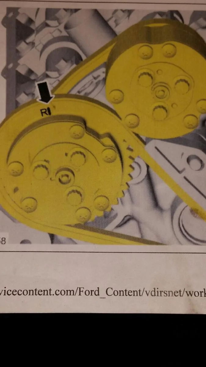

2. Verify the timing mark on the RH VCT unit is on top (See Picture Below), if not rotate the crankshaft clockwise one complete revolution so the keyway is at the 12 o'clock position.

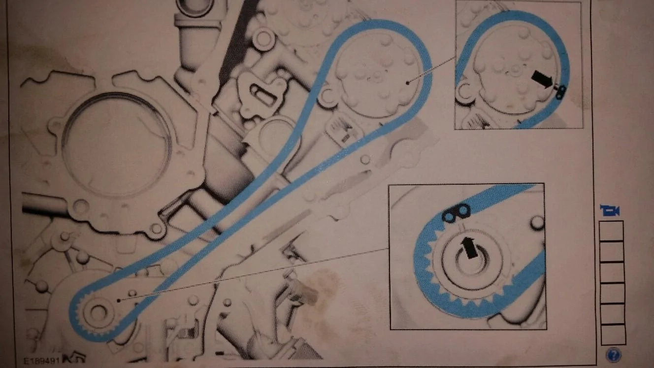

1. Insure the keyway is at the 5'o clock position, if not Rotate the crankshaft clockwise until the keyway is at the 5 o'clock position.
2. Install the LH timing chain. Align the colored link on the timing chain with the timing mark on the LH VCT assembly. Align the remaing colored link on the timing chain with the timing mark on the crankshaft sprocket. (See Picture Below)

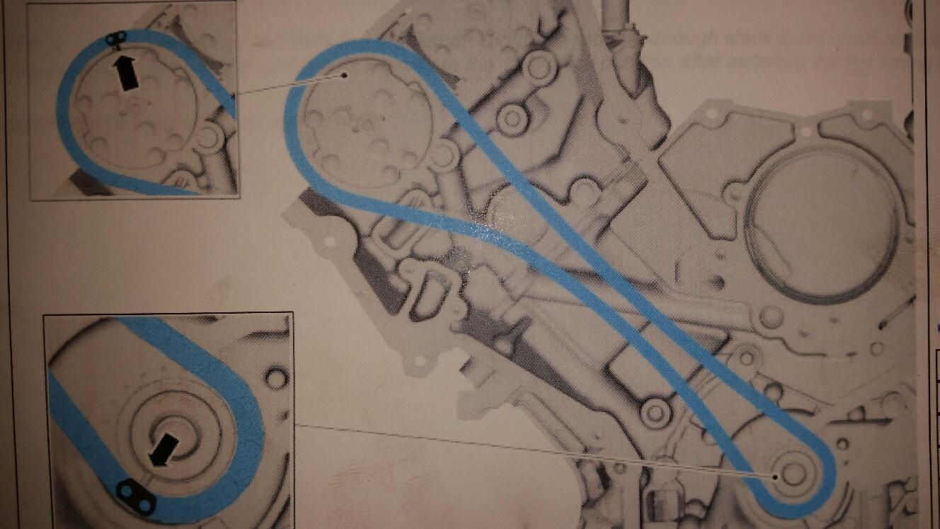

8. Install the RH timing chain. Align the colored link on the timing chain with the timing mark on the RH VCT assembly. Align the remaing colored link on the timing chain with the timing mark on the crankshaft sprocket. (See Picture Below)
