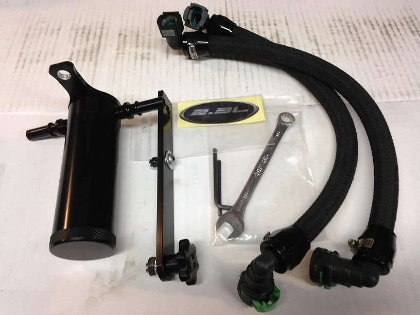

I wanted to add some clarity to the installation of the UPR PnP Catch Can on a stock Ecoboost Mustang. The catch can comes complete will all tools required for the install. (And a 2.3L emblem, Thanks UPR!) UPR provides the following video to assist with the install.

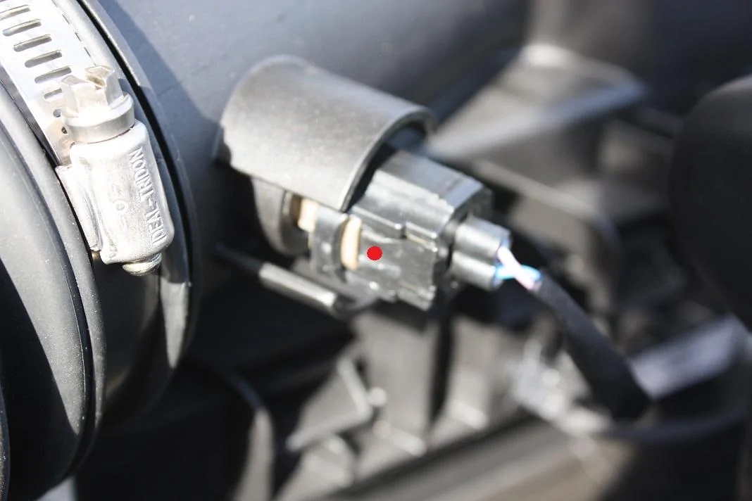

5. The (Intake Air Temp) IAT sensor can be unplugged by pressing in the black tab (Red Dot)

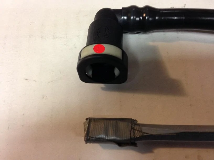

8. To remove the original hose, press DOWN on the square White tab, then pull out the hose. I wrapped the tip of my screwdriver with duct tape to prevent marring the surface.

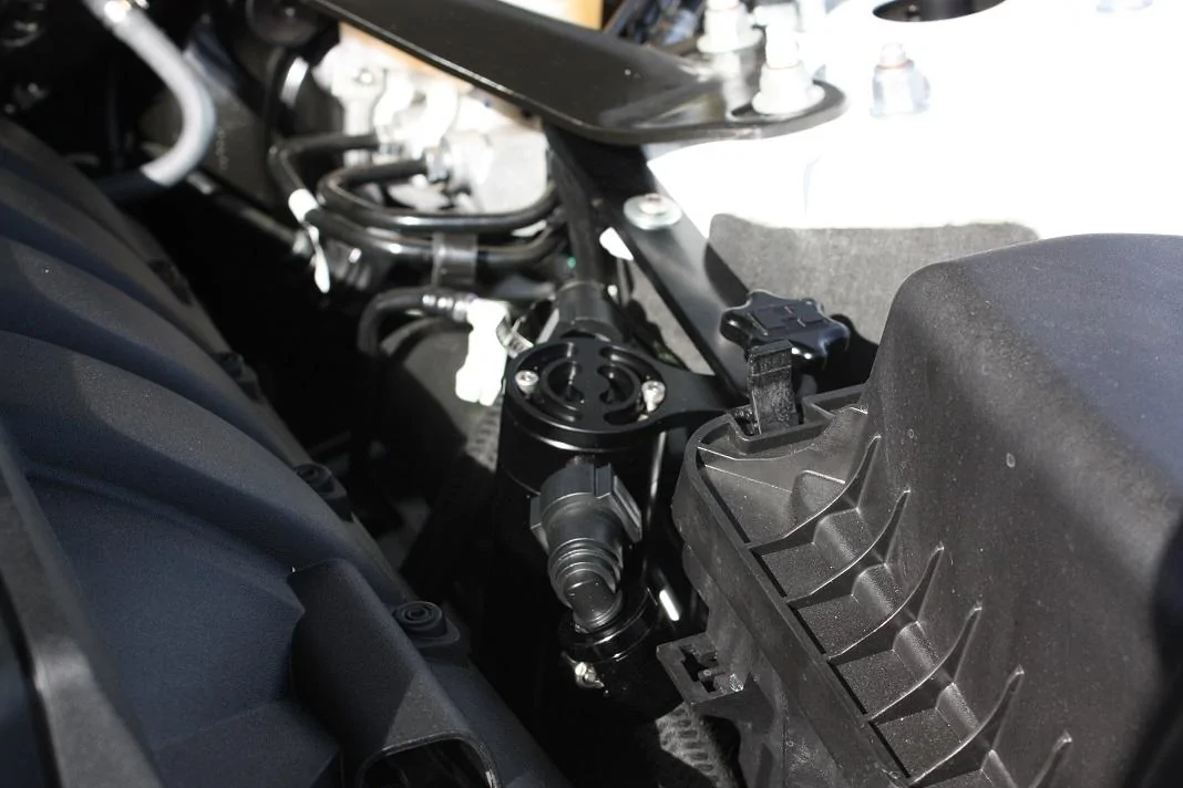

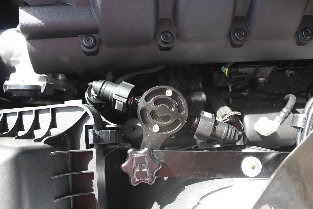

11. Reinstall the factory air box BEFORE, securing the catch can and bracket.
12. Due to tabs on the factory air box, I had to install the catch can at an angle.
13. Finally, Connect to the final two connectors to the catch can.
