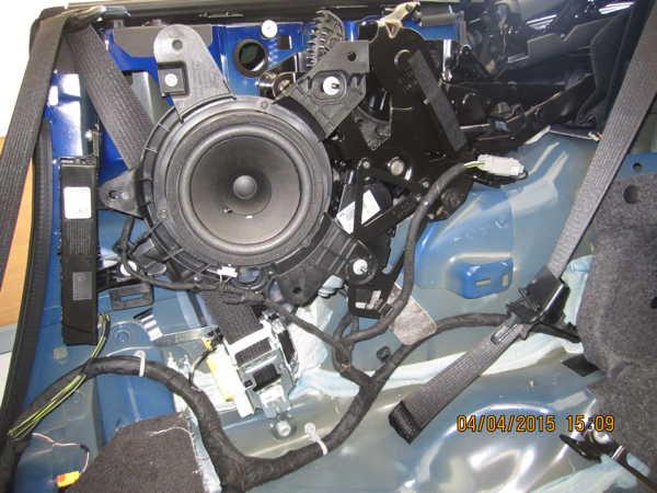

Below are some pics I shot while I was installing my CDC light bar. I did not have this thread in mind or I would have taken more appropriate pictures. But these give an idea for starters. Both the seat back and bottom cushions are super light. They are just foam and light plastic.
In the first pic, the hole just below '04/' is where the seat back's bracket extends down below the seat bottom (≈ 4"-5" IIRC). the corresponding hole in the second picture is just below the seat belt clip.
