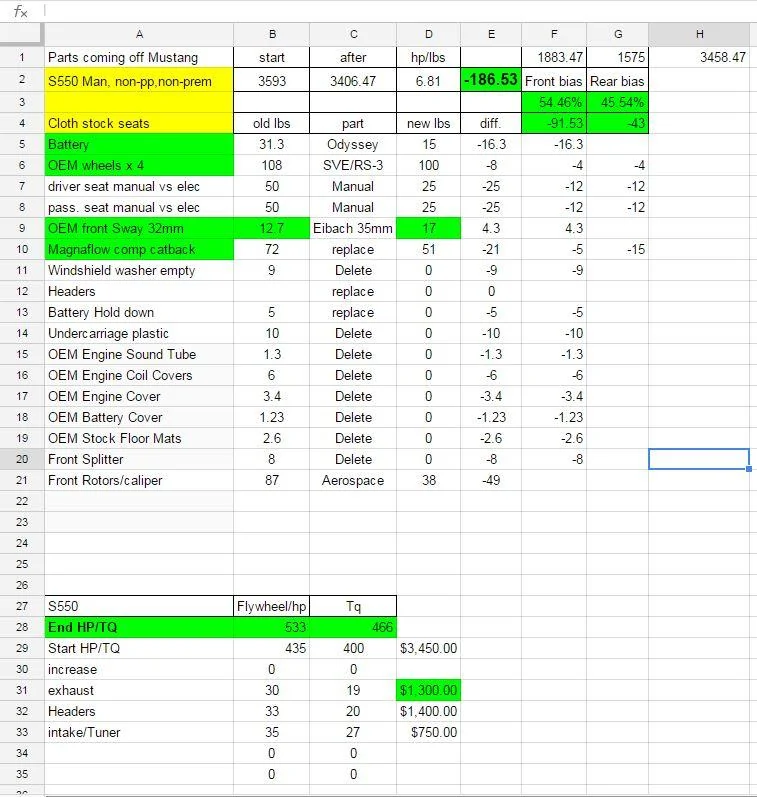

started a weight sheet, but haven't figured out how to embed it here yet. Some of the weights are still guesses. Here's a pic.

Stock numbers:
- Initial weight - 3,593 lbs with almost zero fuel, trunk junk out
- Stock Front Bar - 32mm
- Stock rear Bar - 21.7mm
- Stock exhaust - 2.5 inch
- Stock exhaust tips - 3.5 inch
- Stock Front Sway - 13.8lbs
- Stock exhaust weight - 72lbs should know by 2/28
- Stock 18x8" Wheel weight - 56lbs with Pirelli 235/50-18's
- Stock Power output - Didn't get done.
- Stock Battery Weight - 31.3 lbs (from someone elses weight)
- plastic undercarriage pieces and connectors - 7.0lbs
- Stock front strut - 18.8lbs
Mods:
Magnaflow Competition catback
- Exhaust weight - 51 lbs
- Tubing diameter - 3 inch
- Tip Diameter - 4.5 inch
- Power increase - ? Not sure when this will happen. Sometime after 3/1
Wheel/Tire/suspension
- SVE Drift 19x9.5 - Flat black - 26.8 lbs
- Eibach 35mm front Sway - 17.0 lbs
- Front strut with Eibach sportlines and maximum motorsports camber plates - 20lbs.
- SVE 19x9.5 drifts w/ 295/35-19 Hoosier A6 - 51.2lbs
