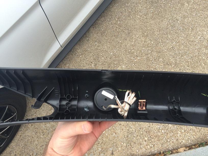

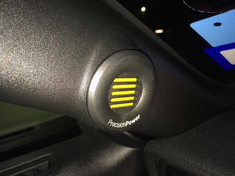

Here are some pics of my installation/wiring for my aftermarket audio stuff for anyone interested...
It all starts with this thing right here, the factory amp:

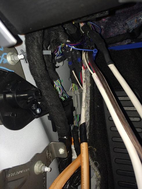

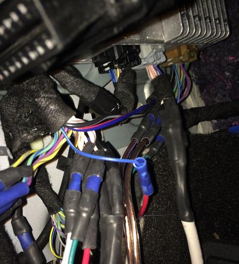

It's located up by the driver's side kick panel. The brown/grey plugs contain all of the amp's outputs to your speakers, plus the brown connector has a power cable(blue with red stripe), a ground cable(black with grey stripe), and a remote wire(small blue with white line).
For wiring, I snipped all wires except the power/ground wires on both plugs about 2-2.5 inches from the plugs(need to leave room to work with on the wire!). Then routed the front left/right/center channels to the ms-8 input. The ms-8 output routed back to the same area where I snipped the wires, and connects to the wires that lead to the speakers. Here are some pictures of all the connections up behind the driver's side kick panel:
For routing the wires, I used a combination of 2-conductor and 4-conductor wire. I then wrapped my wires in some stuff called techflex to bundle the wires together and make it visually easier to see which were output and which were input haha. They started under the kick panel...

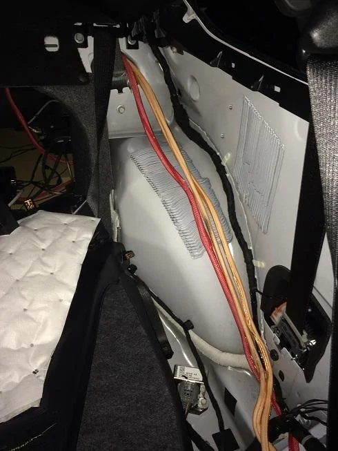

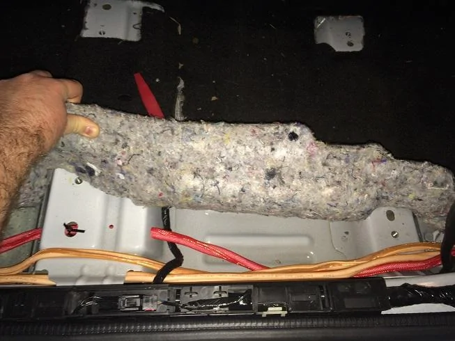

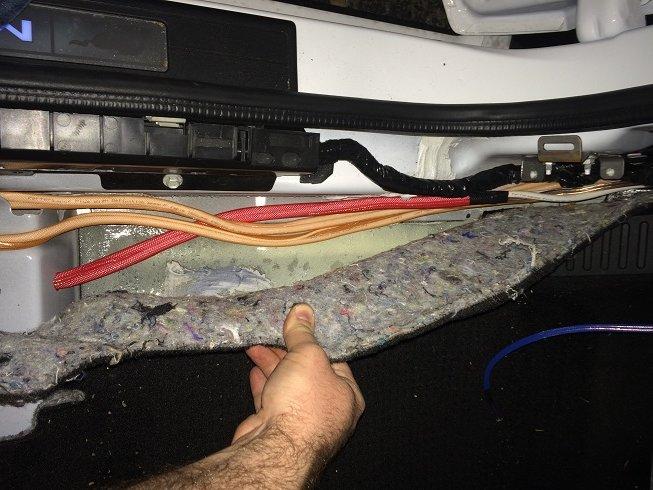

... and went under the carpet under the driver's side seat.

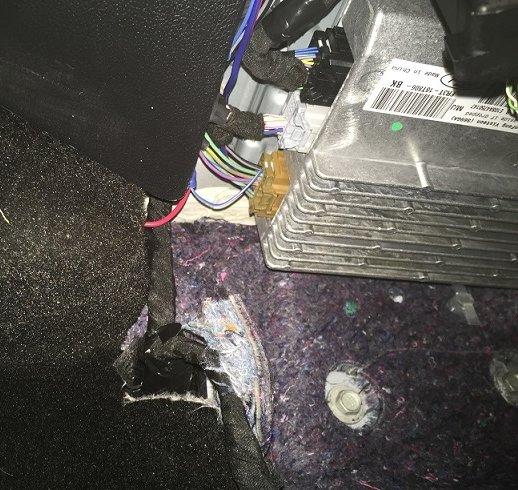

I had to pull out the seat and pull up the carpet to do it right. Wasn't enough room under the door sill panel.

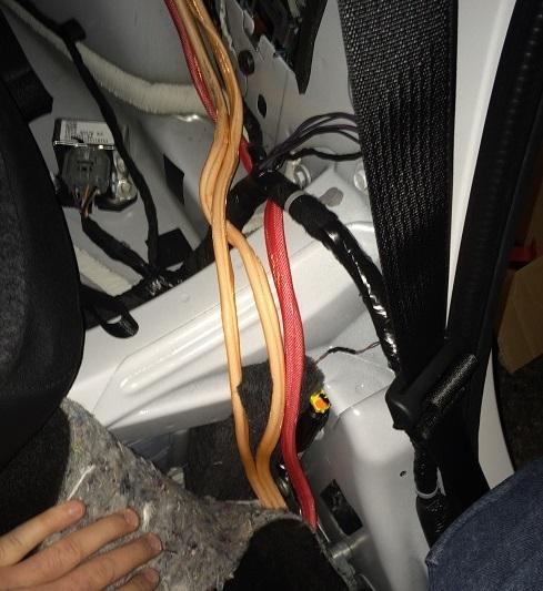

It comes out where the carpet meets the backseat and enters the driver's side rear panel

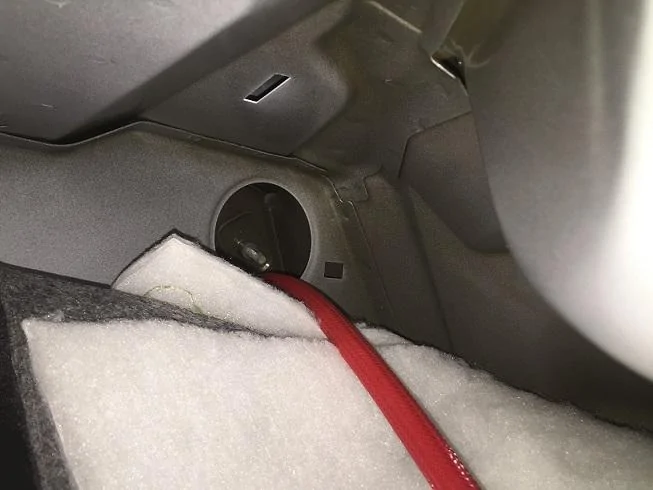

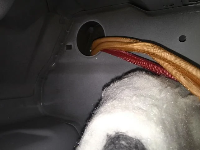

Then goes up under the rear side panel and through a hole where the seat belt feeds through
and finally out into the trunk...

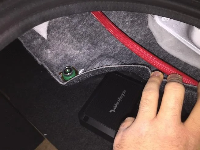

I routed the power cable through the passenger's side the exact same way, except I tucked that guy up under the door sill panel. I recommend trying to go under the carpet like I did on the driver's side. Made putting the panel back on a PITA...

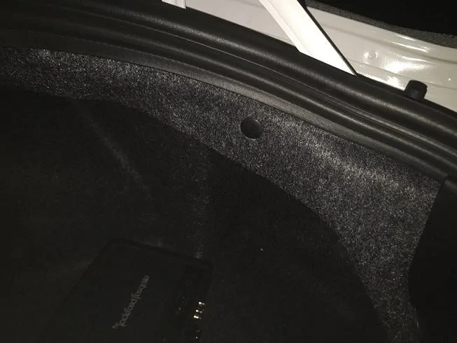

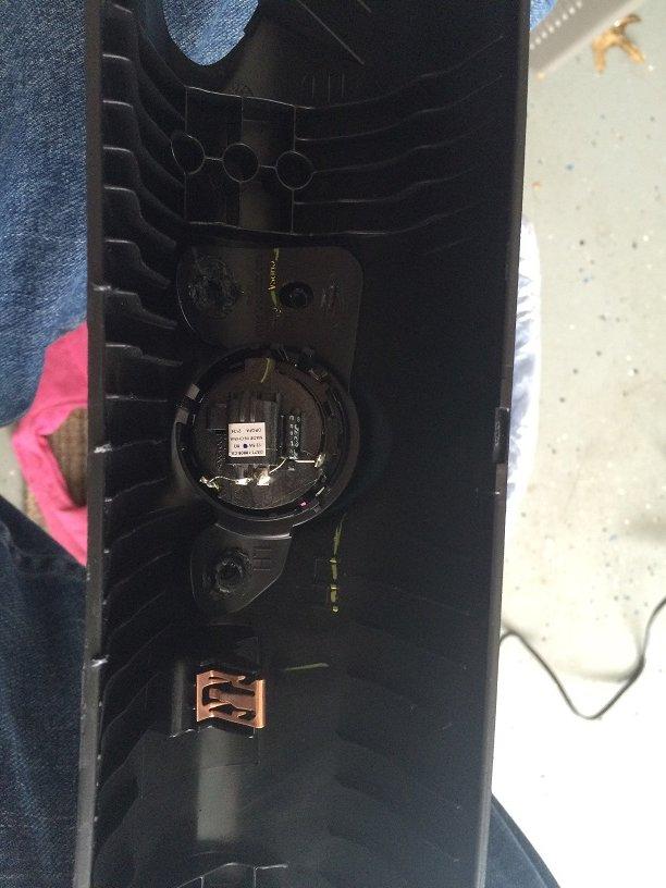

Getting access behind the carpets in the trunk is easy. Just pry up this little rivet thing...
Then all that's holding it up is this magnet thing...

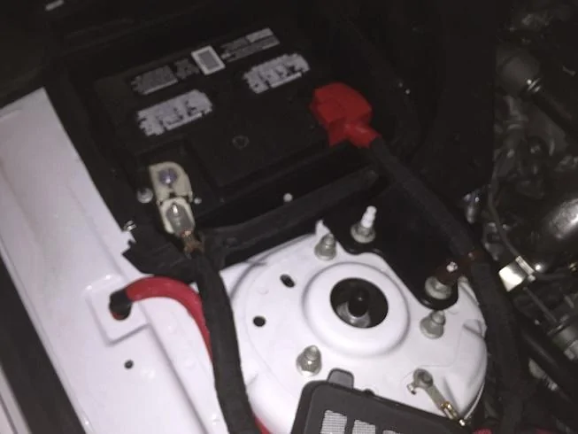

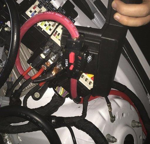

Meanwhile, in the engine bay...
I mounted a circuit breaker to the side of my fuse box and mounted my power cable to one of bolts in there. I will be honest, THIS IS NOT THE PROPER LOCATION FOR THIS(so don't give me a lecture, I know I'm being lazy!) Ideally it should be attached to the (+) terminal on my battery, but ford made the weirdest terminal I've ever seen so I need to change it out to mount the cable to it.
Also, credit to heinoceros because I totally used his idea for routing my power cable through the firewall, except I cut off the rubber nipple and routed through that. I need to work on that part again anyway, so I'll snag a picture of that sometime later too.

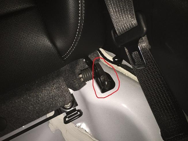

Last but certainly not least, the ground cable! I mounted it to the bolt holding down the springs for the folding mechanism of the driver's side back seat...
It then routes under the carpet to the same space where all of my signal wires are, and I cut a slit in the side of the carpet to route the cables to my sub amp and ms-8(tried to keep the sub amp ground as short as possible!).

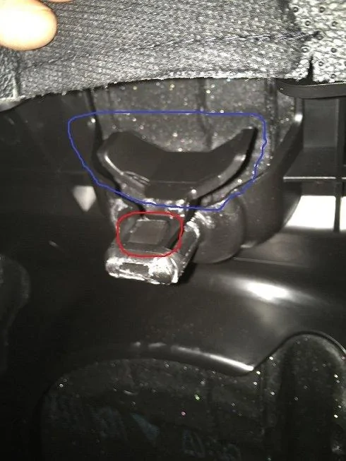

Taking out the back seat cushion is pretty easy by the way. There are two clips that hold it in place, one in the middle of the passenger's side, one in the middle of the driver's side. They look like this...
The red circle is the clip. You can push the lever circled in blue to release the seats. You'll feel it when you push your fingers under the seats in the middle of each side.

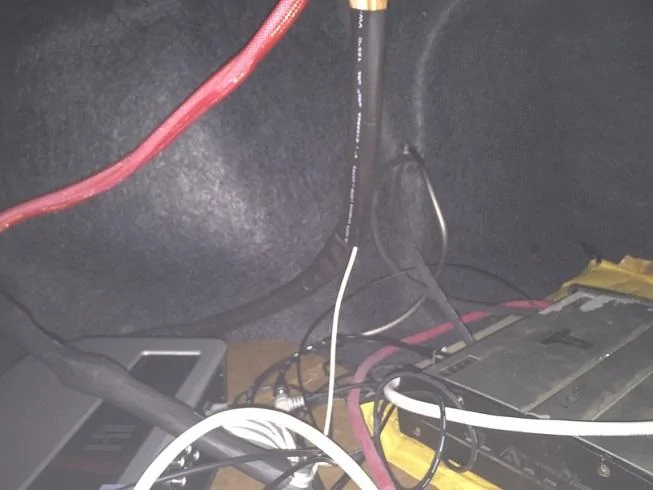

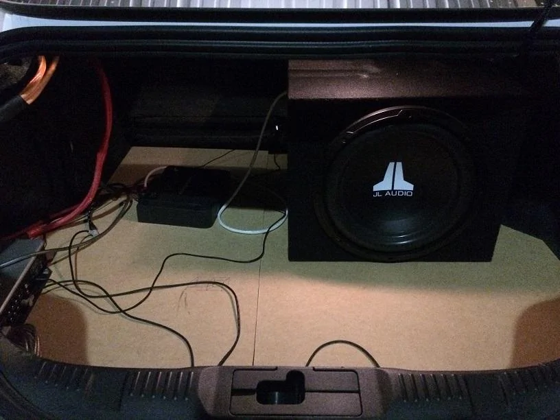

Here was phase I of my trunk. Complete mess with wires everywhere.
I'm going to re-route the ms-8 input/ouput cables as I don't like them just dropping in from the top. I'm going to cut a slit like I did for the ground cables. Plus, i'm going to get a 3/4" piece of wood cut out to fit in the trunk and have everything drilled down.

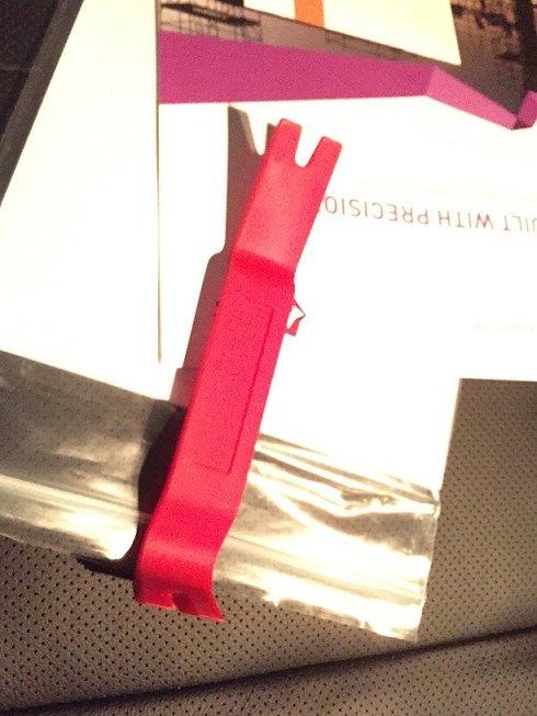

Tip, if you plan on doing this kind of stuff, get one of these!!
A kit will cost you like $15-$20, and it makes taking out these panels/rivets way easier, plus you won't break anything!
More pics to follow as I will be doing my speaker replacement in a couple of weeks along with my catch can and CAI replacements!!! Thanks for reading!!
