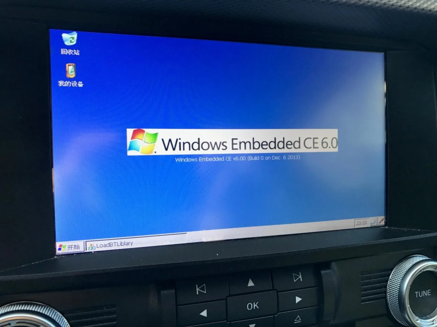

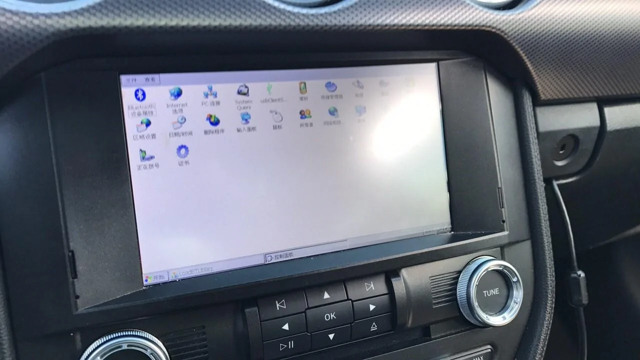

When I turn my car on. The unit goes to the WinCE screen right away. From there I am able to access the SD Card and choose the iGO maps and whatever else is on that USB. However, I am not able to play music or any sort. None of the buttons on the car works.
I have been reading about and autostart.inf file but I can't seem to find it.
I just want it to be returned back to normal and then updated it to the newest version that has been posted on stangatx.tk
I removed all files from the SD and installed the Orignal Unit Files from stangatx.tk but it still just boots up to WinCE. Any ideas on what I need to do to just get it back to normal?
I do try navigating the WinCE to see what settings maybe were turned off or whatever the case and its hard since it's in Chinese.
Any Assistance would be great!
Try a different SDCard (Make sure it flashes correctly). Also, Try to redownload it from the same or another computer.
