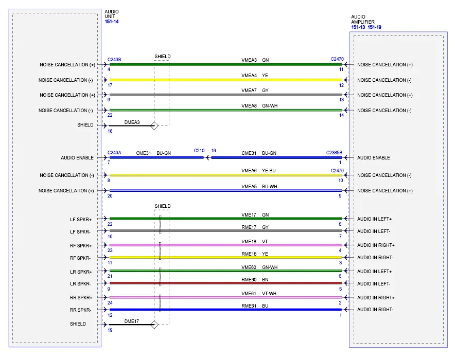

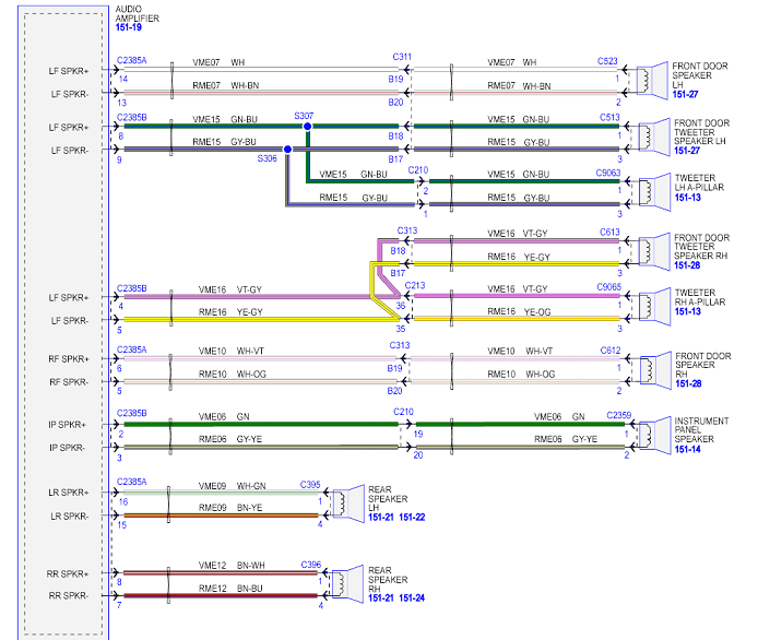

I found I had squirrelled these away on my computer, hope they help;
Head Unit to Amp
Amp to Speakers
Thank you. That is exactly what I was looking for. I found the amp out but could not find the head unit to amp wire diagram. Perfect!

Anyone know what connector is is for the tweeter? I want to revert mine back to stock but I snipped the wire if anyone can tell me the best way that would be great.
Not sure I follow your question... did you snip so close to the stock connector that you can't use a splice?

You can gain access to the rear deck speaker OEM wires under the rear seat in the large harness. Incase you don't want to pull the rear deck and tag high level at the actual speakers.
Nah I lost the connectors.
