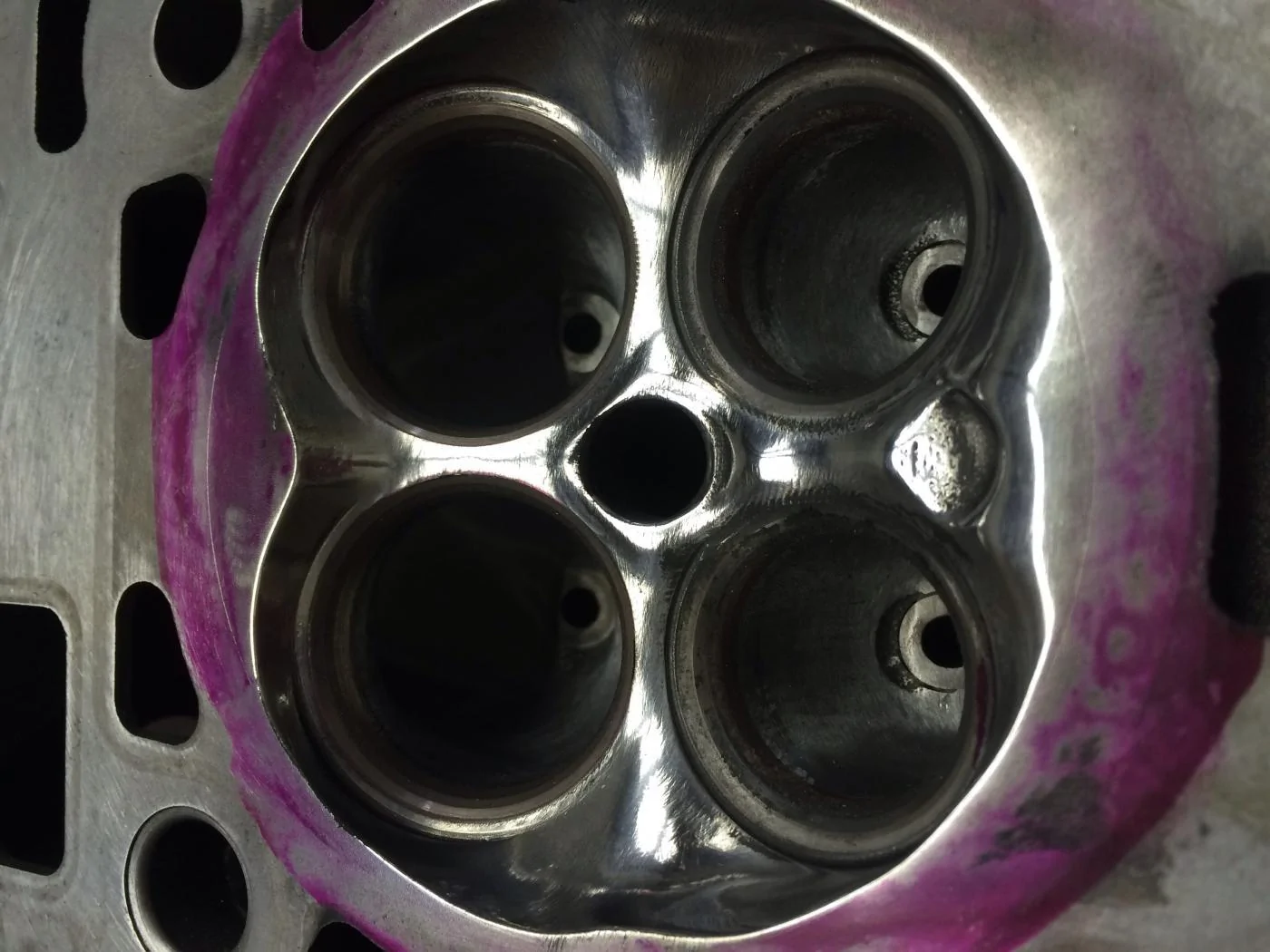

Well here's the problem on a gt350 mustang.They can be made to fit on a 5.0 with mounts or trimming the hood or aftermarket hood.
I still dream of an itb voodoo but i dont think anyone has done one.
1) The core support and hood are over 1" lower on a gt350 vs GT. No aftermarket hoods are available for a GT350.
2) The oil pan on the 5.2 is larger and deeper and you CAN NOT lower the engine more than 3/8" the clearance is only about 5/8-3/4" now. You do not want solid motor mounts on a 5.2 with flat plane crank. To many vibrations.
3) Nobody makes a set of cams for this kind of cfm flow on a NA motor.
