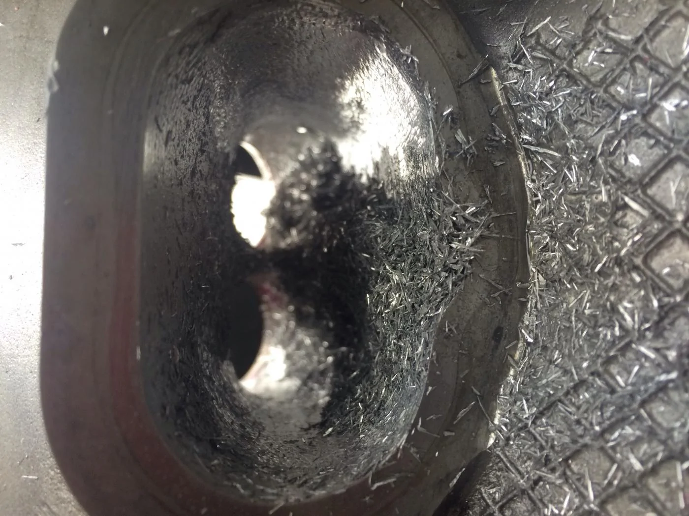

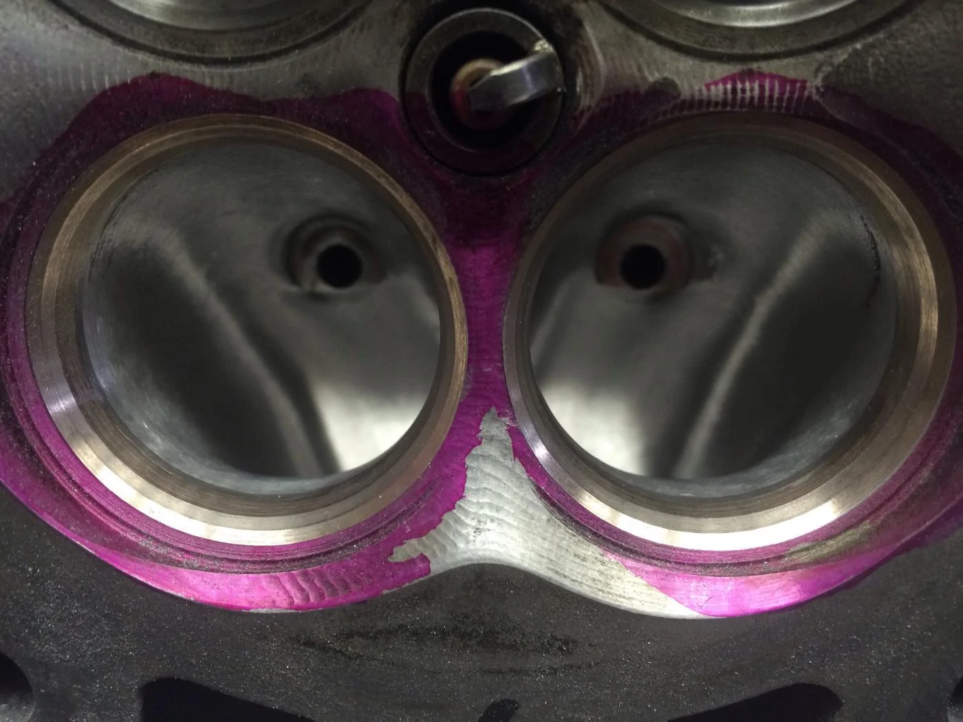

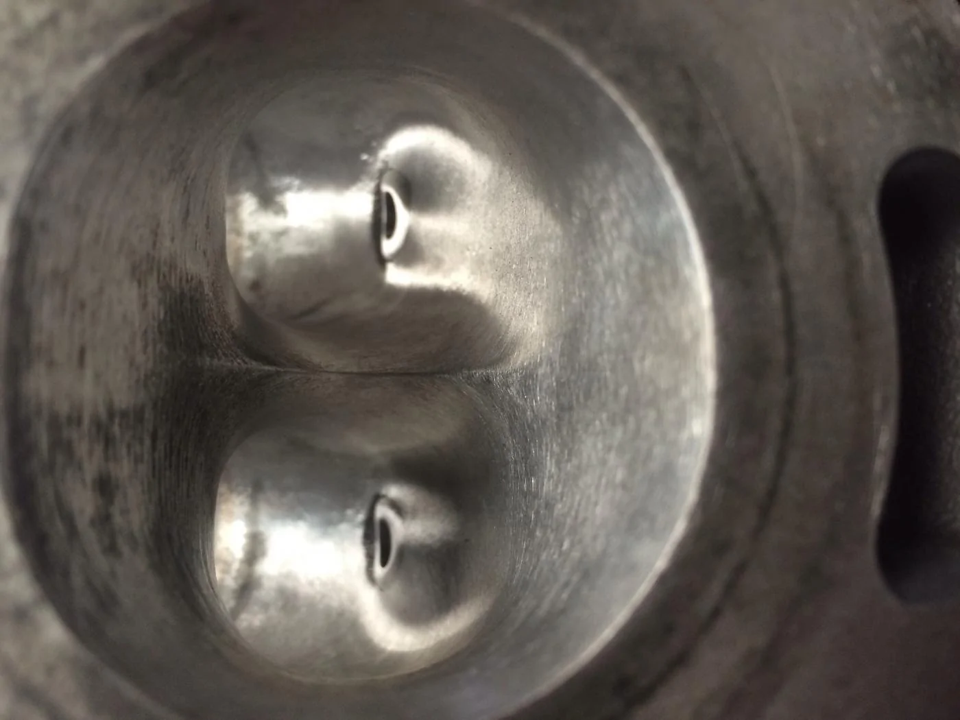

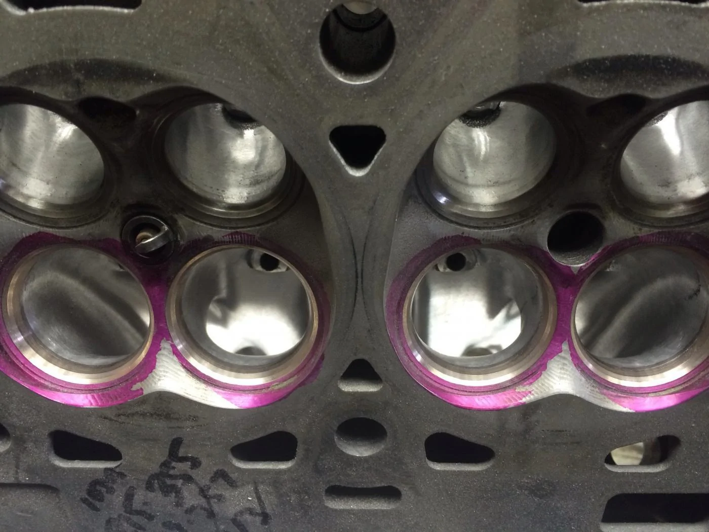

The exhaust is done. I could get more out of it of course but the current numbers are insane
So I've concentrated on the intake trying to fix what we're thinking is just s bad port job from who ever cnc programmed them
It's just hard to tell
As we sit the numbers have increased to 344 peak and the low and mid lift has gained cfm also. Here are a few pics
