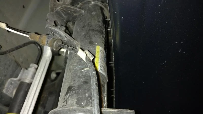

Without spacer the tires were very close to the strut. The little tire hairs are touching. It's around 3mm of clearance. This is all on a 2016 GT PP with completely stock suspension.
With 5mm spacers. Everything clears just fine.
With the 5mm spacer I couldn't get enough thread engagement on the stock lug nuts (only around 5 turns or so) So I had to go with longer studs too. 3mm was the largest spacer that I could go and still get bout 7.5 turns with the stock lug nuts.
Let me know how the 295s fit.

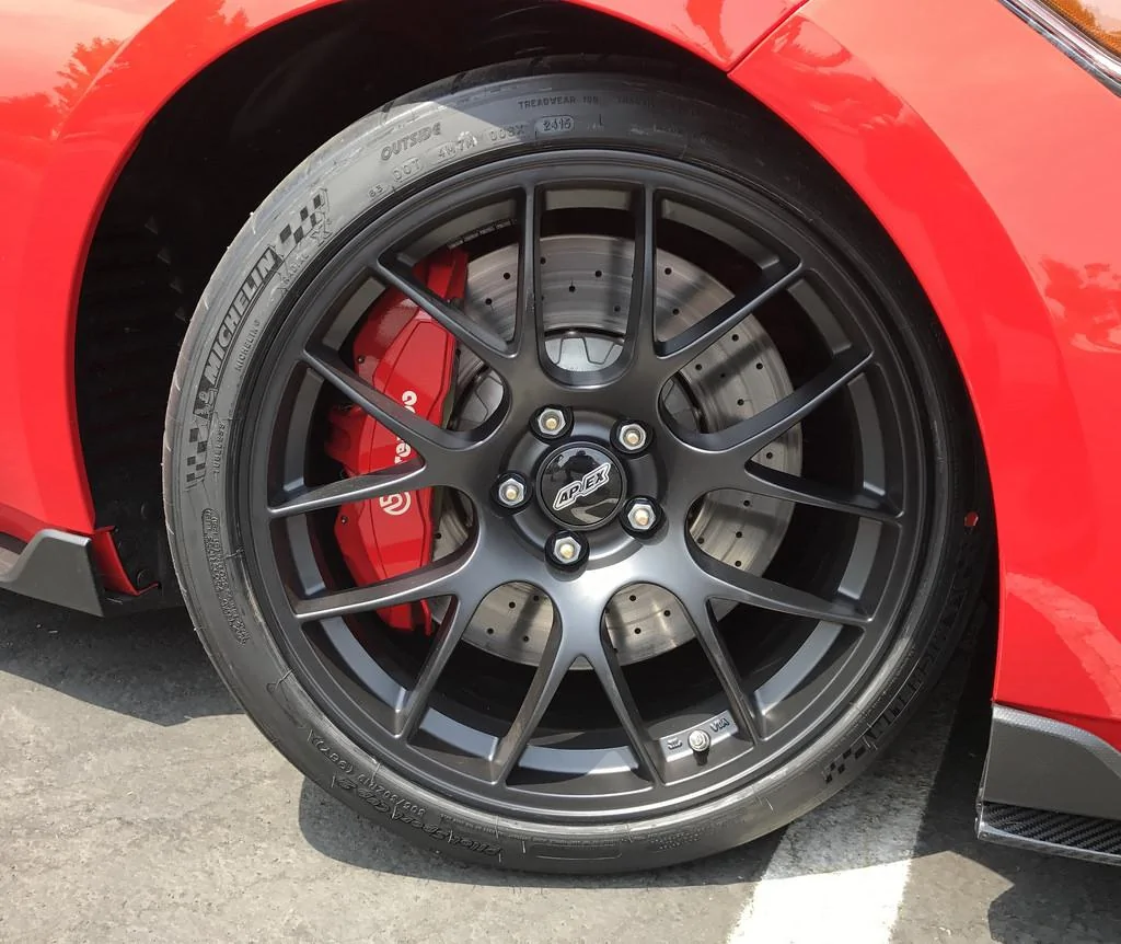

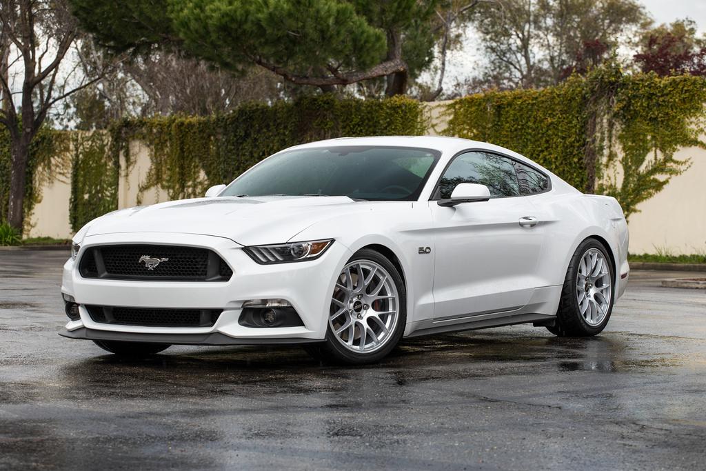

I'm strictly street. Will the Front & Rear: EC-7 19x10" ET40 - 285/35-19 Michelin PS4S give me the flush i'm looking for. I assumed that the ET40 offset would tuck too far under the fenders. Help a novice out!
This is a very popular fitment for the front of the S550 (and S197). The front wheels and tires will sit flush with the fenders :D Here are two examples of that exact wheel and tire size.

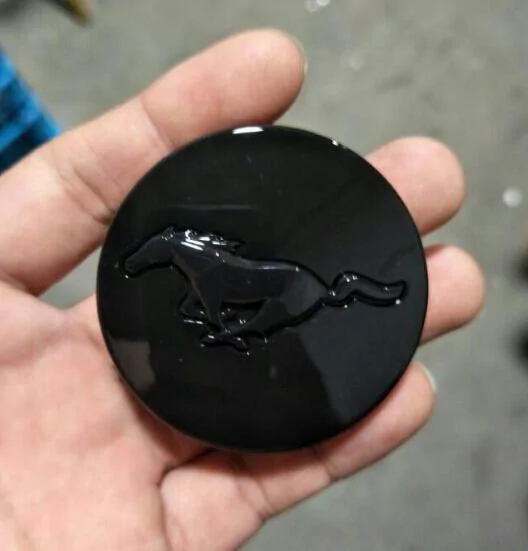

I would like to replace your company center caps with these aftermarket replacements (Diameter 2.125"/54mm) Will they fit?
I would like to pare your wheels with the Michelin Pilot Sport 4S 285/35/19
Lastly, Do the TPMS sensors you install activate automatically upon mounting the tires?...and do you offer the EC7 wheel in a gloss black finish with Black OEM lug nuts?
Appreciate your interest. If the center cap in question is made to fit the OEM wheels, than they will work with our wheels as well (our wheels were deigned specifically to accept the factory center caps).

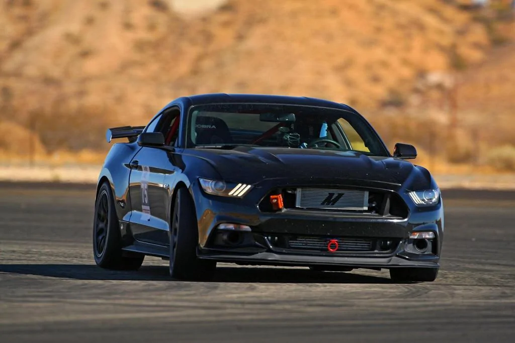

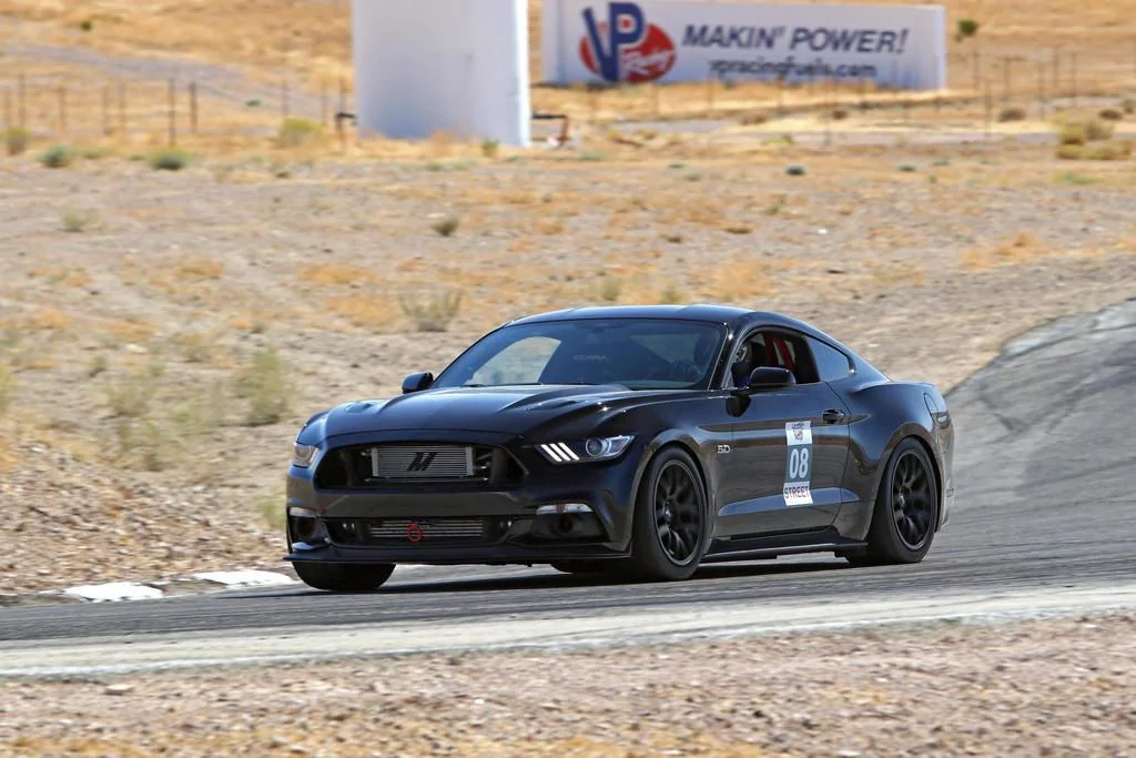

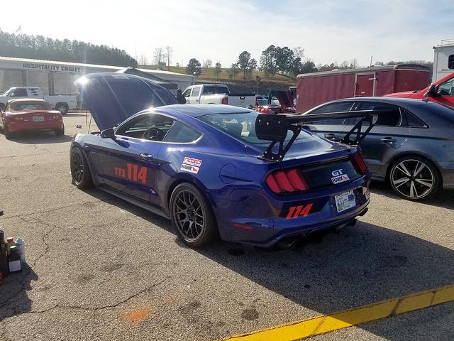

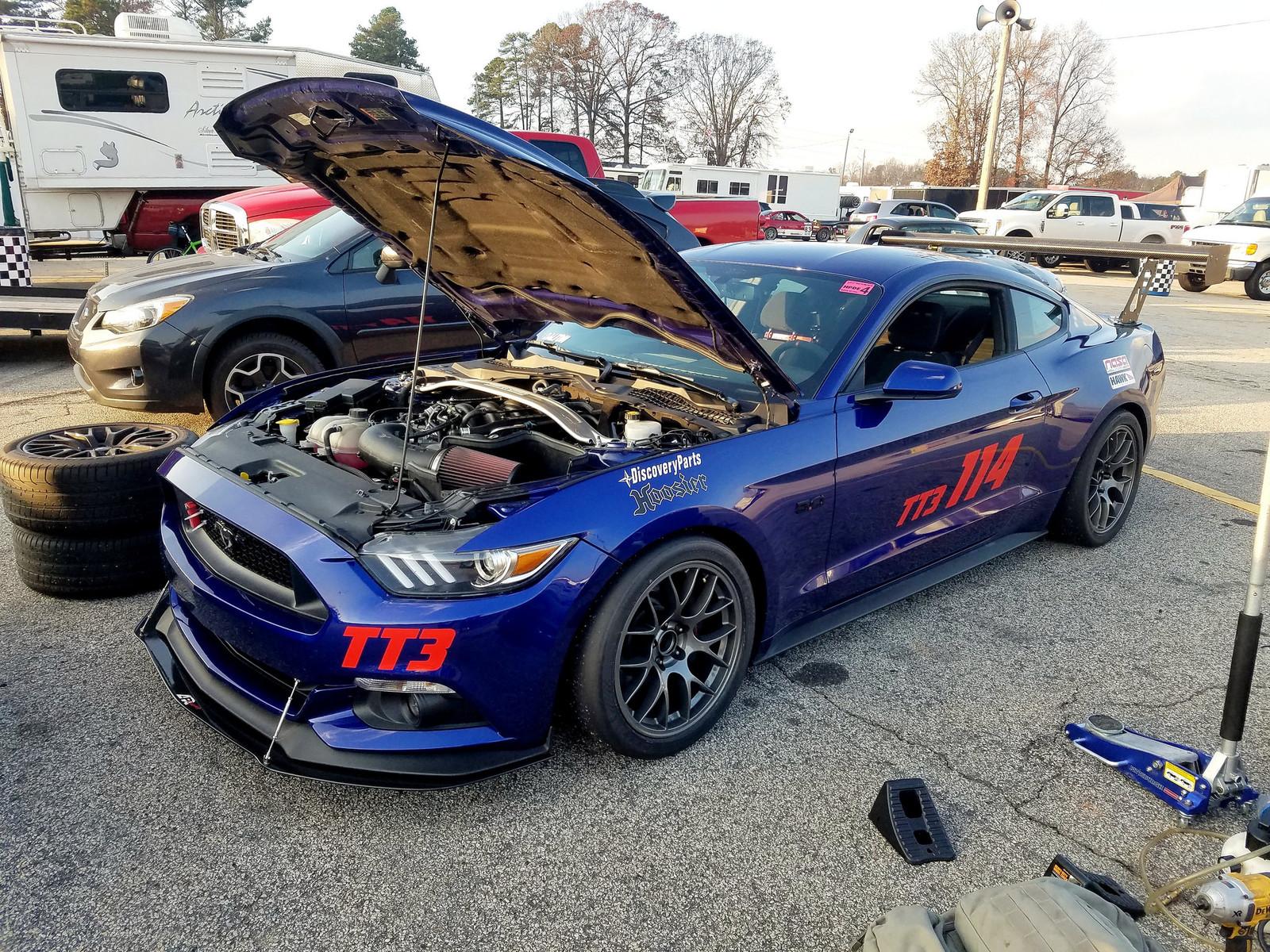

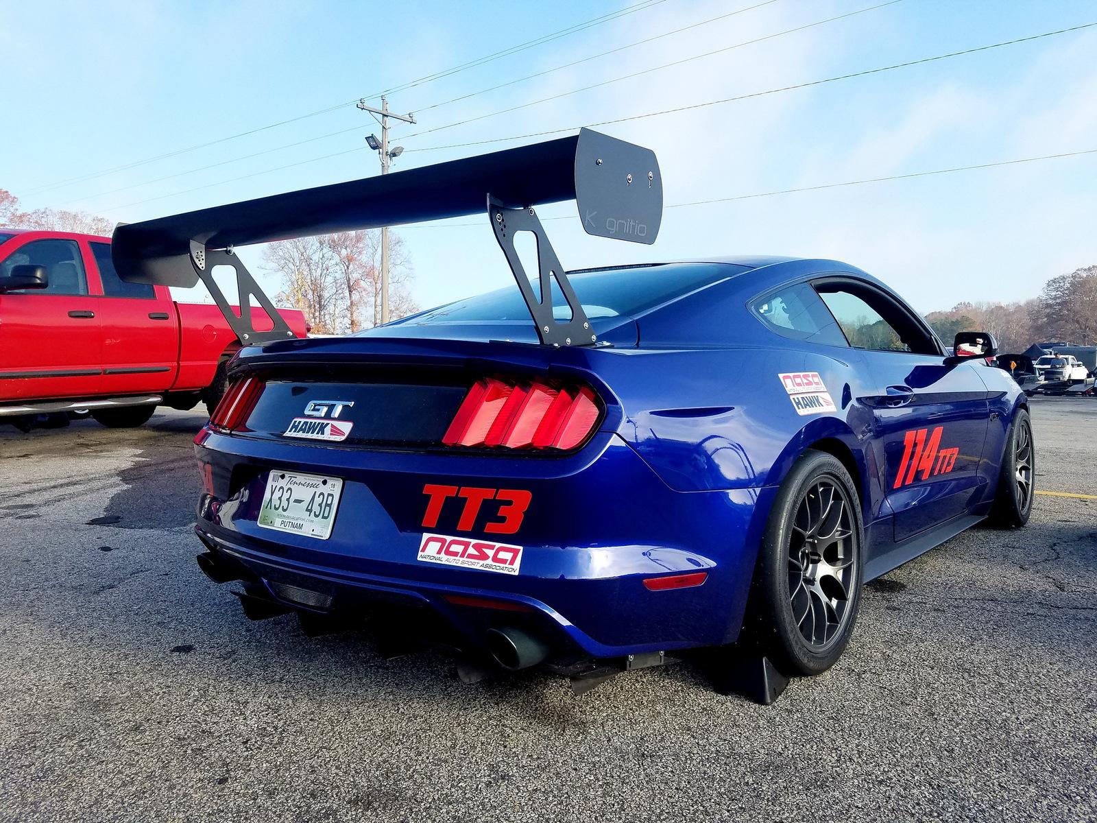

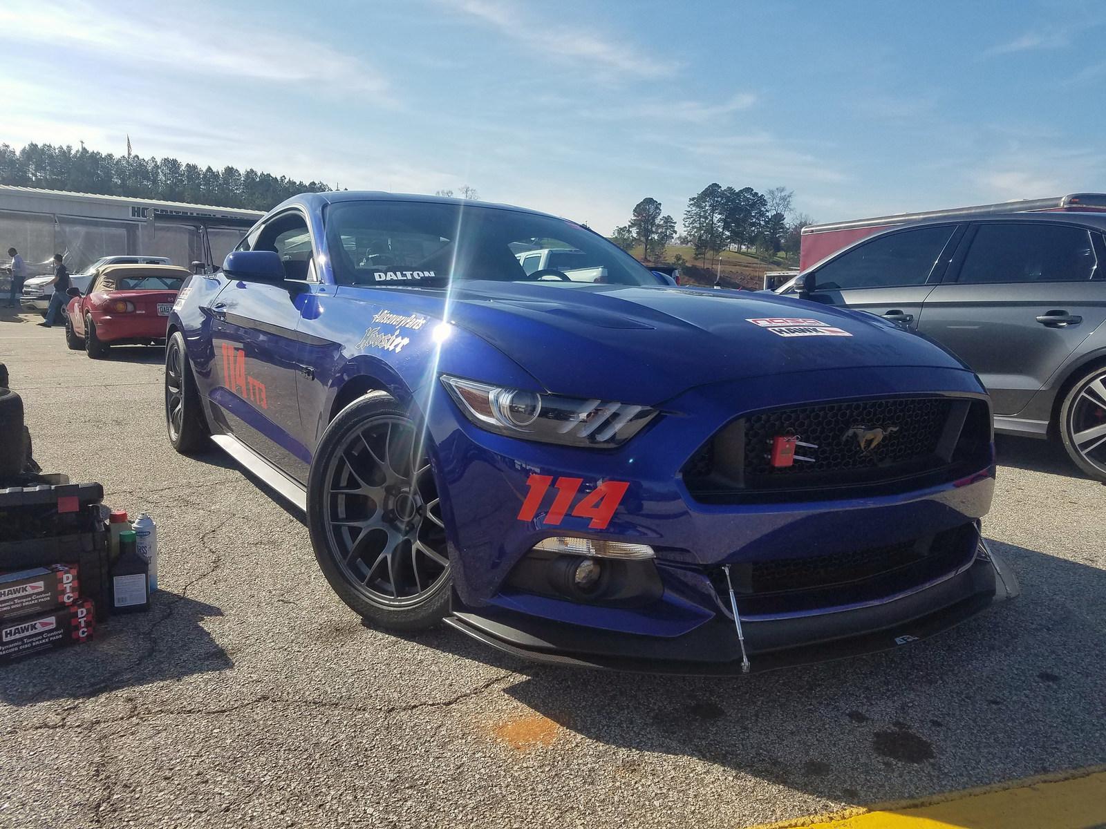

Good news! The 18x11 EC-7's work with 315/30/18 Hoosiers with a 25mm spacer. I have aFe/Pfadt coilovers. They have slotted upper bolt holes that attach to the spindle to get extra camber(I had mine pulled all the way in). I had to re-center the strut to keep them from rubbing. That equates to about 1 degree of camber loss(-3.5 compared to -2.5).
A few pictures from Road Atlanta this weekend with the 315's.
