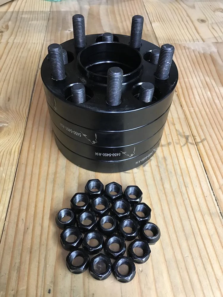

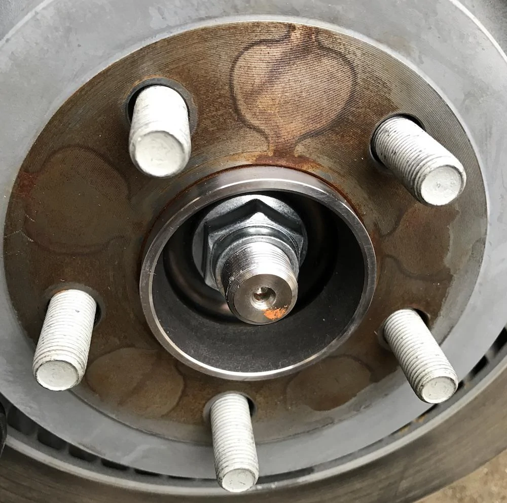

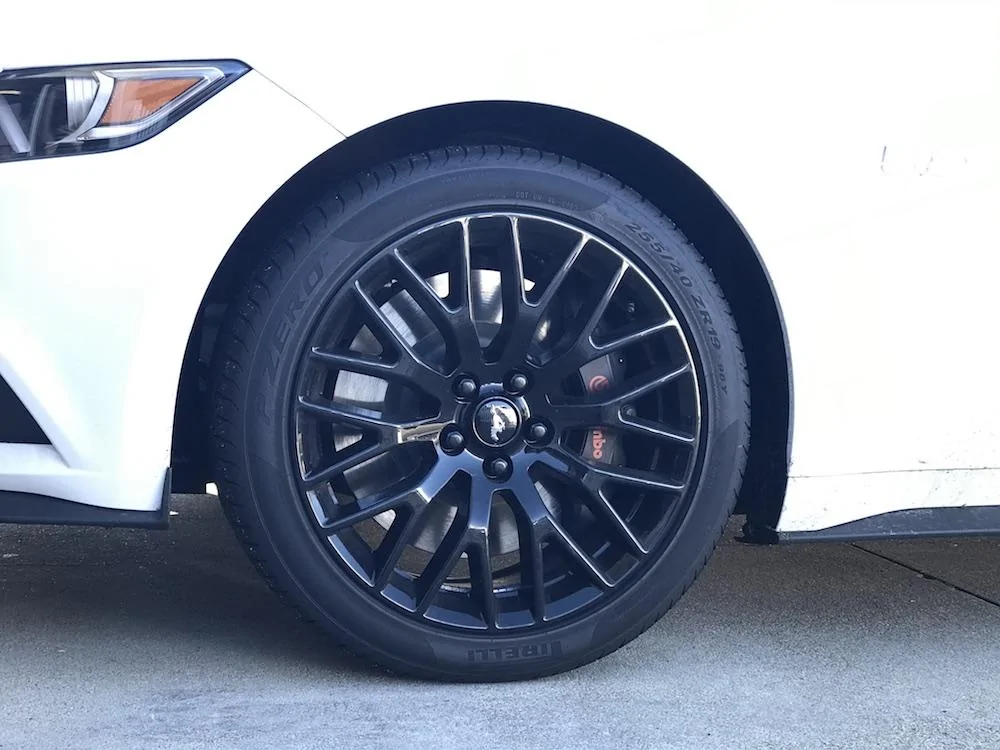

Installed the 25mm wheel spacers today

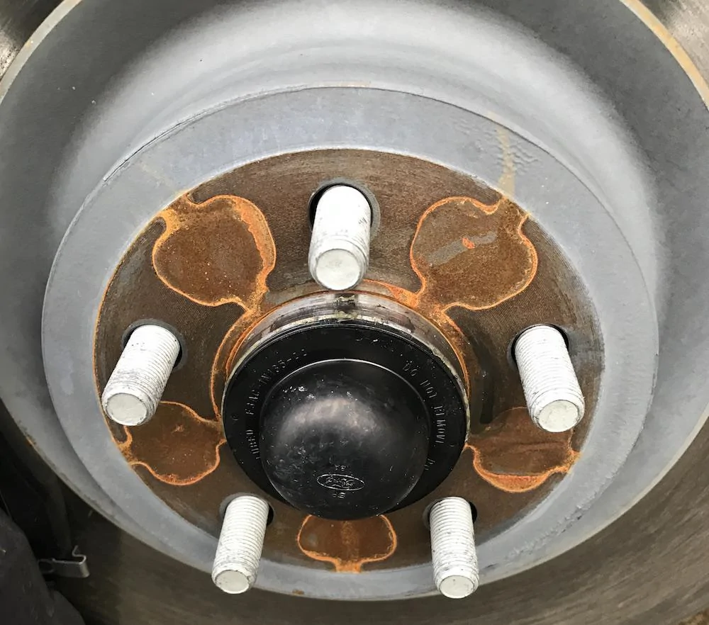

After removing the wheels, I saw all the oxidation on the rotors... never ceases to surprise me how quickly this happens. I have 1000 miles on my car! I definitely want to make sure that I have a perfectly flat surface for the spacers, so a little windex and 400 grit sand paper achieves the desired result.
The apprentice makes sure that everything is torqued to spec!
I want to put wheel spacers on all the things!
