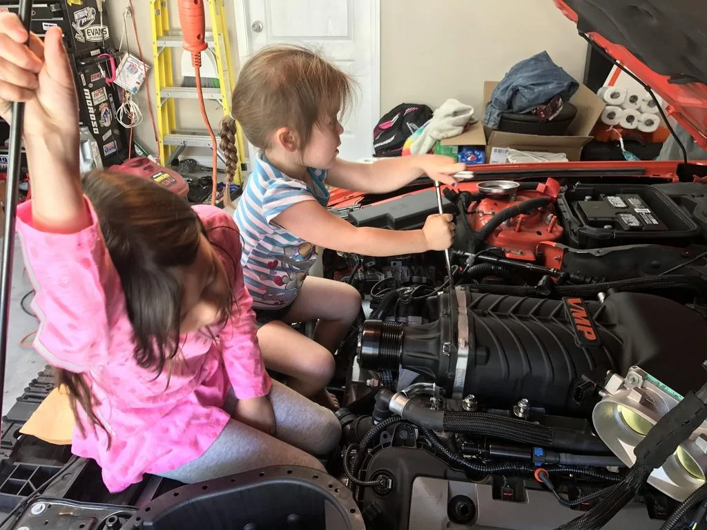

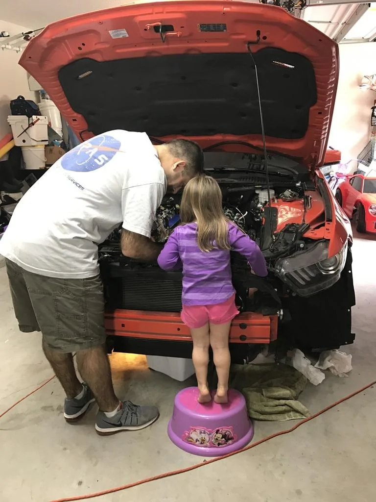

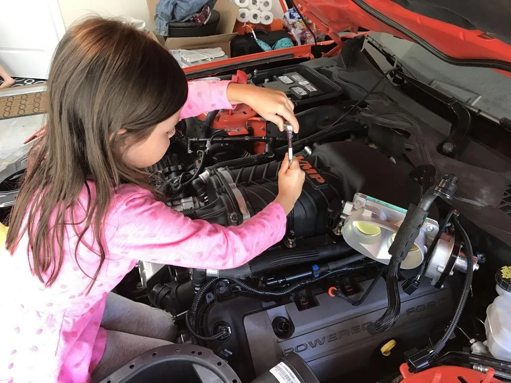

Saturday morning we got work! The install went pretty well. To be honest, it was kind of hassle going back and forth between three different set of instructions (one from VMP and two from Roush), but I got a system going and we knocked it out. I also installed OPG and CG at the same time. We would have been ready to fire the car up that night had we not ran into a major issue. After we bolted the lower manifold down it was time to change the plastic IAT sensor for the included brass piece. I don’t know what Roush used when they installed the plastic sensor but it might as well have been JB Weld. It was incredibly tight coming out and eventually broke. After removing the lower intake and vacuuming out plastic bits from the behind the intake valves, we got to work on removing the base of the sensor from the intake. We ended up having to drill it, disassemble the intake to clean it out and then tap the threads. Wouldn’t you know it, between my two tap and die sets, I didn’t have a 3/8NPT tap. By this time it was too late to get one so the final install would have to wait for the next day.
A quick run to Harbor Freight and we were back in business. The tap worked like a charm and the new sensor threaded right in. We finished up the install, poured some coolant in and uploaded the start-up tune: it was vroom time. Well, we thought it was anyway. Be sure to read the VMP instructions VERY carefully when installing the two wire harness extensions. You can install them incorrectly. Start attempt #2….SUCCESS! Well, sorta. The car started and idled great. However, it would not rev. Mind you, this is now Sunday afternoon. We went over the entire install again, checked wires, read wires, re-uploaded the tune, checked for vacuum leaks and couldn’t find anything wrong. Well, crap. Did I mention this is my daily driver and it was about time to use it again as such? I was a little nervous. There was nothing we could do except wait for VMP to open on Monday.

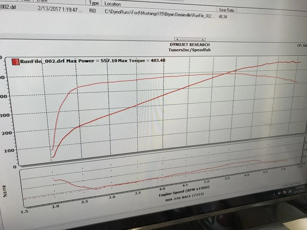

0901 I hit the call button. VMP answers and I ask to be transferred to Alex. He was busy at the time tuning a car and I was asked to email him. Not exactly what I wanted to hear, but I understand that I’m not their only customer. I email him and patiently wait for a response. To my surprise, less than 10 minutes go by and I get a response. We exchange a few emails to go over a few things and confirm there aren’t other issues and within an hour I have a new tune file to try. Bingo! Works like a champ. I proceed to send off initial idle and slow-rev logs and have a second revision that afternoon. What could be better!? This is starting off great. Over the next couple days I datalogged and received a tune update. For the most part, the car seems to be running okay. It was still new so I was either babying it or going WOT. You know how it is, you don’t start to feel the nuances of things until you get used to it a little. One thing I started to notice was that mild acceleration resulted in some weird drivability issues. The car would kind of “spool up” and then wasn’t smooth at all. I logged that and then took it to the local dyno to get some good WOT datalogs. I was very optimistic and had dreams of glory, but the disappointment meter did is job: 557rwhp and 480rwtq. Well, that seems low. You could see in the logs that it was pulling quite a bit of timing so it wasn’t all that unexpected I guess. I reached out to Alex on the phone. We spent a while on the phone talking about what was going on. We talked about what kind of fuel I was running and found that to be part of the problem. Secondly, we discussed the drivability issue. He said another customer of his was having a similar problem and they had the car in their possession to try to get the kinks out. He asked for a few days to do so and he’d get back with me. I was getting ready to leave town on a trip for work anyway so it worked out perfectly. When I got back, I contacted him to see what progress he’d made.
His next email included an entire new base map that we would start working with. I uploaded the new file and you could immediately tell it was better. A quick drive around town confirmed that the part throttle issues were fixed. We started with new idle and slow-rev logs and eventually more WOT logs. Everything was on track and looking good. The car felt better on the street and I felt it was time to take it back to the dyno. Well, I was absolutely shocked with the results……540rwhp and 490rwtq. Wowsers! Even less than last time. Again, the car was pulling timing and obviously not happy even after solely running good gas (BP) in the car.
I was pretty discouraged at this point. I felt like I had wasted money going to the dyno and wasn’t terribly happy. Who would be!? I had honestly considered letting someone else tune the car. I did my best to remain patient and understanding. They had taken care of me to this point and they deserved the chance to make things right. I sent Alex an email with the dyno sheet and the logs and in VERY short order, I received a phone call from him.
He could tell I was frustrated, and he was too. The car shouldn’t be that low on power. I will do my best to quote Alex here. He said, “Here’s what I want to do. I’m going to send you a new tune file. The only change I’m going to make is the change from global KR to individual cylinder KR. After I get back from TX 2K17, I want to offer you the chance to bring the car to VMP, we’ll put it on the dyno and if it needs any adjustments I’ll do it right then and there: FREE OF CHARGE. The car should make right at 600rwhp and you are owed that.” He made that offer on his own with zero probing from me. How can you argue with that!? Within 15 minutes I was uploading the new file and went for a test drive. Night and day difference. So this past Sunday I sent out another email to Alex and we agreed to meet first thing Tuesday morning.

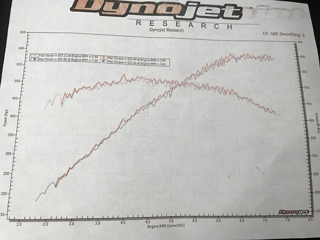

I pull up to the shop first thing yesterday morning and am immediately greeted by Alex. He pulls it straight on the dyno and gets it strapped down and the car made 607rwhp and 529rwtq and backed it up with a 605/522 pull. Keep in mind that’s after a two hour drive and not touching the tune, all on a base Stage II kit with twin 60mm throttle body, airbox lid ON, 82mm pulley and 56# injectors. What more can you ask for? The car feels awesome on the street. My wife literally says it takes her breath away. Traction is an issue. I need to get that worked out. The stock Pirellis aren’t happy, even in third gear.
