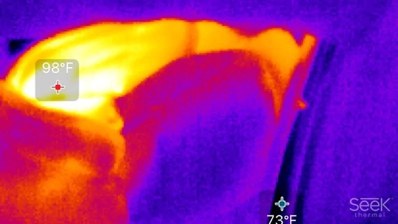

Well, I sort of provided some info about this in a post on the prior page regarding using the a/c from the floor only. I don't do much driving when the car has been sitting directly in the sun and is at maximum temperature, so haven't been able to test that. But, the car is still plenty hot when I drive home every night even though it's been sitting in the shade awhile.My biggest problem is getting in a car that's been closed sitting in the sun all day and the inside of the car is 120° or so. At that point I only get burning hot air out of the seat back because it's already heat soaked.
On a normal morning say around 70 or 80° my seatback will cool but not very well.
So my question is this. Will this modification overcome a heat soaked seat at the end of a hot summer day and provide cooling to your back when the entire seat is 120° through and through ? It appears you live in Phoenix so I bet you experience the same thing.

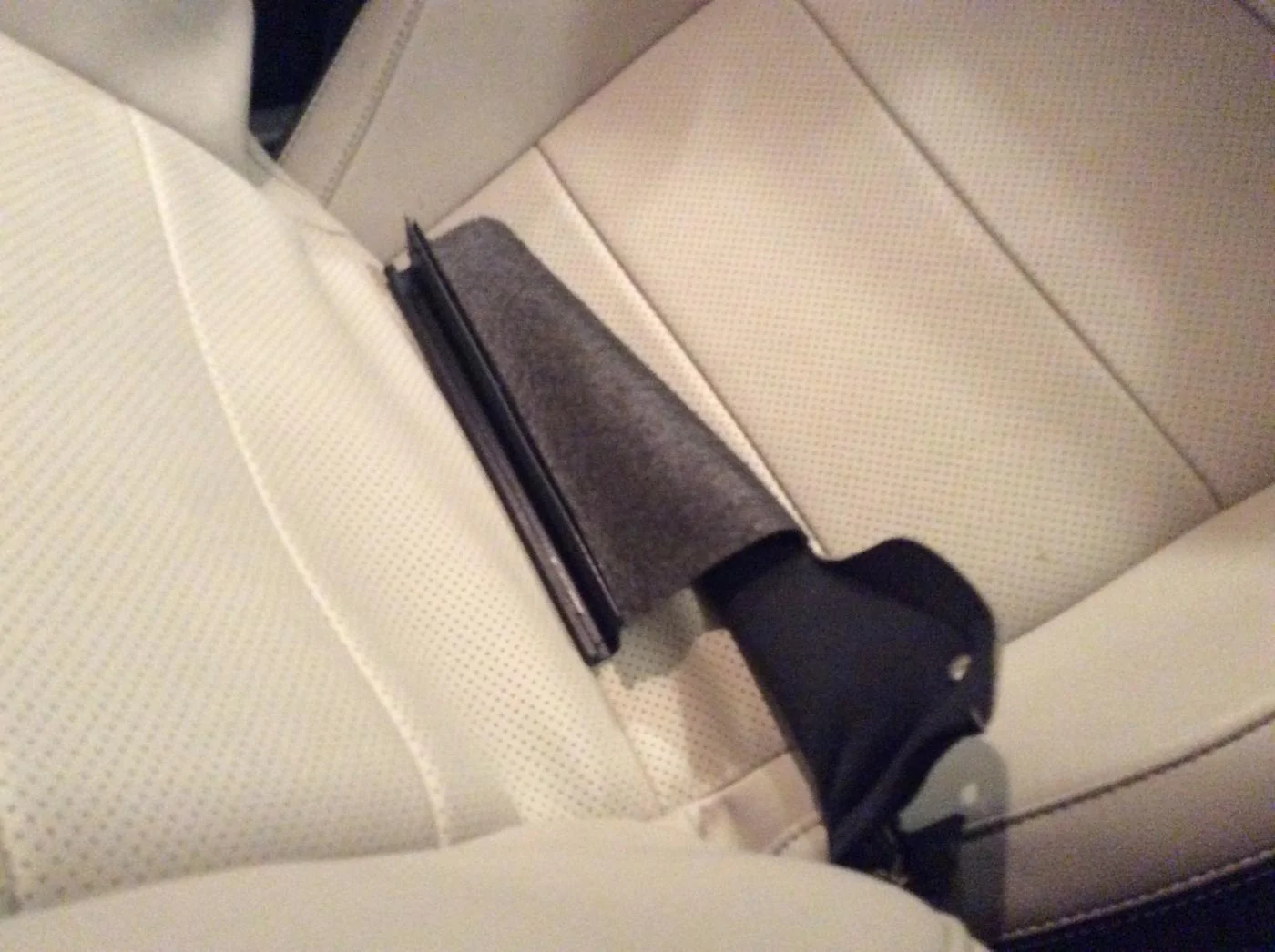

Thanks for the info. I thought that some of the TSB units likely would have made it into 2016 models, but had info from folks with later build dates than yours that indicated they had the original blower.BAD NEWS FOR GT350 TECH PACK OWNERS
Build date on my car was 3/27/2016 and it shipped with TSB updated blower (sock/straps present). So if your car was built early this spring you might be SOL.
I don't know about EB/V6/V8 cars though.
