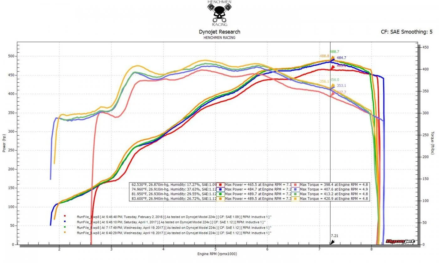

Well I debated doing headers for quite sometime because no cat back sound fit my ear, but I decided to bite the bullet and do it a few weeks ago. Me and a buddy installed the kooks with catted x pipe and it absolutely gave me the sound I was looking for, love it. I drove the car for a few days, monitored afr's and debated doing a tune. I figured what the hell, I came this far might as well go all the way. I had already done a base pull on the dyno on 93 so I already know what the car made stock 465/398 sae. I decided to get a 93 performance tune so I started email/logging process. After the revisions were done, the car felt like it pulled harder and still drove great. It did 485/407 sae on final tune. After a week, I decided to get back on the dyno just to see what the numbers were (all pulls were done on the same dyno in 5th). The only thing I added to the equation was a fuel additive. I strapped the car down and made a pull 490/420 sae with headers, additive and tune. I then reverted back to stock tune, let the car cool and made another pull 490/413 sae. So as you can see, the additive was worth 5 hp/trq and there was no positive knock on the log with stock tune. The car with tune picked up torque/hp across the board, the peaks are just the same. I can feel the difference but I am going to do a comparison at the track or with the cars accelerometer as I think there will be a noticeable difference.
Analyzing other graphs (yes I know all dynos are different) the gains from just a 93 tune versus just headers no tune are close. The other graphs I'm referring to have been in numerous threads on this board. All in all I'm happy I made these changes, I just wanted to share my data with you guys. The only thing left to do now if I choose is corn, which I know will bring big gains. Here's a graph below with all the pulls and the color details are: Red - Stock....Blue - Headers, no additive, stock tune....Green - Headers, additive, stock tune....Orange - Headers, additive, tune....

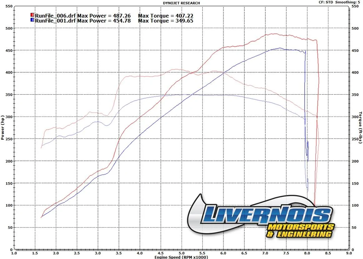

One example...yes its std but they are close to sea level, so still a good comparison
