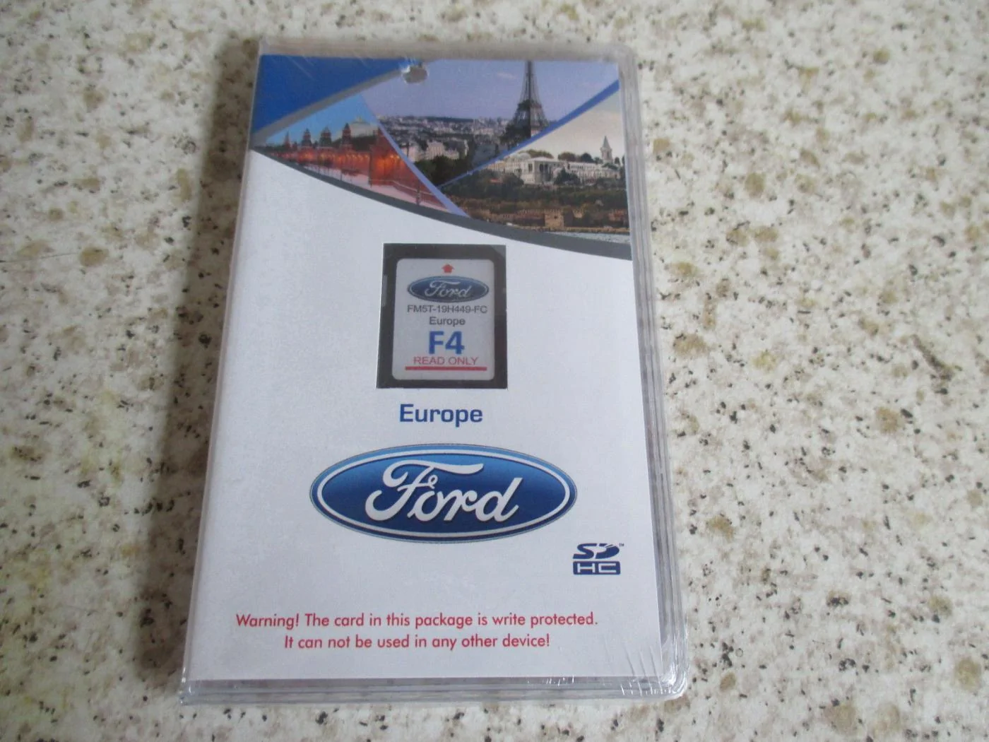

- F5 SD card for Maps (Nav only), some come with F4 (out of date) - Ask your dealer to upgrade this. NAV/SHAKER pro pack only. Comes in Center Console / arm rest SD Card slot
