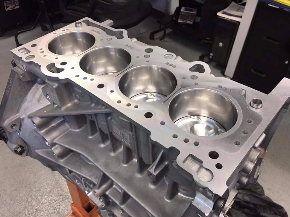

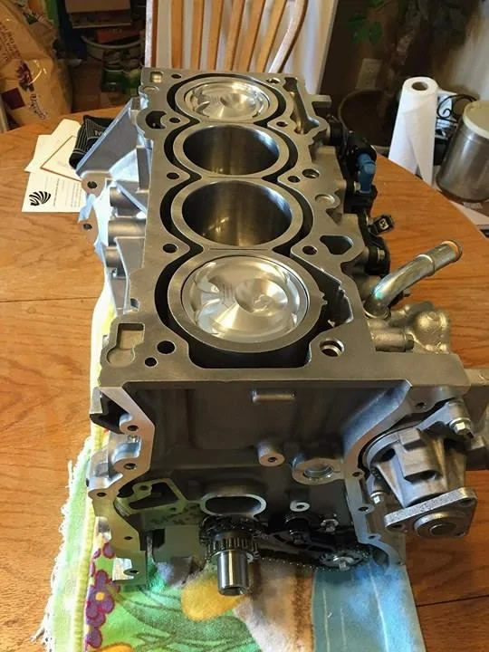

Mine let go pretty similar to yours [MENTION=23464]Woodshop77[/MENTION] - 7 holes in the block, lol.
My built motor was from Tune+ and included the CSS treatment, like [MENTION=21658]perfweld[/MENTION] mentioned. There were also a few other tricks of the trade completed, as per the specifications of the engine builders at Tune+ / MAP, but I couldn't talk overly intelligently about those, as it's over my personal pay grade.
Here's a few motors for you to see what the CSS looks like. First photo is w/o the CSS completed, the second one has the CSS done. The Honda guys making big power in their 4-cylinder turbo applications have been doing CSS for years, and making well over the target HP number I'm searching for. So that's why I opted for including it instead of going to a full sleeve. My understanding is that to do a full sleeve on these motors is quite a bit more laborious and intrusive.
Hope this helps brother.

Forgive my lack of intelligence. What's CSS?

how is that installed? Did you do that or do you send in your block?

In your opinion is that better than getting a shorty that has that done like from MAP or Esslinger?
6 one, 1/2 a dozen the other.
Any vendor that's selling the consumer the block with CSS completed, they're 99% likely to be using that exact vendor for the work.
