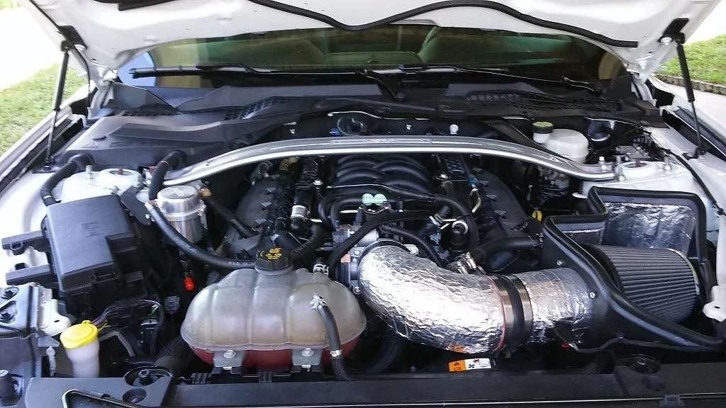

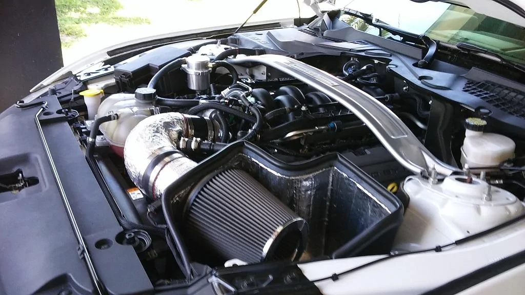

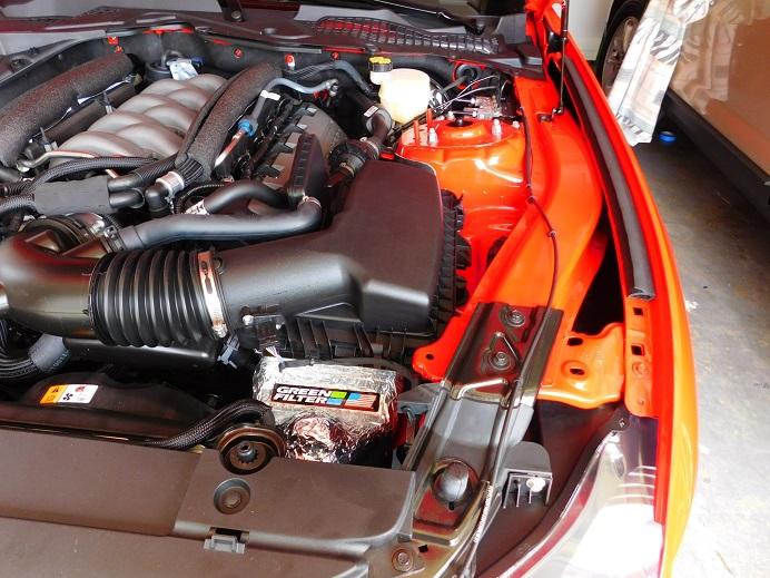

Exactly. Because people like Hot Air Intakes and will buy them. So they make money by offering and selling those "cool" parts (pun intended).Ford Performance chose an open design as well as Roush. Is their hood seal better than others? I don't know. Anyone see different temps with those designs?
My friends Roush Stage 3 has much higher IATs from their "Phase 2" Hot Air Intake, when driving it, despite it making more power on the Dyno over the original closed airbox. I wish he dynoed the car with the hood closed with both intakes, but he didn't. That would better simulate how each intake really takes in air, however no one does it and an open element will almost always make more power with the hood open on a Dyno over a closed box. But hey, it looks cooler and all people care about is looking cool and making more power on a Dyno, even if they're slower on the road.. but you can't measure that so it's not a concern, nor does it sell parts one way or the other.
