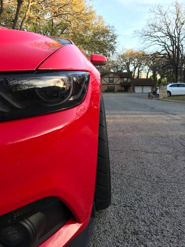

This looks just right. I think I'm going to go this route with the SVEs in 19x11.Front Spacer: 20mm
Camber: -2.8°
Clearance to Strut: 4.5mm
Camber Bolts: No

All the specs are in the first post, and even right above your post...I am wanting to do 19x11 SVE gt350 with a 305_35_19 MPSS. Do you think that would fit with the 20 mm spacer and say -2.0 degrees front camber?
Just trying to confirm because the tire sidewall will be different than what was tested, and I think MPSS run a little wide so I was thinking 25 mm might be safer bet.All the specs are in the first post, and even right above your post...
You'll need extended studs and open lugs.
Yeah, if you are running camber bolts then 20mm spacer probably isn't going to work.Just trying to confirm because the tire sidewall will be different than what was tested, and I think MPSS run a little wide so I was thinking 25 mm might be safer bet.
