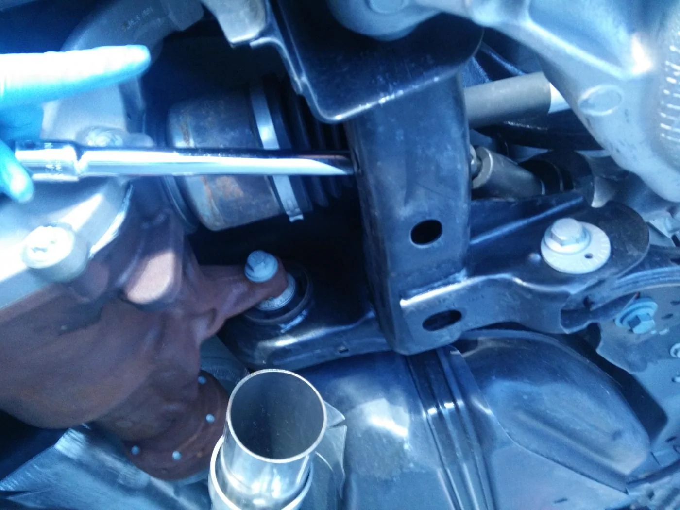

1QwkEcoBoost and myself used this guide to install a pre loaded set of control arms on my car. Overall this is a great guide, just needs a bit of clarification in the removal of the inner rear control arm bolts. We didn't remove the exhaust at first and tried to work around it, but the swivel was at a bad angle and we could not exert enough force on the bolt to get it out. I recommend removing the exhaust, and putting the swivel and extension in next to the half shaft (pic below). Also, I recommend removing the strut entirely and jacking up the hub as high as it will go to gain some more clearance when reinstalling the arms.
[MENTION=10281]BmacIL[/MENTION]
This is what I was telling you about having to bring the knuckle and half shalf to their upmost position to gain tool clearance.

Haha it will make more sense once you see it in person, there is more than one way to reach that bolt. We were able to get the tool in around the half shaft without jacking up the hub, but raising the hub does increase the clearance.

Doing this job right now for a forum member's car, just finished installing both lowers with the BMR bearing and am about to start on the toe link bearings on the knuckle here in a minute. Both guides were very helpful for the job. I used a combination of wobble extensions for the LCA front bolt while jacking up the unbolted knuckle with axle shaft to gain clearance. The extensions went through the subframe opening for the axle and was a fairly straight shot. It helps that I have a lift and pair of screw jacks at my disposal. I would definitely not do this job at home without a qualified extra pair of hands. I started about 9:30am and it's a bit after 3pm now minus about an hour for lunch and various interruptions.
