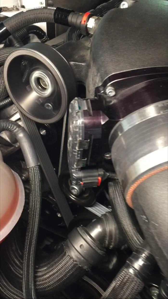

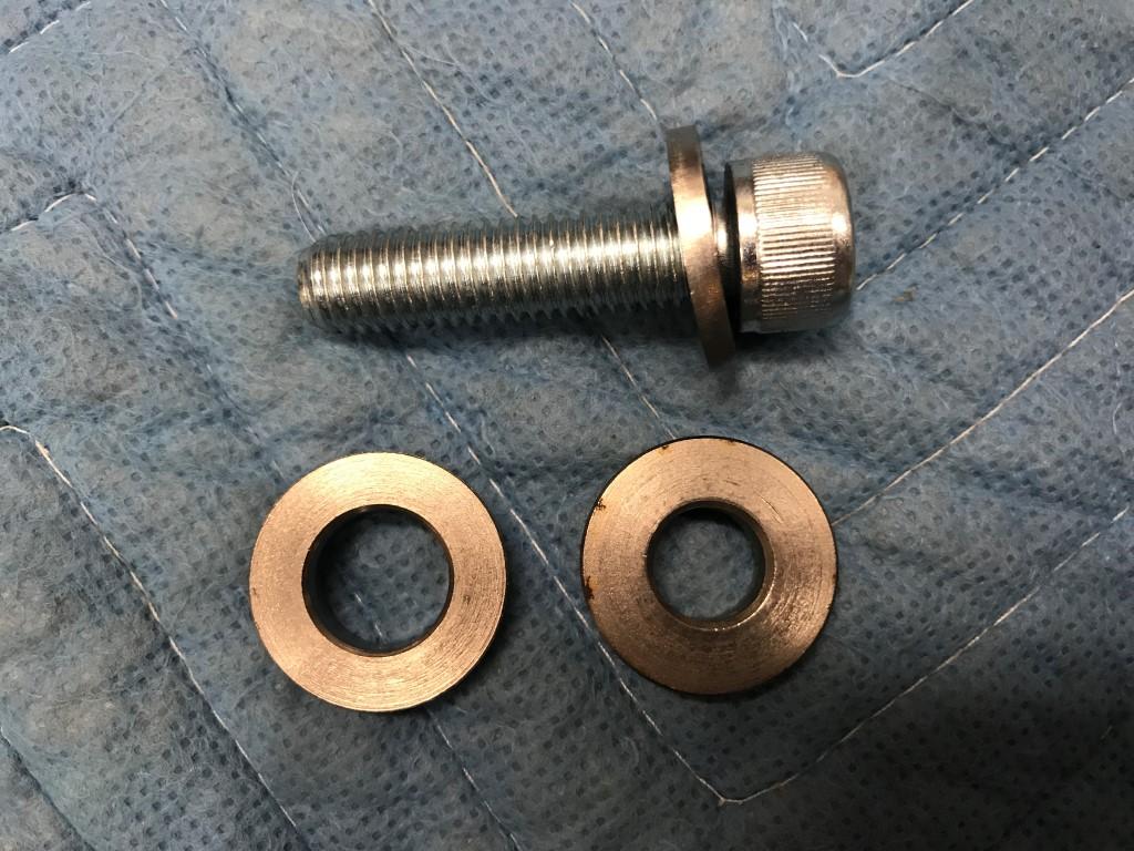

I had same issue, seems to be the slop between the bolt and the spacer that causes the issue. I tried to center as best as possible and tightened it. So far i have not had any issue related to the new tensioner. My belt chirp did return after the tensioner replacement and Whipple ended up sending out replacement stands for the idler plate. I just performed that install last weekend and I have been chirp free since....Finally got around to installing the new tensioner tonight and my idler pulley seems sloppy and moves around a lot with the supplied bolt before fully tighten. Anyone else notice this? Should I try to center it or push to the inside before I tighten the alien bolt?
