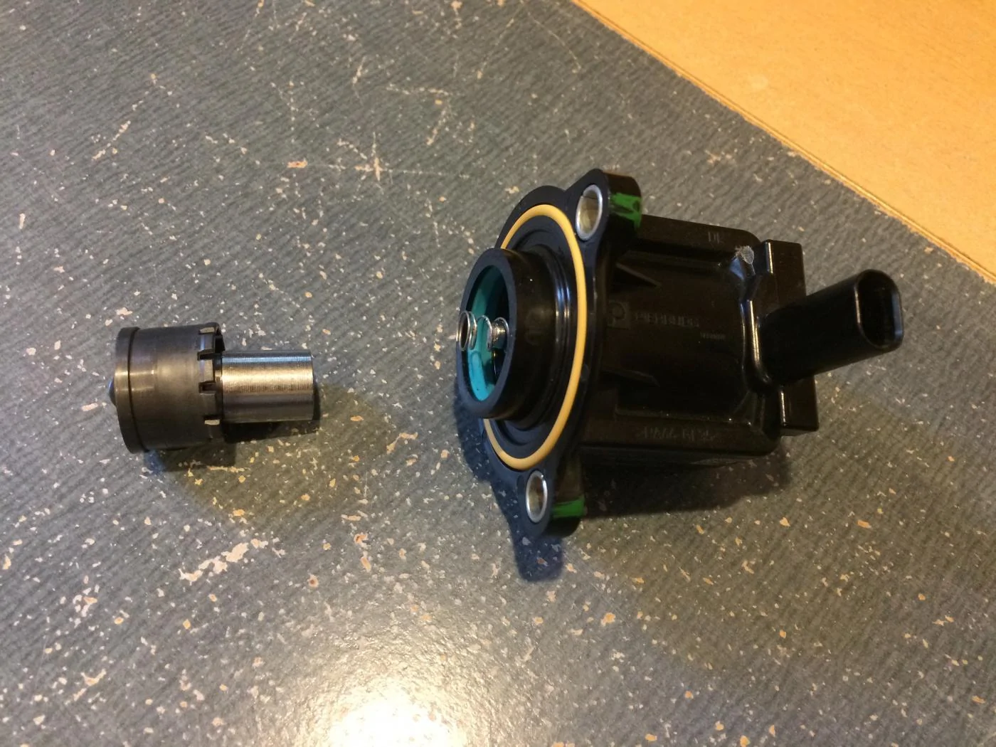

So wait are you saying the DV+ is better then the Boomba's product ?I've currently got a Boomba Full Recirc Bypass Valve kit on my 2016 EB so I have my stock diverter valve out.
Looking at it and the video on how to disassemble, mine looks a bit different and I don't see how it comes apart, at least ways not how they show it. Don't want to break the thing as I'm sure it is not cheap to replace.
jrock ... your car is a '16 too, so I'd guess if you got yours apart then mine should be the same. Any trick to get stock diverter valve apart that is different from video ??
Not too pleased to find this much cheaper option after buying & installing the Boomba, that is ...
* simpler to install
* simpler to return to stock
* boost assists in holding it shut (same)
* quicker performance due to it being direct acting (vs. Boomba vacuum open & boost closed via a 3-way solenoid)
