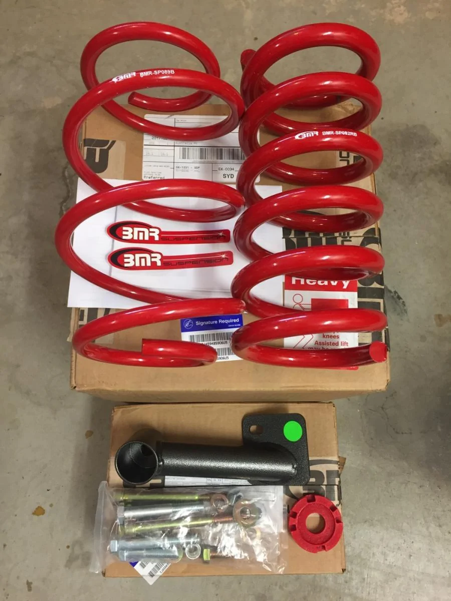

BMR SP089 / SP082 Springs
BMR CB005 Cradle Bushing Lockout Kit
Ford Performance Jounce Bumper
Steeda IRS Subframe Alignment Kit
Imported direct from BMR. Great to deal with.
(BMR BK051 Diff Bushing not installed at this stage)

Probably best you leave the diff bush until last anyways. I found no real issues with any of te parts I put in but the Steeda diff bushes were a step too far.
Pretty sure the BMR are slightly firmer again.
Best of luck with it :thumbsup:

Thanks Burkey. :cheers:
After feedback from this forum I decided to hold off on the diff bushings.
I new the other parts I installed wouldn't add any NVH, and I'm happy to report they don't. :)
