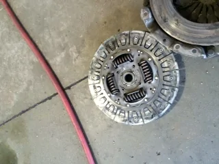

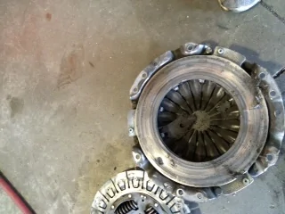

I'll add mine to the list, let go the exact same way about two weeks ago @ 35k. Time for upgrades.So this is how it basically went down.
3 days ago its in the shop: Service Rep "So we found clutch fibers in your clutch which means worn clutch and since Ford doesn't cover worn parts warranty won't be applied and it will be 1500 out of pocket" I argue with the fact that how do they even know its the clutch fault and ask how much it would cost to do a diagnosis.
2 days ago: Service rep calls back and tells me it will be 500 dollars to do the diagnosis. I get ford involved and open up a case with them to make sure they have everything documented as well. They tell me the only way we can find out what the problem is, is if they go ahead with the diagnosis. I authorize it.
Today: Service rep tells me its a worn clutch. I couldn't go see it in person so I request pictures to be sent to me. He tells me its worn so ford warranty will not cover it. I don't understand how driving normally would cause this much destruction to the clutch. Tomorrow I will talk to him in person but as of now he is not budging. Even called ford to see if they could do anything, and basically all they said was whatever the technician who diagnosed it says goes.
So this is where I am at right now. Ford will not warranty it.

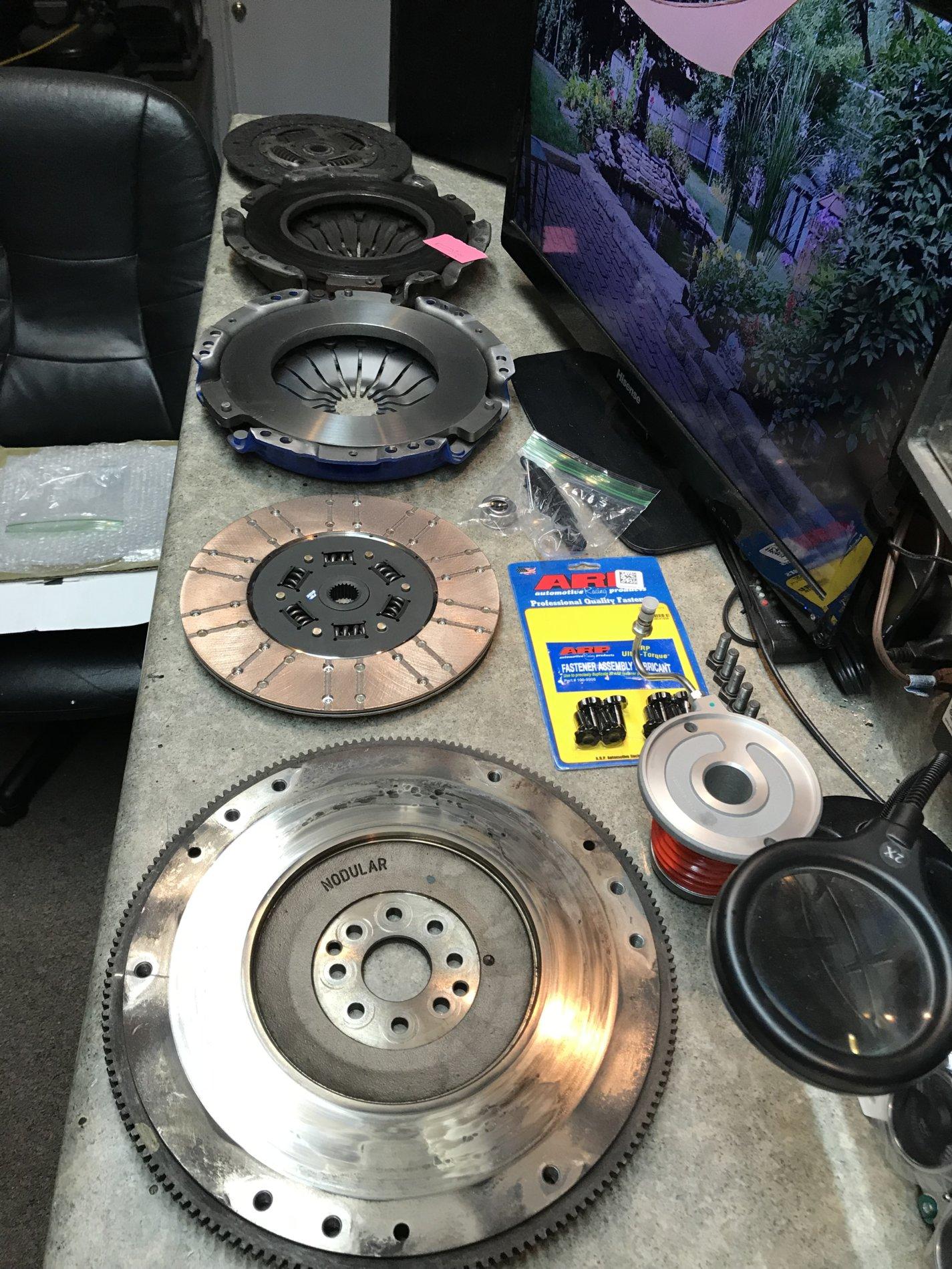

I was told that my shifting points are too high for everyday driving normally shifting between 4k and 5k rpms possibly superheatimg the clutch. After I install the Exedy Mach 500 and new oem flywheel I suppose I will correct my shift points.Add me to the list. Mine let go at 39k though. I thought it was mostly due to the fact that I have the roush 727 supercharger on it. Wen`t with the Spec stage 3+ in hopes it could hold the power. All good so far after 3k mile on it.

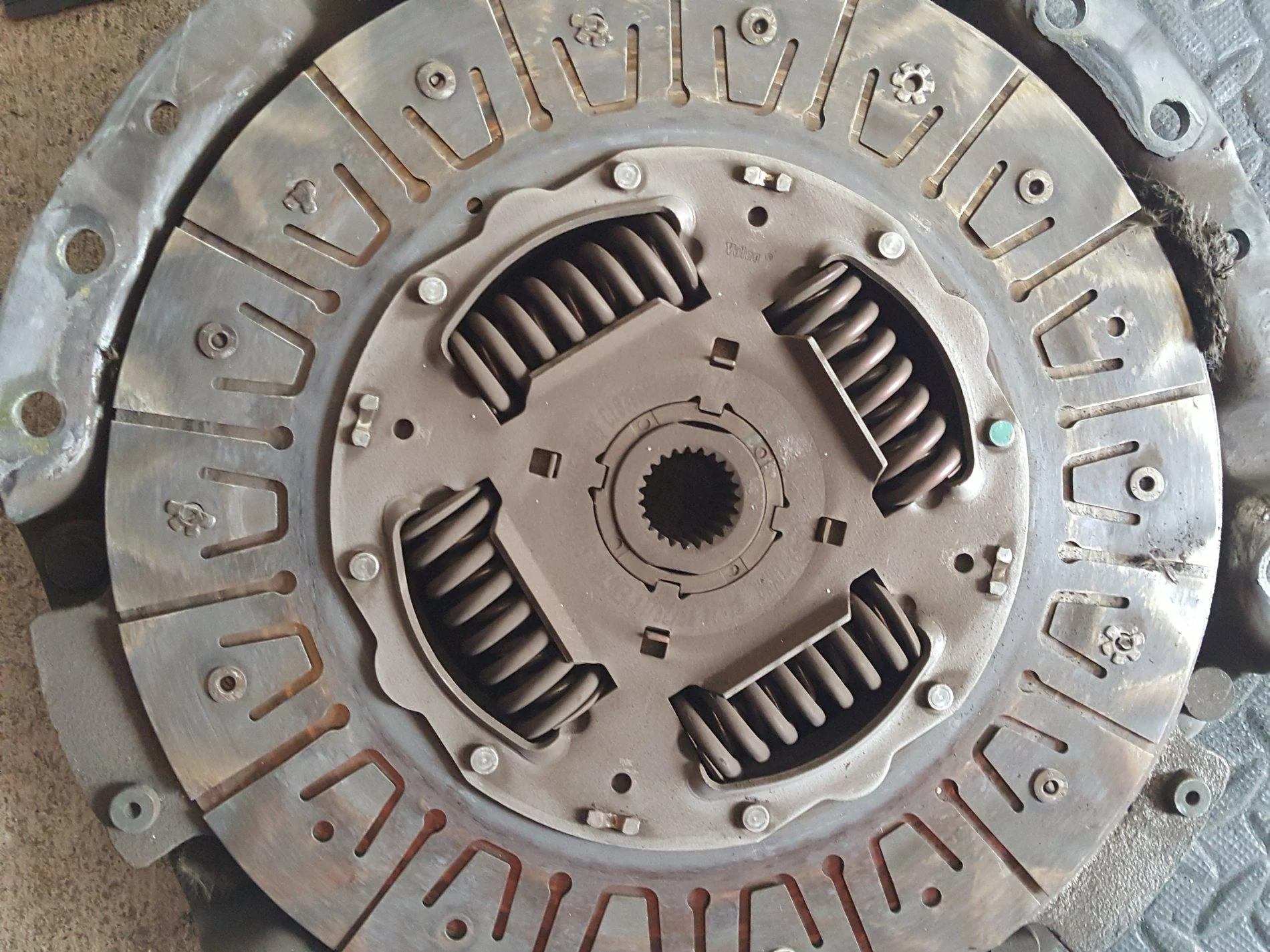

In the pic only one side was gone. The flywheel side was still intact
