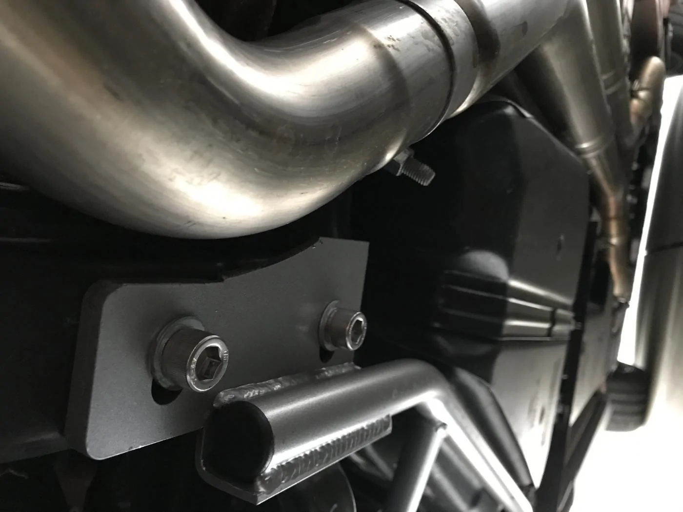

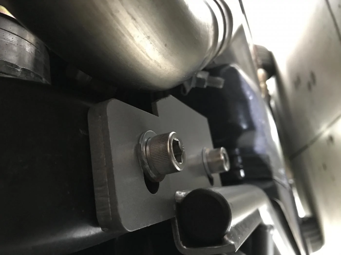

I recently got some false knock also on E85. I think there were two factors. 1. the car wheel hopped on a run. 2. after the wheel hop I believe where the braces mount was close to the exhaust and hitting. I trimmed the braces and no false knock on the street. I haven't been back to the track yet.....
Nice job looks good
