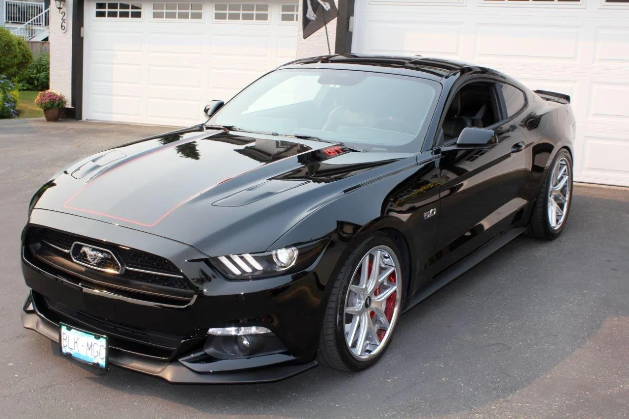

I used the CQuartz UK, formulated for wetter climates. Am over the top happy with the results! It's a Ceramic Coating that ones to the clear coat to create a Glass finish! On Black it's incredible!! No swirls, light scratches just shine. reload kicks up the deep shine another notch after using! Hydrophobic! Did the wheels as well, hose off brake dust! Bird crap wont stick to it!!
Check it out.....after my paint correction including some light 3000 grit wet sanding !!
