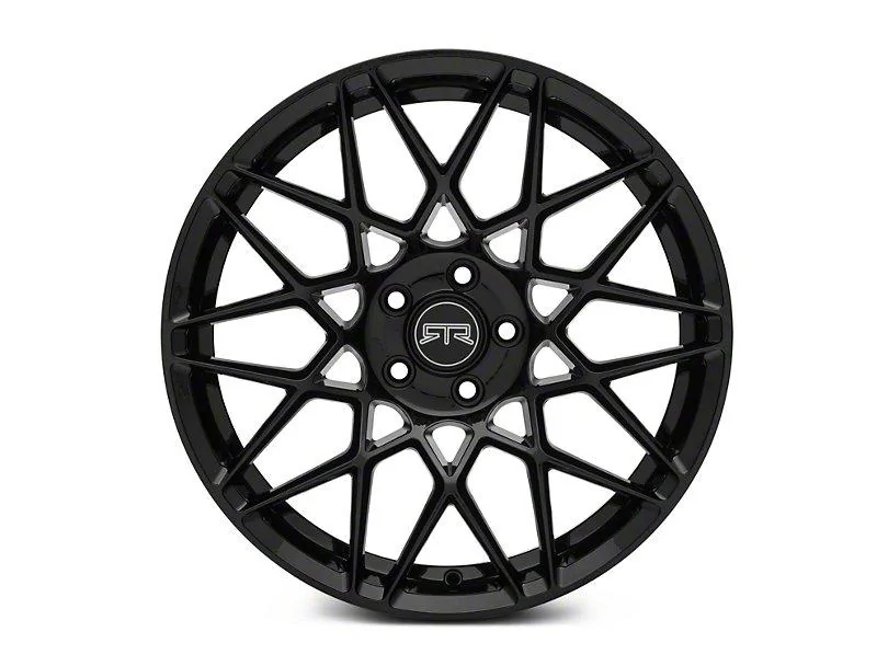

New RTR Wheel
The New RTR Tech Mesh!...has anyone seen this installed?

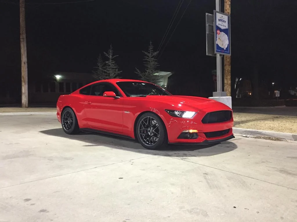

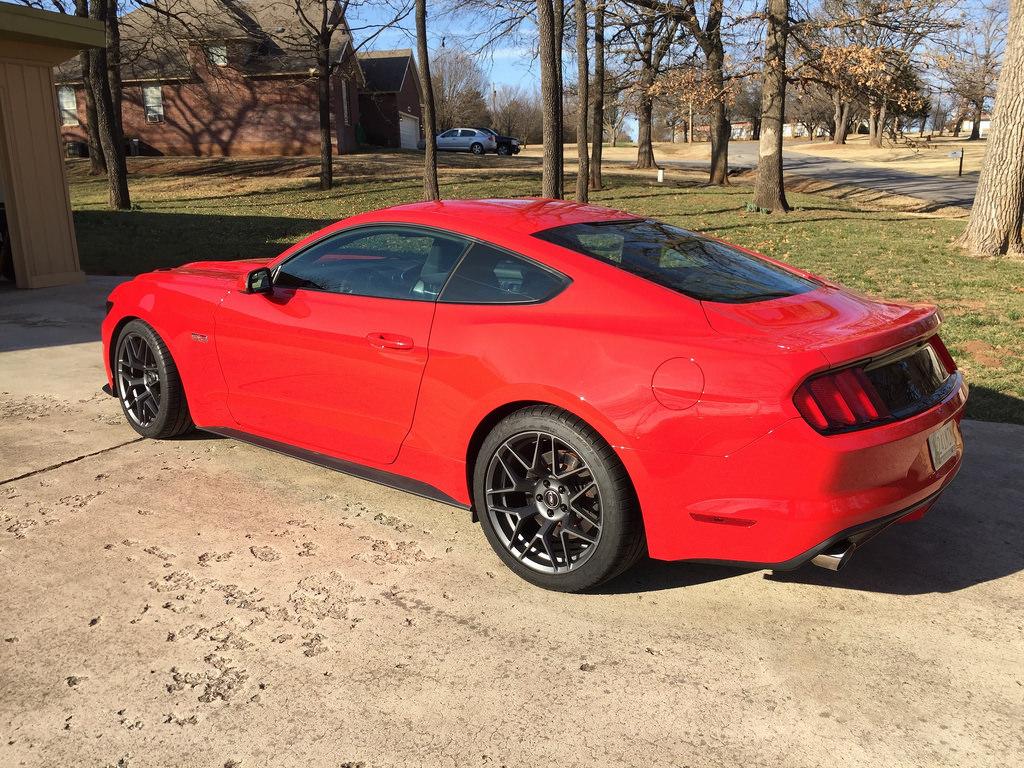

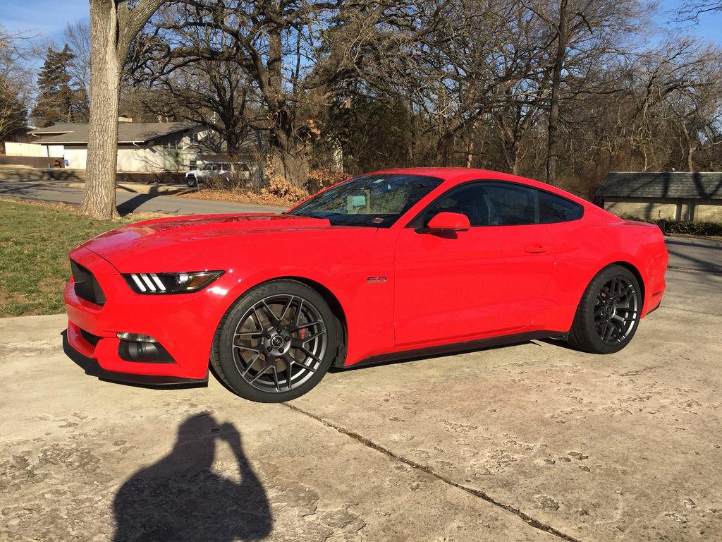

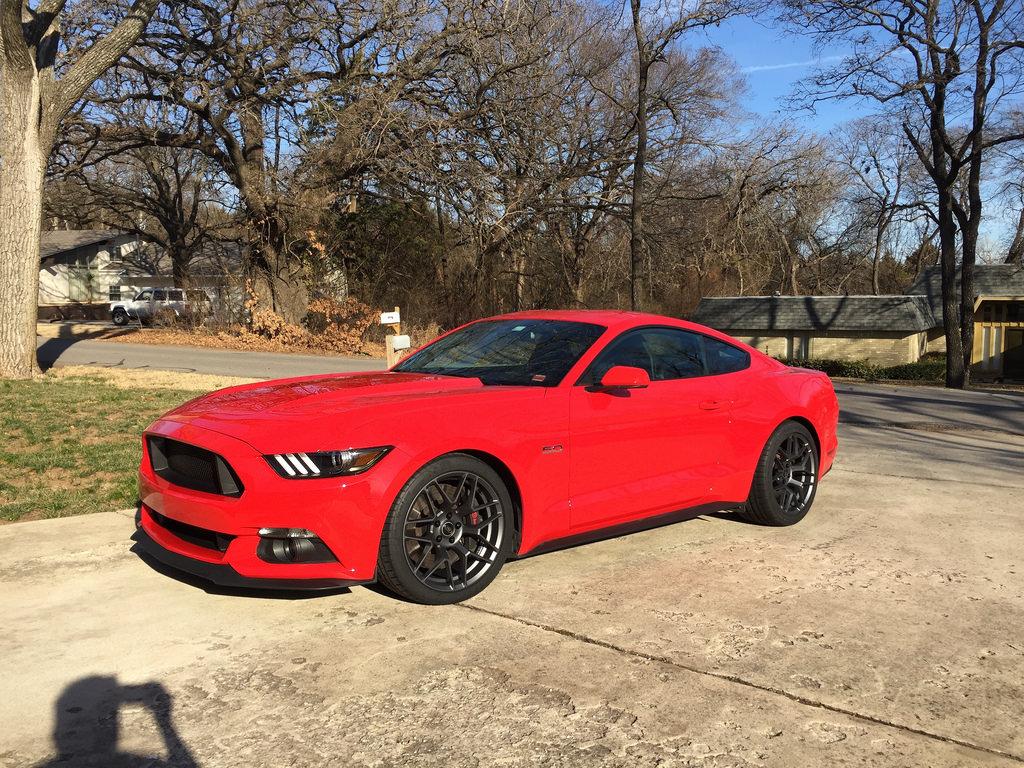

what brand lowering springs?
what brand of lug nuts?
I think it's BMR - from his signature block - minimal front drop and performance rear if I read correctly - I also want to know if he's got camber bolts, or was able to get things aligned okay without anything else - this is looking a lot like what I want to go with.

Yes it is BMR performance springs. SP089 up front which is the performance srings but minimum drop up front. So roughly a 3/4 inch drop up front.
Rear is the regular BMR performance springs.Which sold by themselves is the SP082. It is roughly a 1/2 inch drop in the rear.
The BMR performance springs spring rate match closely to the factory performance pack spring rate.
I do not have camber bolts. I was able to obtain the performance pack alignment spec with these springs and factory camber bolts.

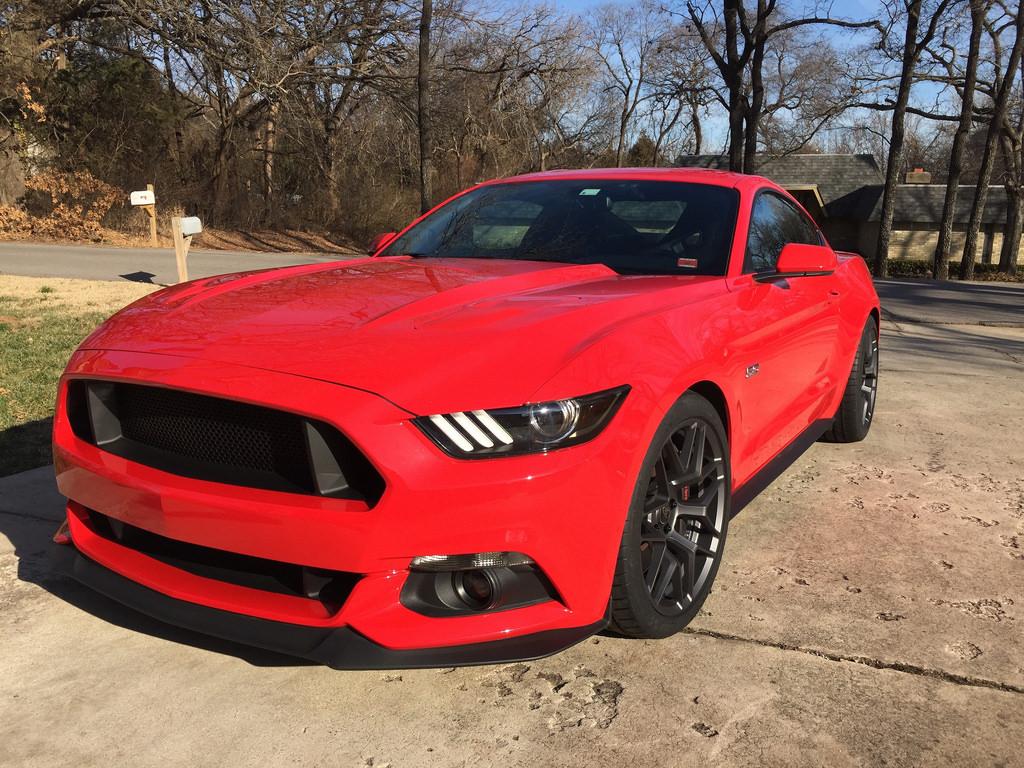

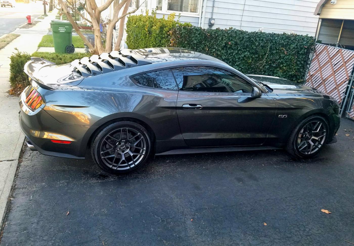

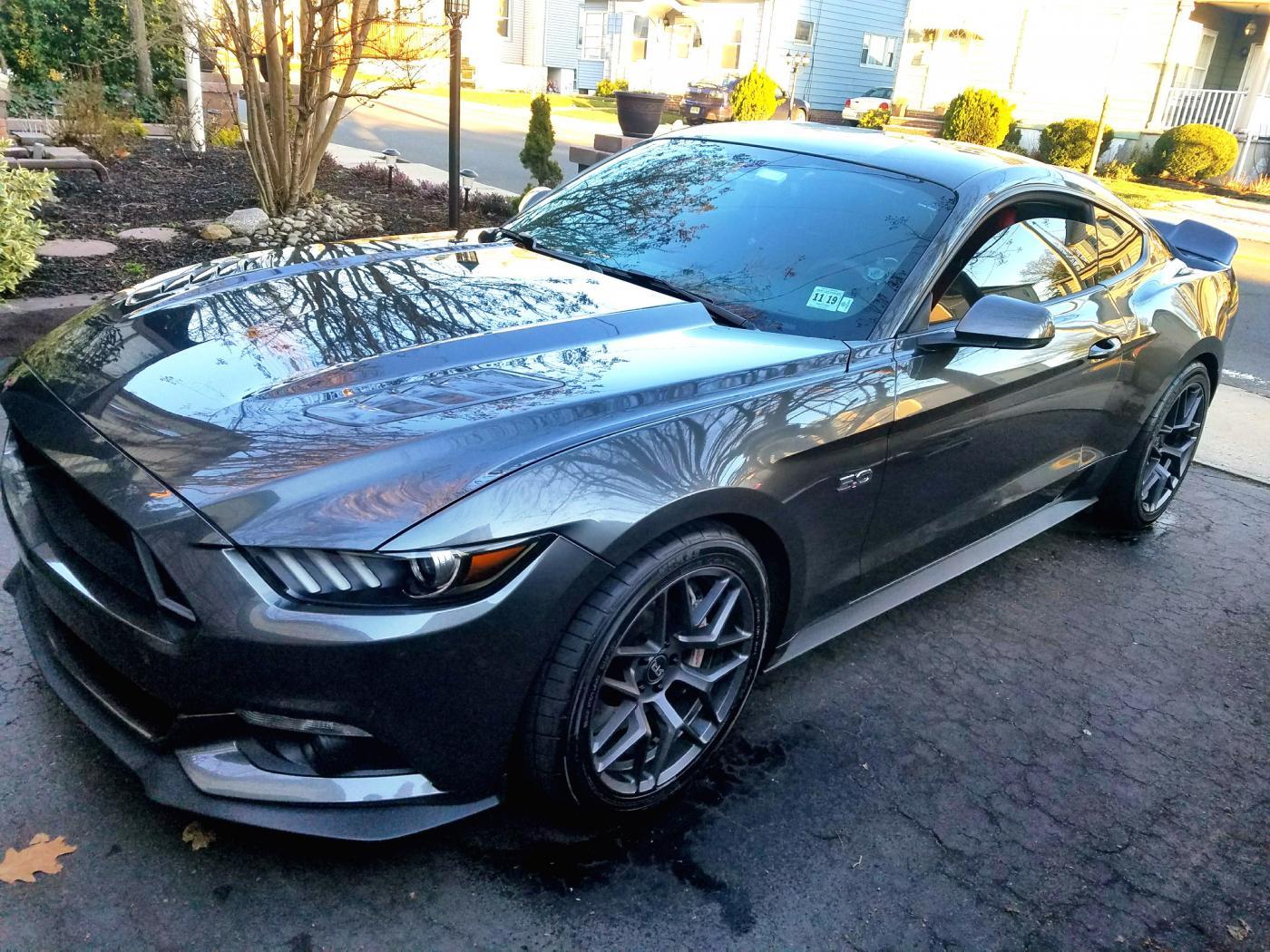

Installed today 19x9.5 275 40 square

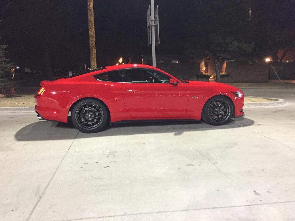

Thanks fellas..ill take a side shot and post tomorrow for ya

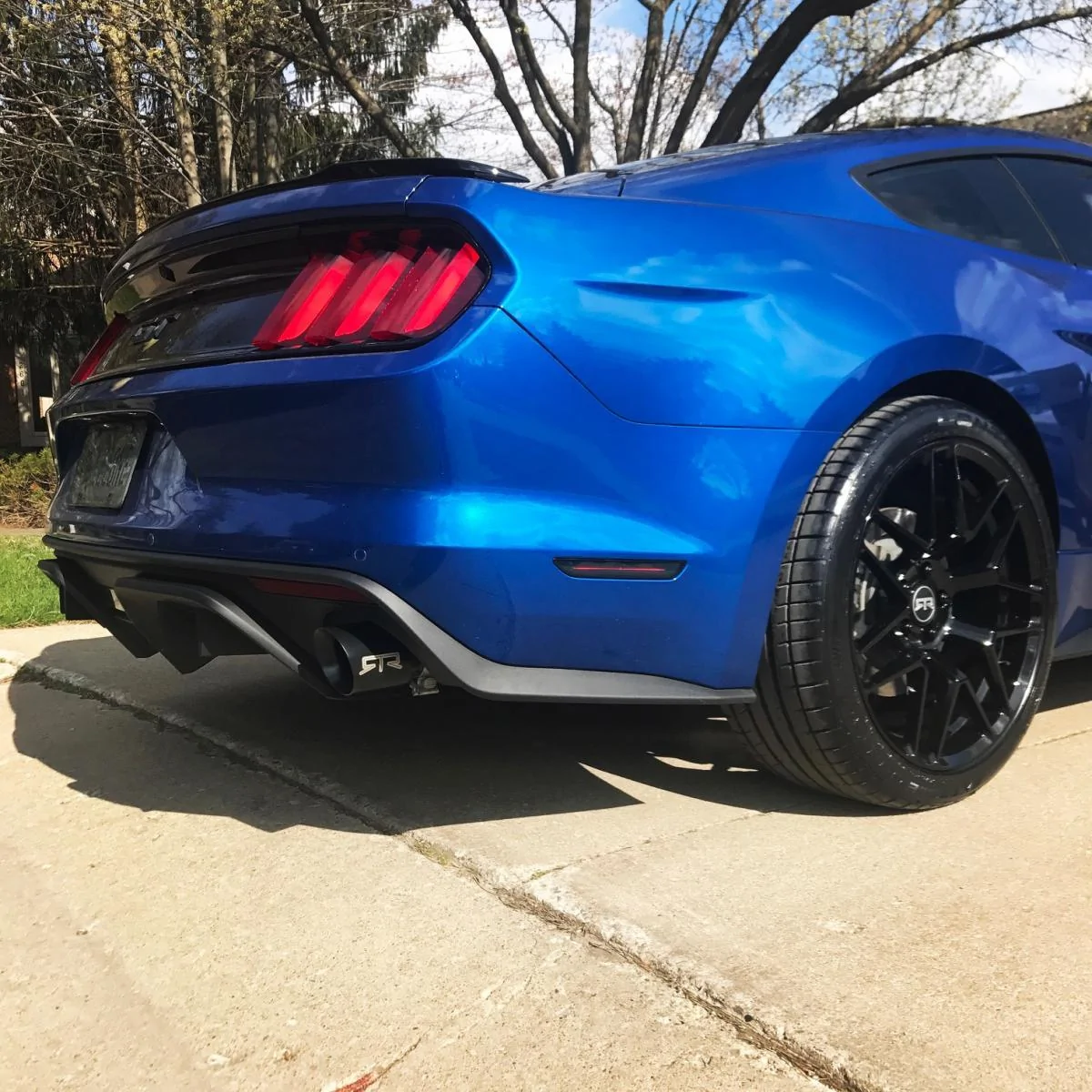

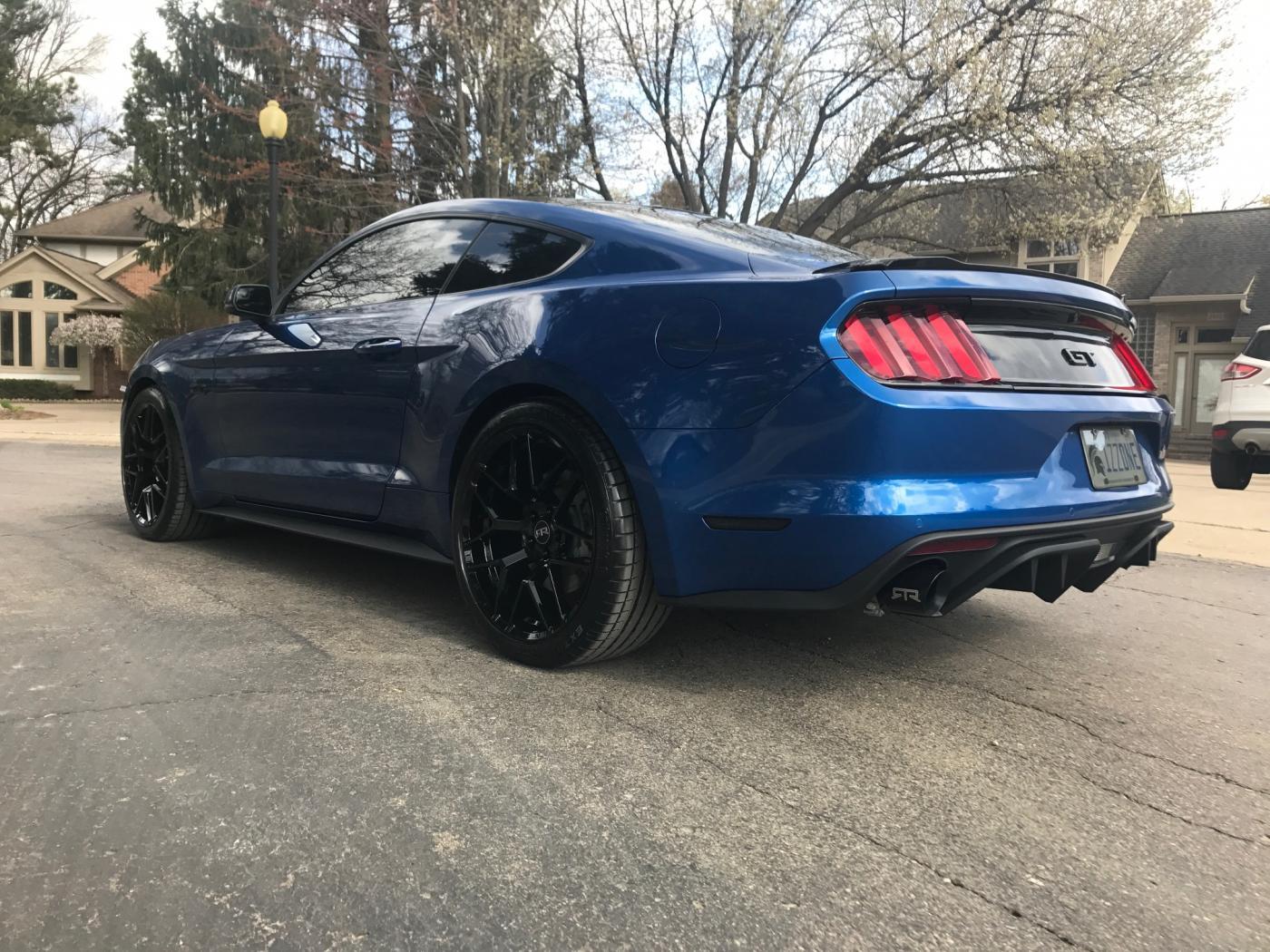

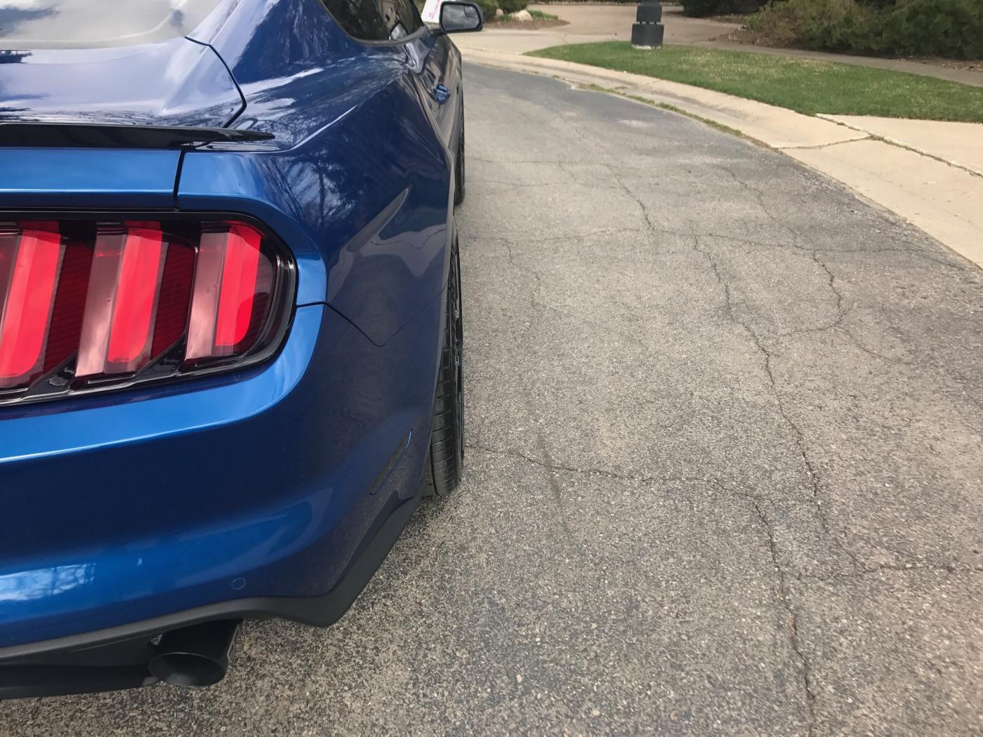

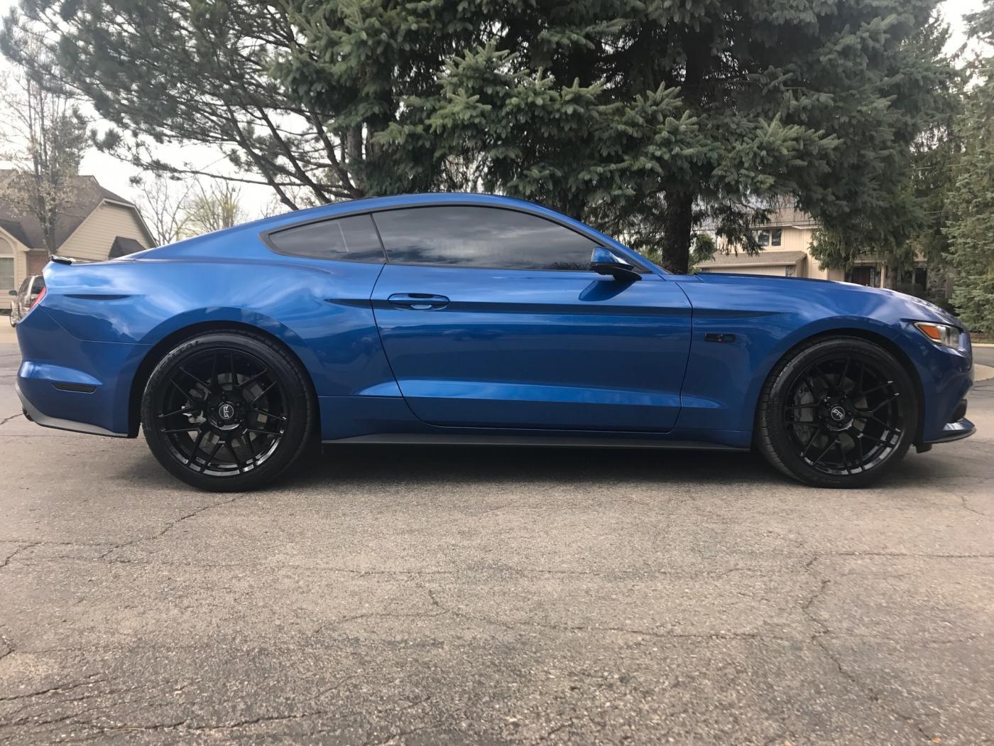

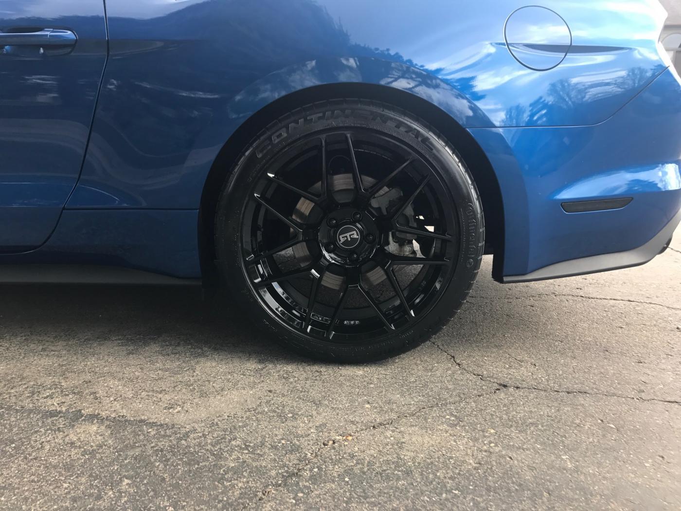

Did some installs yesterday.
RTR Tech 7s 20x9.5 with Conti DW 275/35ZR-20
RTR Competition Spec Exhaust
RTR Diffuser
I have a set of Eibach Pro-Kit springs in my garage, but I don't have the time to put them on just yet.
